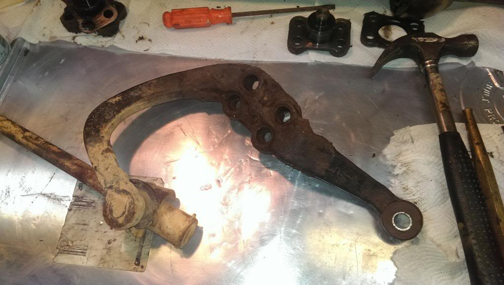

So I bought this axle off craigslist about 3 years ago. Its been sitting in my basement all this time and I've just gotten the motivation to tear it down to rebuild it.
This is a total noob project for me as I'm learning as I'm going. Watching a lot of youtube videos, 4crawler, and any how-to I can find.
But during my searches I've noticed my steering arm and knuckles look a lot different than what I've been seeing. It's suppose to be the axle out of early 80's truck, but can anyone confirm that?
This is the steering arm that bolts to the top of the knuckle-

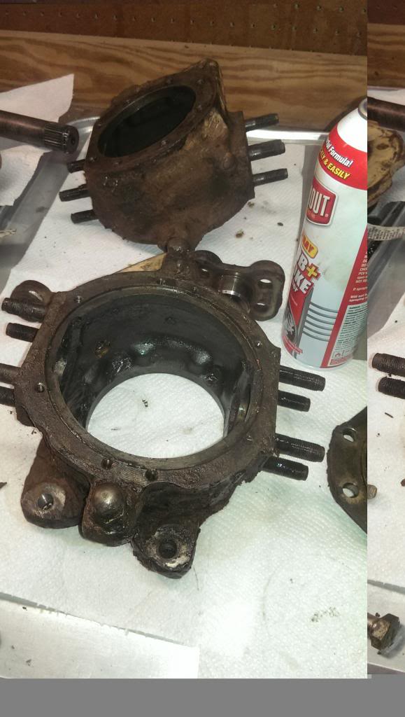

These are the knuckles-

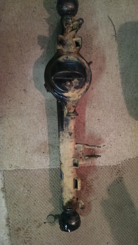

Pictures of the housing would help.

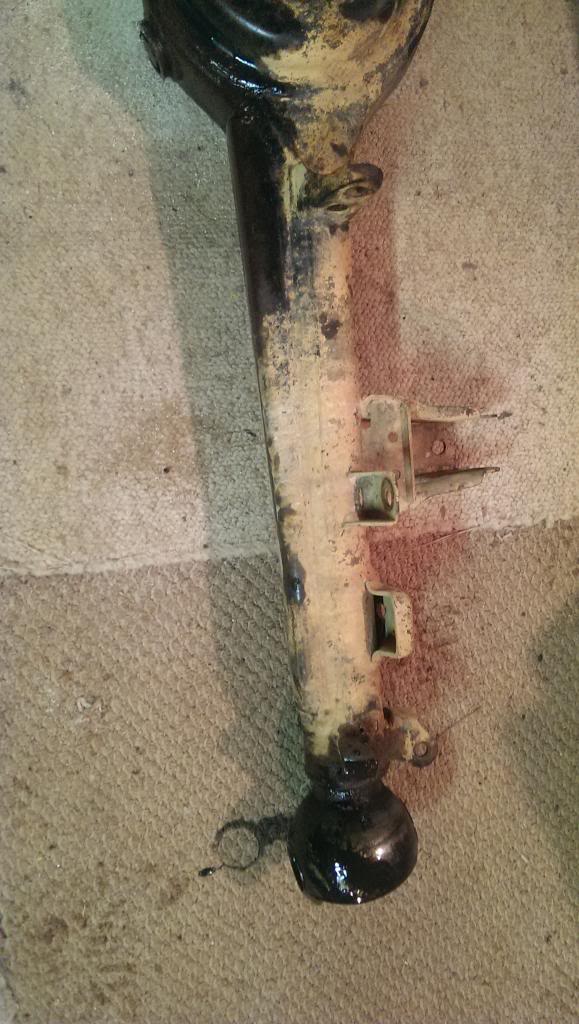

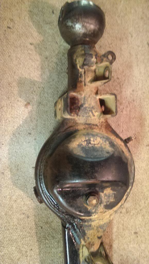

Forgive the pictures in the bucket. I just spent half an hour cleaning up, didnt want to get grease all over the place again.

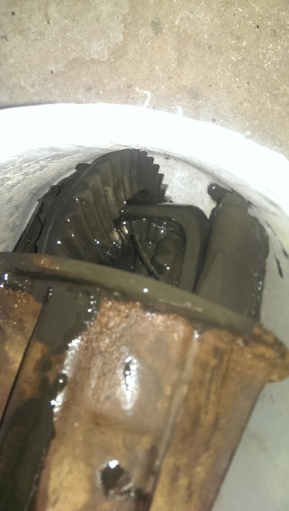

those look like the push pull steering components that are on my stock 85 4runner, and that solid axle looks identical to my 85

Looks like a truck housing…
Maybe someone will know if different knuckles will fit on the truck housing

The more I look at it the more it looks like the 85 truck axle I have lol

Ok - forgive the dumb questions but I thought the 84-85 trucks had additional gusset support?
and most of the knuckle tutorials i've seen have 2 bolts on top instead of 4.

yeah thats what that one has on it

Originally Posted by Torpedo
Ok - forgive the dumb questions but I thought the 84-85 trucks had additional gusset support? and most of the knuckle tutorials i've seen have 2 bolts on top instead of 4.
The 84-85 had the additional gusset on the bottom. It goes all the way to the spring mount.
The 4 bolts on top of the knuckle are the trunnion brearings
Old Dec 9, 2013 | 05:32 PM

the long side bottom of the axle is the additional gusset support

This video sparked most of my confusion. If you skip ahead to the 2:20 point you see him take off 2 bolts on top and not the 4 that I have.
Old Dec 9, 2013 | 06:12 PM
85toy4runner's Avatar
Joined: Feb 2012
Posts: 223
thats a diff toyota axle in that video, there are 4 bolts on top and bottom of the knuckle like the ones you have . you will be using those 2 knuckles you have on your axle , you just wont be using any of the push pull steering, you will be using your IFS steering box with cross over steering
