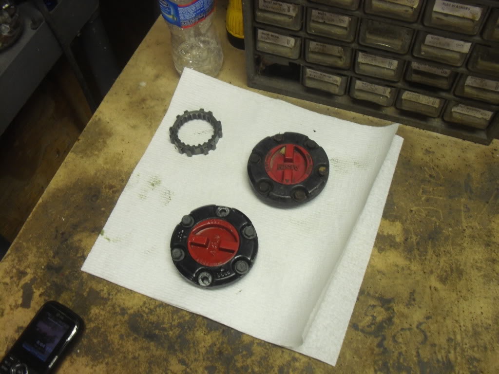

what year is your rig? 84-85 trucks have a different number of splines then 86-88 trucks.
you can identify them but the hub dials.
you can see here the solid front axle hub dials extend out past the mounting ring, as ifs hub dials sit flush with the ring.
SOLID FRONT AXLE.
Old Aug 7, 2011 | 04:01 PM
  #51
85gijunk4x4's Avatar
Joined: May 2010
Posts: 3,120
From: piney hicks nj
IFS hubs. (check out my phone background )

86-95 Trucks & 4Runners Got to assume he's IFS unless he SAS'd. P.S. The above photo is not the entire IFS hub. Just the dial.

good call xxxtreme. what you want to look for is the syle of the dial, it indicates how many splines the hubs are. i beleive ifs is 30 splines? not sure if thats right though.
