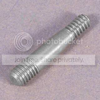

thanks a lot i was hoping i was right about it not being power do u think the antenna in the link at the top would fit it or is it something u have to see in person
Old May 27, 2010 | 07:10 PM
Ron Helmuth's Avatar
Joined: May 2007
Posts: 2,175
From: Denver metro area-CO
the stylin trucks link shows a female receptacle end on the antenna mast-you would need a male to male threaded adapter to make it work.
Should not be particularly hard to find but undo your old one first so you have a better idea what I am describing. Those billet ones look nice but as I mentioned they have no bend-ability thus they are kind of a vandal magnet. A good swift thump on them will damage the lower mount.
I would go with a black Tacoma type mast with wire wrap type of look with plenty of flexability myself but a great number of modern antennas would likely work for you.

Old May 27, 2010 | 08:11 PM
Dessa0793's Avatar
Joined: Feb 2010
Posts: 17
From: Diamond Bar, California
hey i was looking through the site and i found this and was wondering if this is wat u meant about the male 2 male adapter here's the link and a pic
