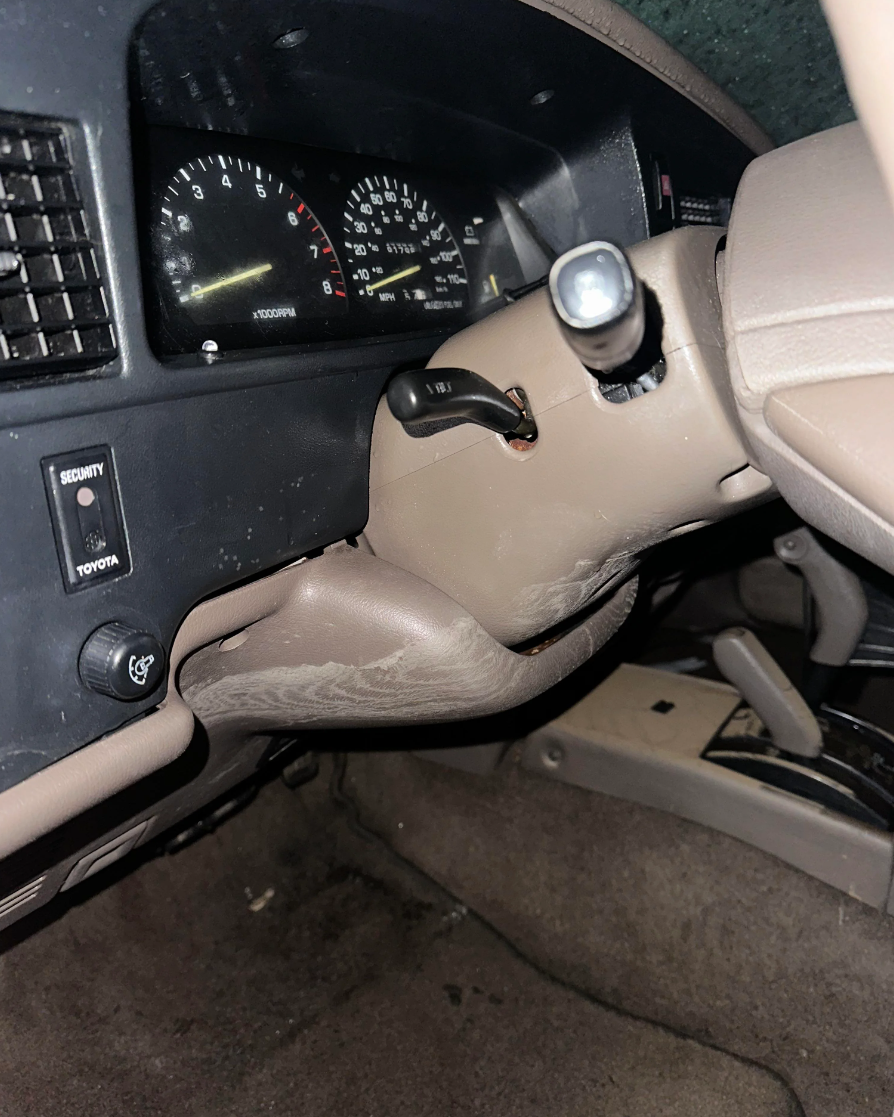

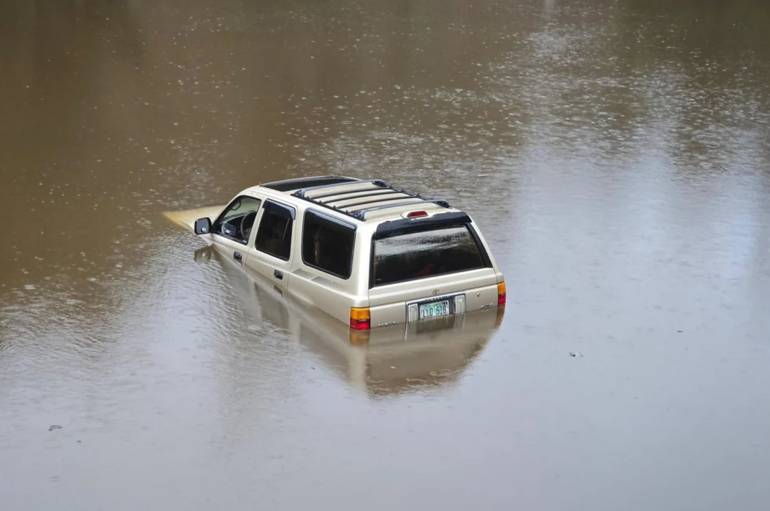

Yikes. Put the whole truck in a bag of rice. Haha. Looking at a full fluid change at the minimum. Hopefully the electronics are ok.
I would change the engine oil and see if it still runs. Then go from there.

Grim.
I've dealt with flood vehicles. It's not fun.
Pull the battery. You don't want anything getting power for awhile.
Drain engine oil and pull plugs. Blow compressed air into cylinders then add some ATF to coat cylinder walls and turn engine over by hand.
You'll need to pull the interior. Seats, carpets, and possibly interior trim panels if water got behind them. Then put fans inside to move air. Hang the carpet, the backing takes a long time to dry out.
But obviously the biggest concern is electrical.
Water has dissolved minerals and salts. This will be your biggest enemy over the long run. Even after something dries those minerals stay behind, and they cause issues down the road. You need to open every electrical component that got submerged and flush with distilled water, use a soft paint brush or toothbrush gently to help break anything loose. then let it dry thoroughly.The ECU will be the major one, but all the various electrical components that got wet will need similar treatment. It's ok to get circuit boards wet, just not when they have power. That would be bad.
Same with connectors. Clean, then allow to dry. A bit of di-electric grease would be a good idea when reinstalling.
lastly, You'll have to change every fluid on the vehicle; engine oil, trans, transfer, diffs.
I saw a lot of vehicles that were flooded, and brought back to life, but only to be a constant problem. They were easy to spot, they typically had something green growing on the electrical, especially at connections. Insurance companies got tired of the on-going costs of flood vehicles (typically electrical) and made a rule that if the ECU got wet then the vehicle was totalled. So you can see why diligent cleaning is needed.
