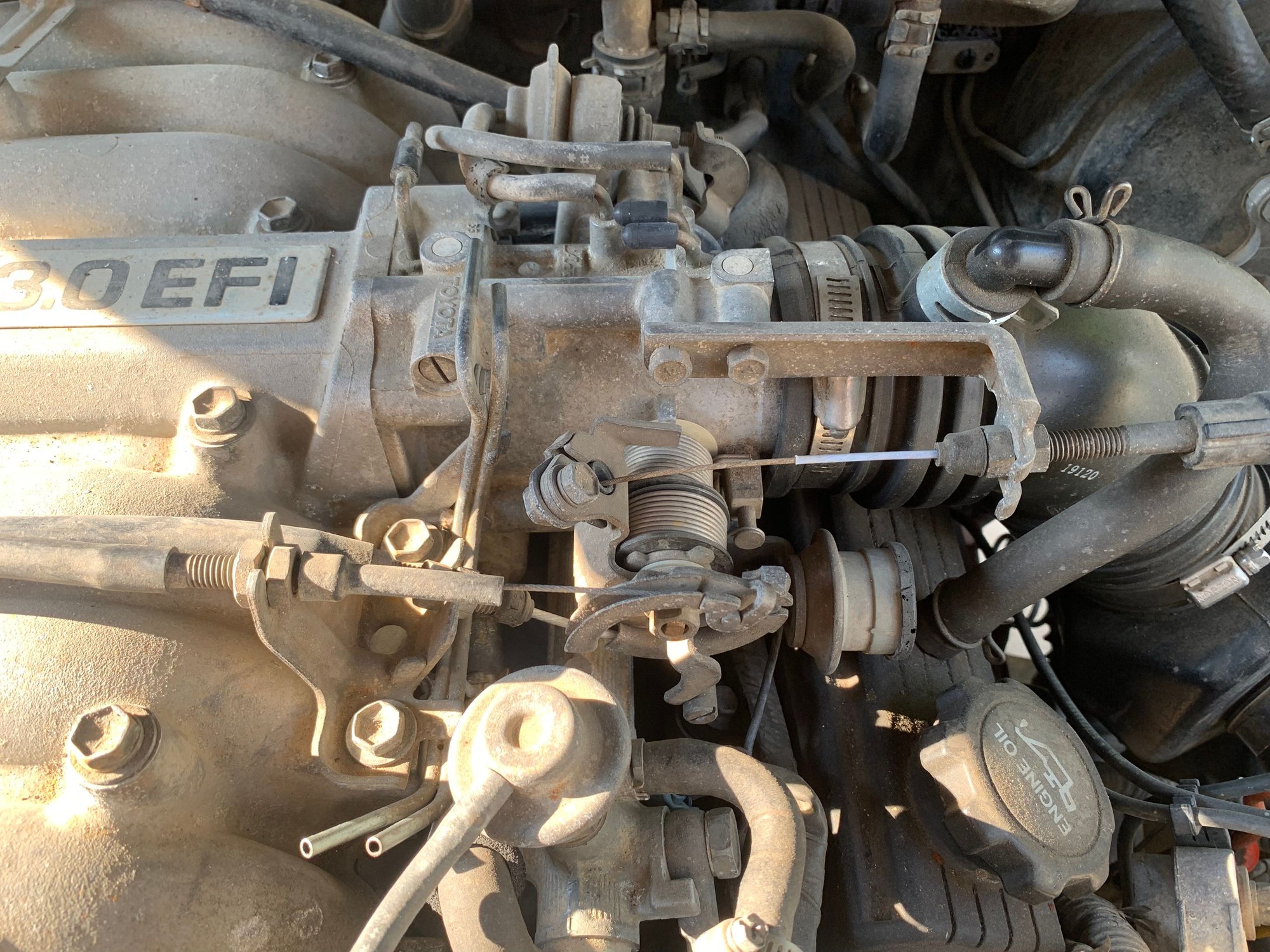

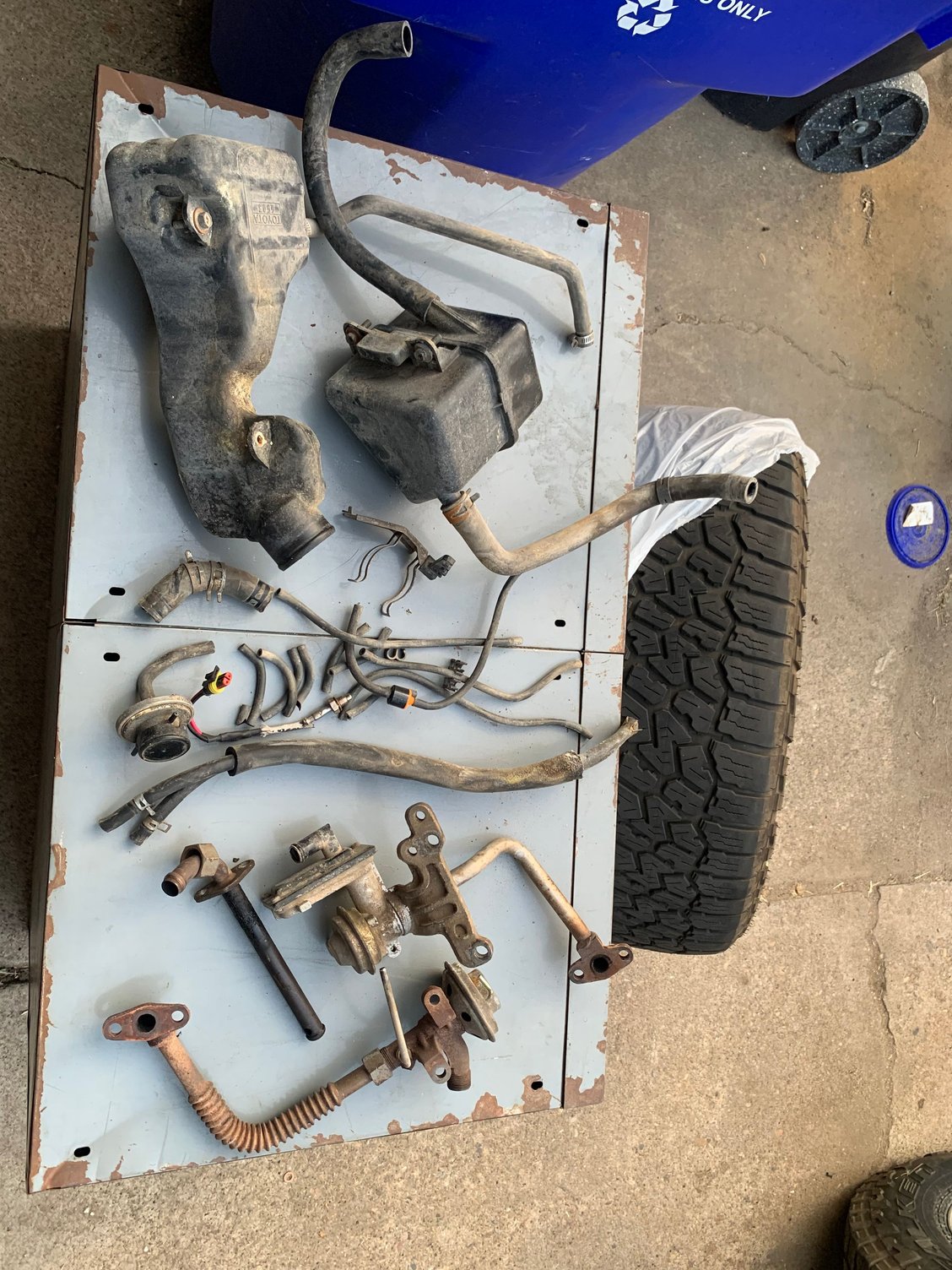

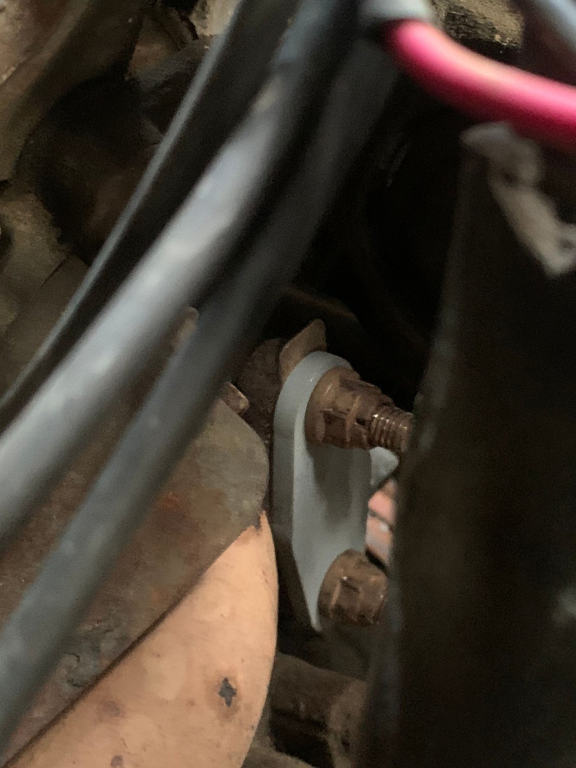

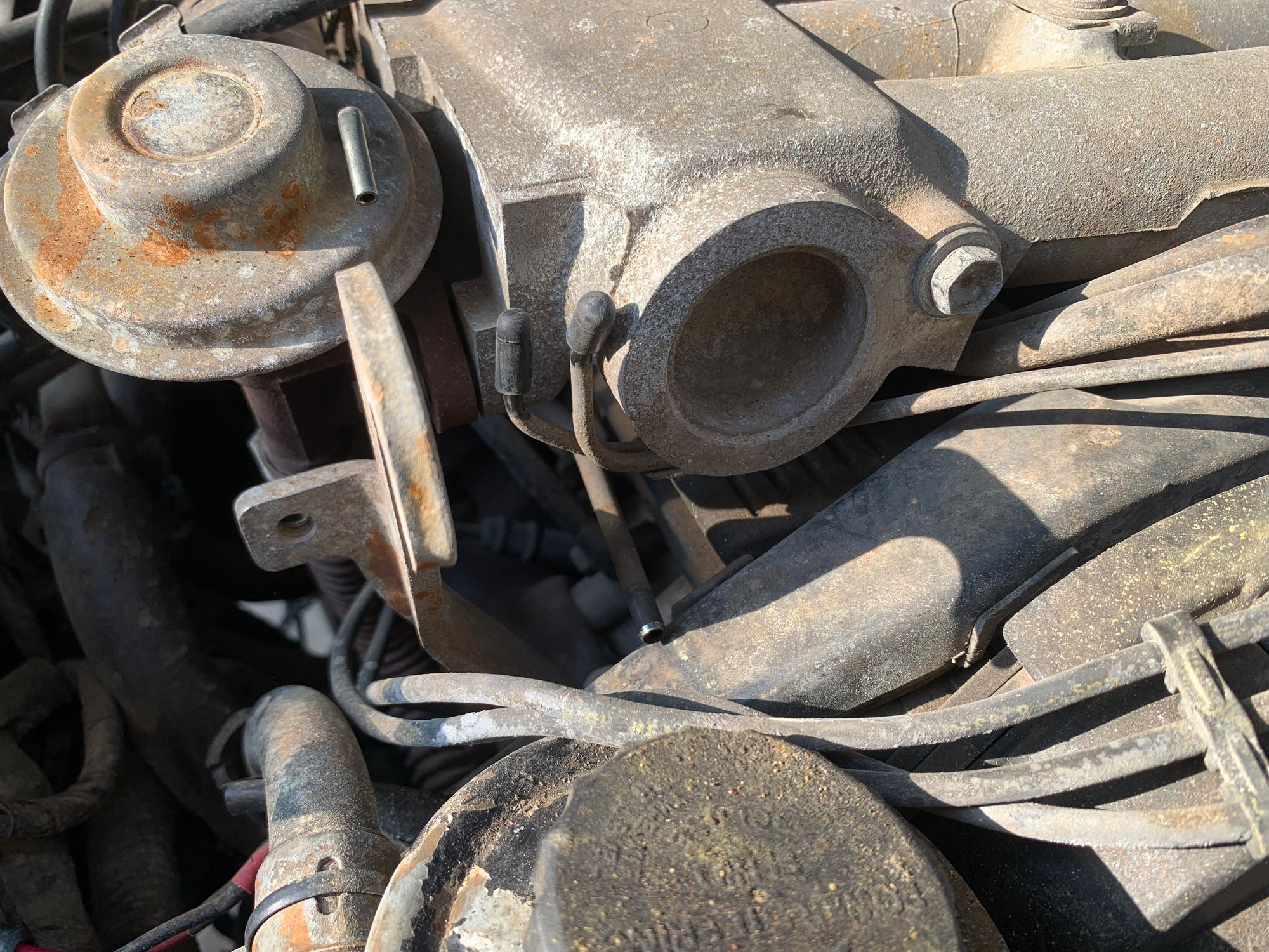

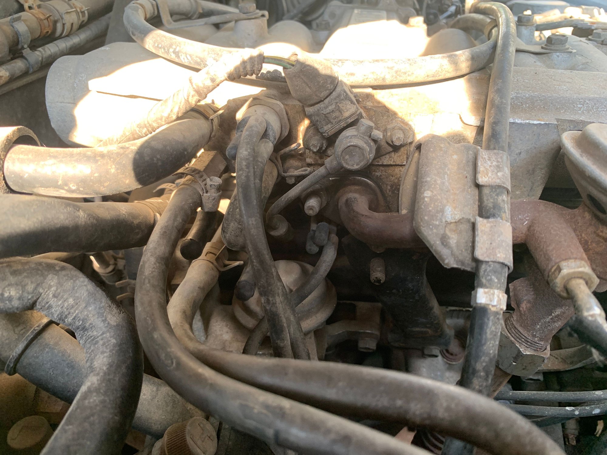

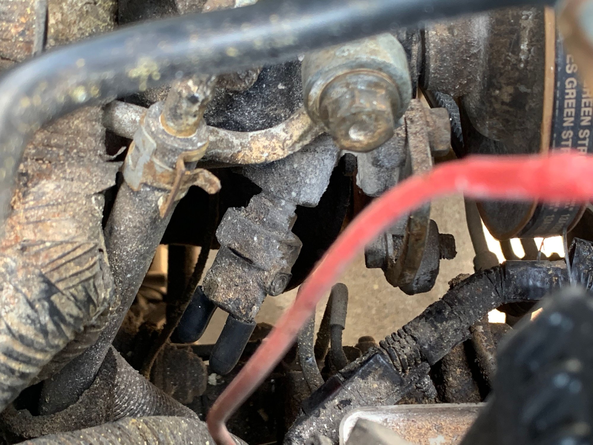

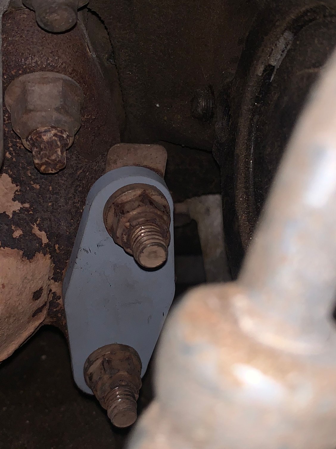

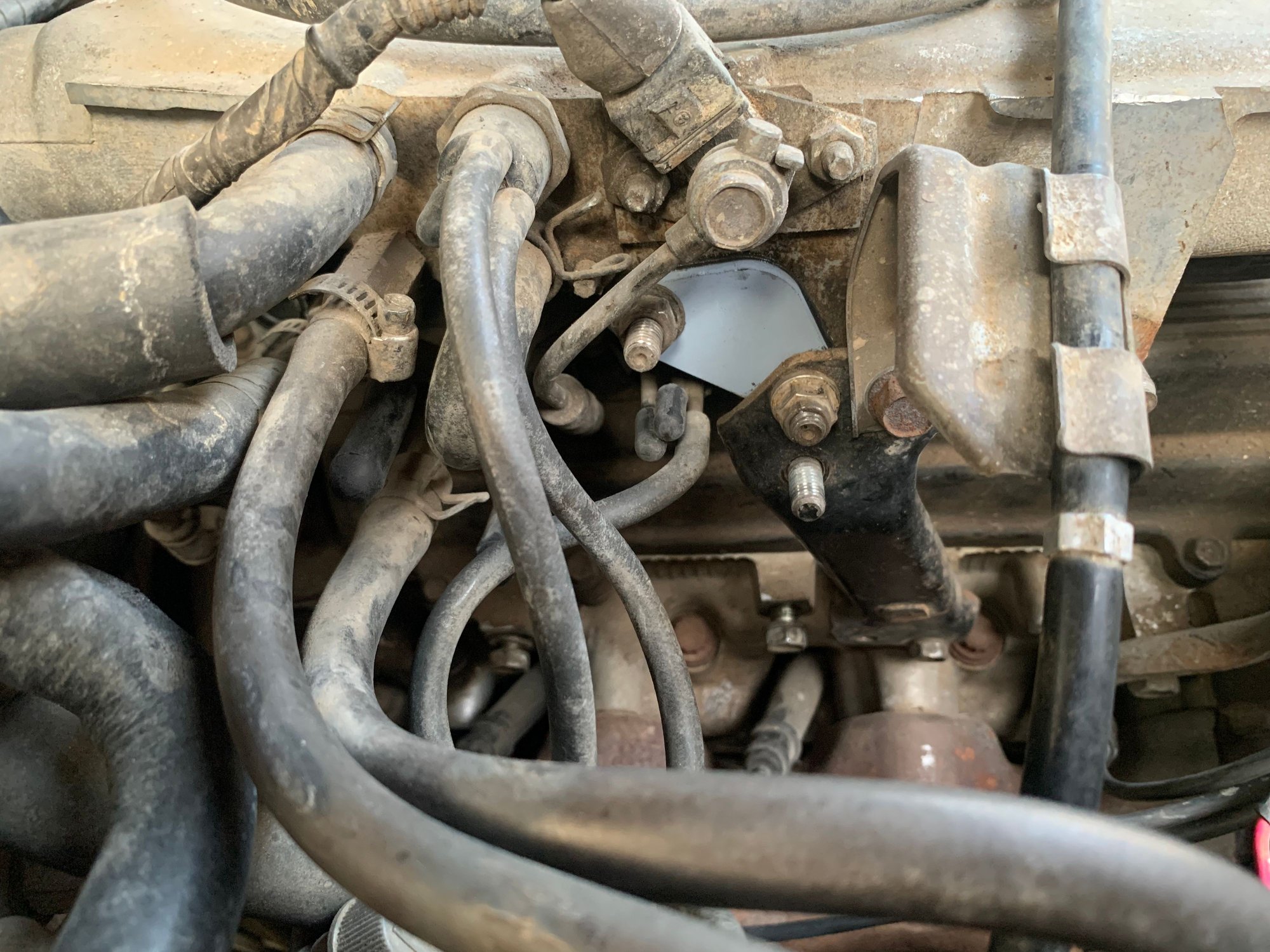

I’ve been fixing up my automatic 1995 4runner with the 3.0 in it. I ran into an issue a while back where if the egr was plugged in, the cel would come on and the O/D OFF light would stay on full time, not blinking and not able to turn the od on with the shifter button, the idle was steady and it would rev, but it would barely move forward unless the shifter was in low. However, if the egr was unplugged the cel and O/D OFF light would both go off and O/D would function properly with the shifter button and it would drive normally, but the idle was low and surging. Two days ago I unhooked all the vacuum lines to the egr and capped them, cel light came on, but it idled good and would move. Yesterday I deleted the egr and now I have the cel and O/D OFF light on full time, and it will barely move unless in low gear, and it idles fine. I’m thinking shift solenoids, or an electrical issue. If anyone has insight that would be super helpful!
these are the pics of everything I capped off and everything I removed
