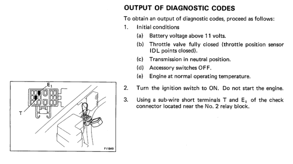

Okay, I checked, and the connector's definitely not there. i'm beginning to think the cut wires are the diagnostics. ARGH.
From the FSM:
That whole box/plastic piece is MIA on my truck. Anyone know which wires are the T and E1 by color code?

E1 is brown
T is Green /yellow stripe
Hope that helps

wyoming9 -- thanks! I was checking the FSM (the one available for download throughout the net) and didn't see color codes.
