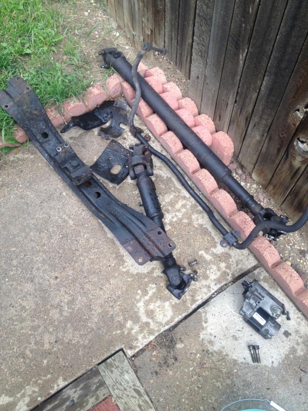

So I pulled a bunch of parts..
dropped the transmission..

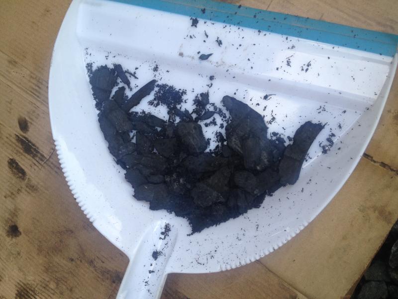

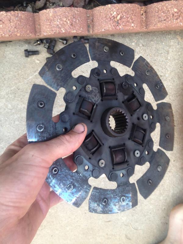

and found this..
is that bad?? j/p
yeah, I'm going to say to problem was the clutch
Old Aug 10, 2014 | 06:57 AM
  #32
wyoming9's Avatar
Posts: 13,381
Likes: 100
Red face
I think you got real lucky on that one You need to build your good Karma back up .
How bad is the fly wheel??
Old Aug 10, 2014 | 07:00 AM
  #33
rworegon's Avatar
Joined: Nov 2010
Posts: 5,125
That clutch disc looks a little, ummm, naked.

Update:
It was definitely a clutch issue. After researching, it sounds exactly like "catastrophic clutch overspin." Basically going DOWNHILL in 4lo in 1st gear with the clutch pedal depressed, you can spin the clutch plate at like 15k rpms while only doing about 5mph. I spun the clutch disk right off the rivets! That's why it came out in big chunks like you see in the above picture.
