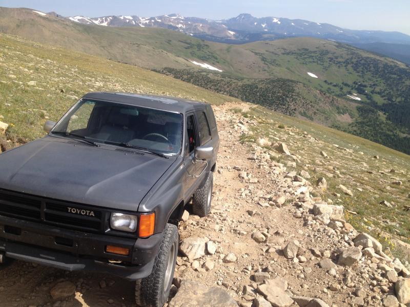

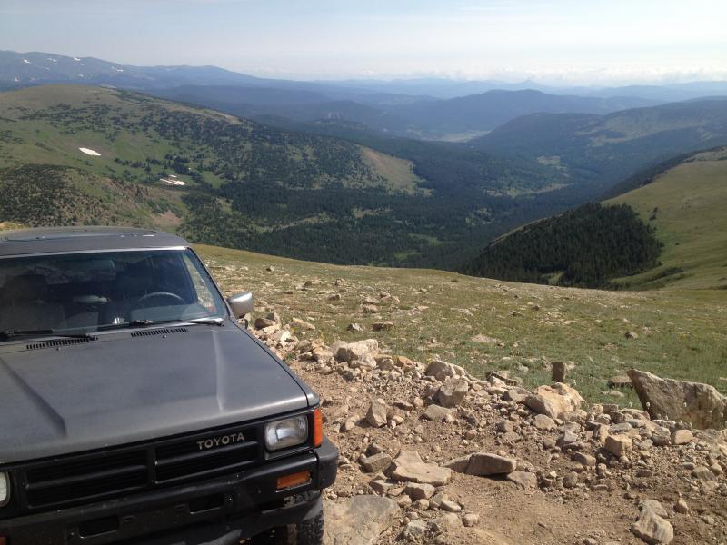

I really don't know exactly when it happened. I made it over the pass and then on the way down the other side, I thought I heard a pop and thought "that ain't good" but she kept driving fine. I stopped, snapped some photos..

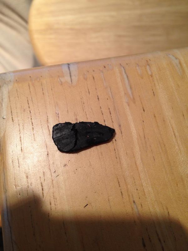

also found this piece...

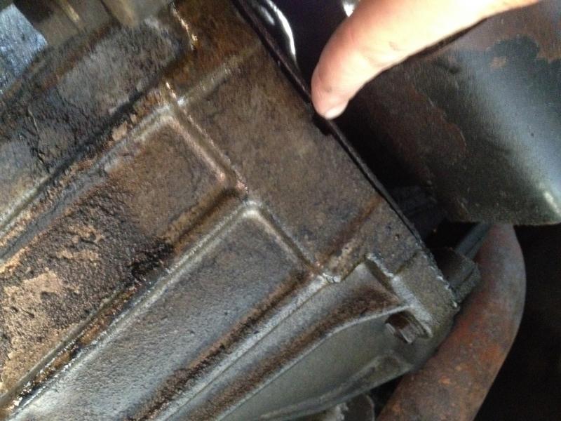

sticking out of this hole..
Not sure if that has anything to do with it. I've never replaced a clutch or transmission.

What is that piece? Dirt? Metal? Where your pointing is the bell housing where the clutch is

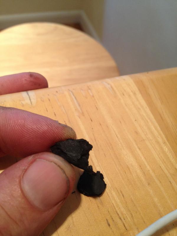

Definitely not dirt. Looks almost like a piece of brake pad so maybe a chunk of clutch? Came out in one big piece but I broke it in half..

Old Jul 27, 2014 | 05:23 PM
JasonYota's Avatar
Joined: Mar 2013
Posts: 2,121
From: Mobile, Alabama
Originally Posted by millball
I'm still thinkin clutch disc.
Ding ding!!
