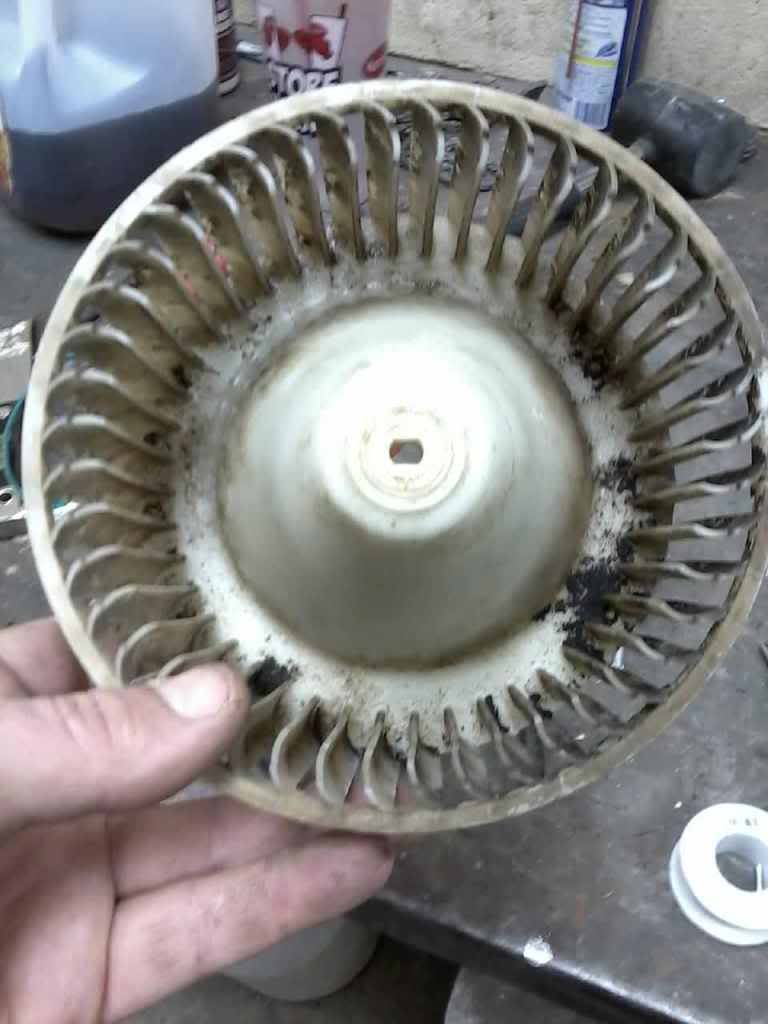

Below is some of what I had in mine. The blower motor was out of balance due to debri as well.
Copied....
The windshield cowl screen is missing and had a lot of leaves and such down in the vent and blower motor. I did this on the 88 also. While having the dash apart, I cleaned the blower motor and getting some of the ventilation pipes cleaned also. They do get a lot of dust build up in there. Have ran water through them before and looked like mud coming out of them. Seems to help keep the truck smelling fresh on previous projects. Was surprised at how much dust came out of blower motor from the brushes also.
Took an air hose and blew the dust out of the motor while at it. I use a 5 gallon bucket of water and air hose and cleans small item really well.

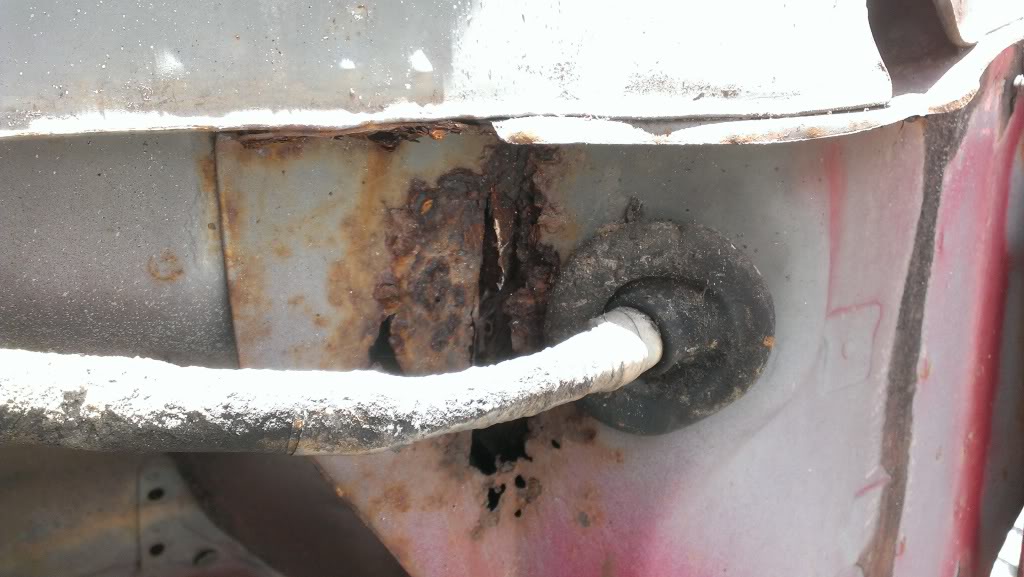

In the very top right hand of this picture is the opening of where it drains. You will need to pull the fender, or you might be able to get to it by pulling the inner fender. You can see the damage Cory is dealing with as well.

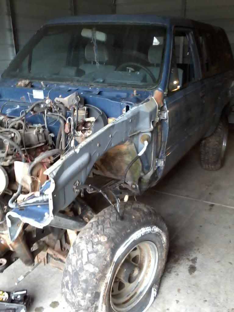

Here is a picture that you can see a little better. To get the debri out under neath the far corners if it has turned to mud can take some patience as you cant reach it with your hands. I use a shop vac with small hose, then something like a toilet brush, especially on the passenger side as the stove pipe gets in the way, then and air hose. After it is cleaned I use soap and water to get the film off.
Something else you can do, is to remove the 3 screws that hold the front mudflap on an then one or two more screws that let the inner fender move forward enough to see how much debri is setting in your fender area. Another view just above harness.

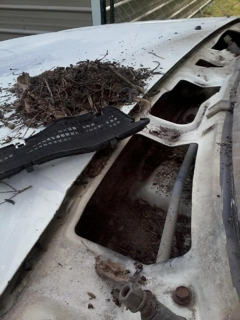

I tried to get a picture of it, but there is a stovepipe that is on the passenger side and it goes directoy to the blower motor. Sometimes debri can get over the stovepipe and gets into your ventilation system or cloggs up the AC condeser.

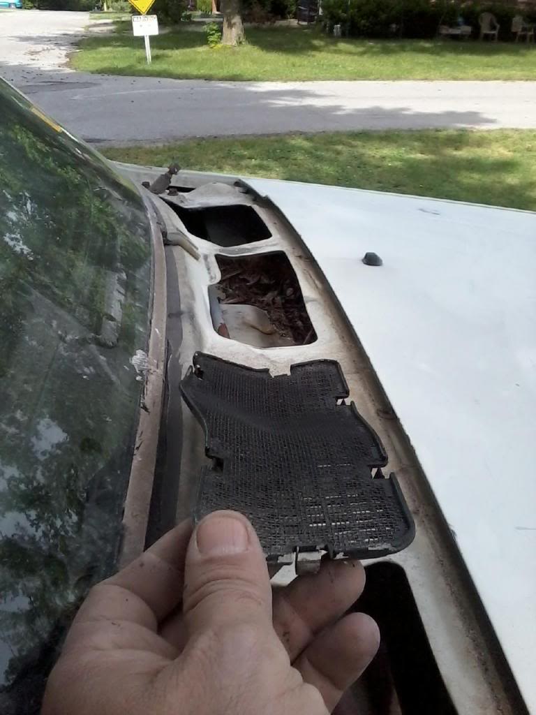

This may be half of what I got out. I used the shop vacu and then an air hose to get the rest out. There is drain holes on the far edges of the truck for water to get out, but the drains can clog. Another shot of the cowl screen I was talking about. I also took the truck to the windshield shop and had to them to remove the trim. Even after watching them, I dont think I could get it off.
If you are going to have a truck painted, removing alot of these things will give a better and cleaner paint job, as well as preventing rust.
