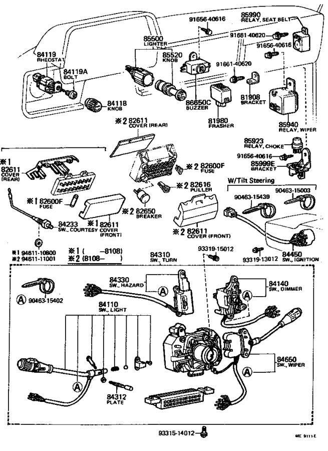

Ok I can see the confusion. Standing in front of the truck looking at it. The right side which is the drivers side has a small modual marked emission control, 89550-35170.
Then 81 22r Calif. This is mounted on the right kick panel. The left side should have a computer module but it doesn't and no wiring for one. But it does have a warning buzzer mounted there. That's why I think it is really an 81. Maybe the 81 model had no computer?

The only type of computer used on 22R powered vehicles is the Emissions Control Computer, which it looks like you already found.
The rest of the modules are flashers, buzzers, fuse boxes and other relay boxes.

I think I found it in the 82 manual. These only had a computer mounted on the left kick panel if it came equipped with a cruise control. Which mine doesn't have. The right kick panel has the emission control module. Which in the manual is also referred to as a computer.
