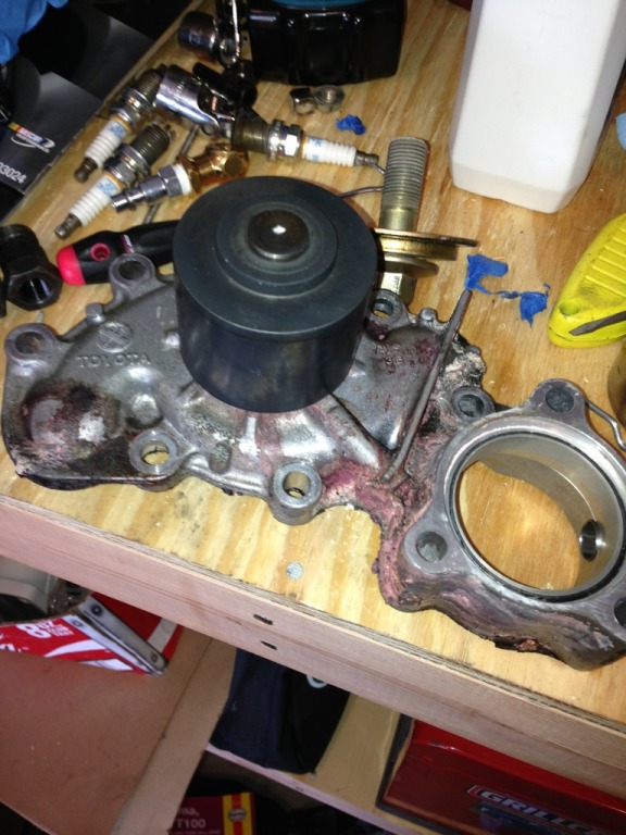

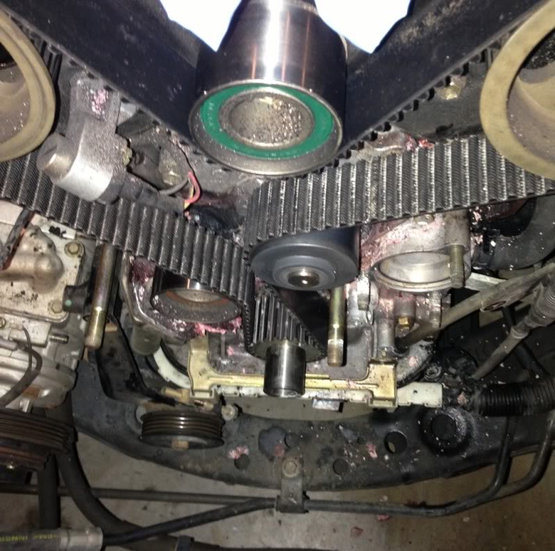

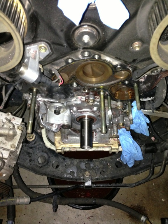

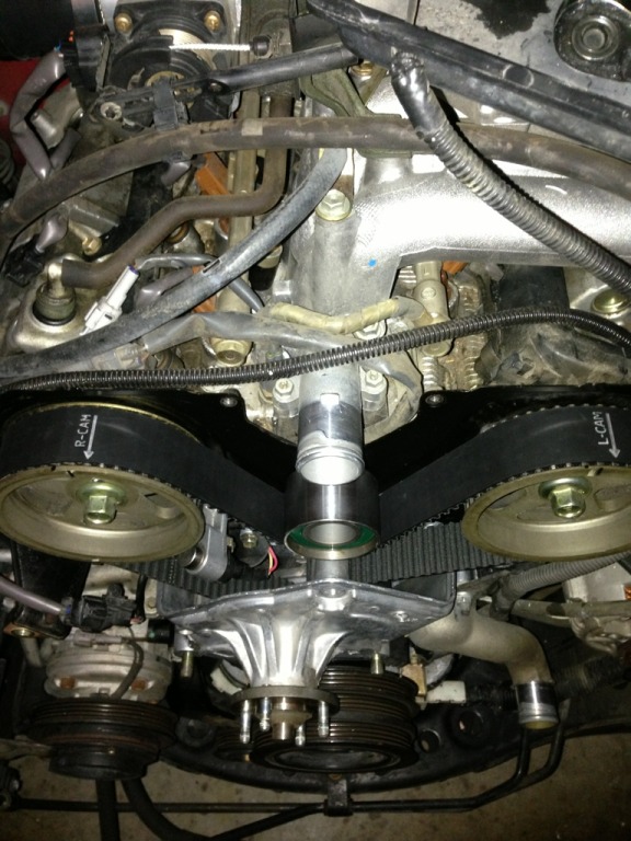

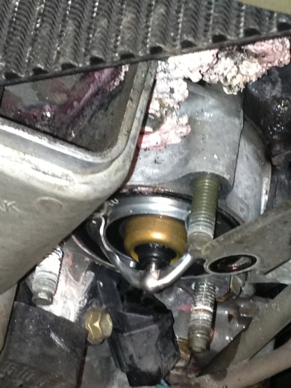

Well I finally had time to get it all completely put back together Sunday afternoon and it runs perfectly. I changed out the crank seal and everything behind the timing covers. some of it could have gone for another 100k probably but I figured, what the heck. I had it all torn down so why not change it all out. Now I've gotta tackle the valve covers in a few weeks. I wound up buying the crank holding tool for the job so if anyone needs a loaner, let me know. It's just going to collect dust for another 100k. Here are some random pics I took during the job just for kicks.
