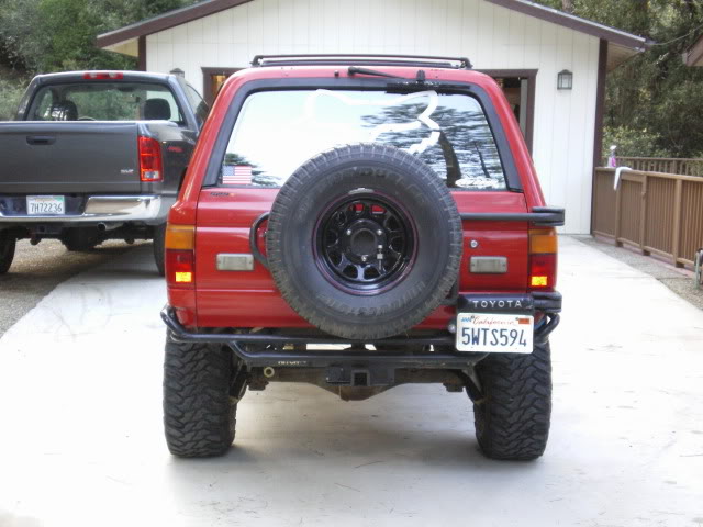

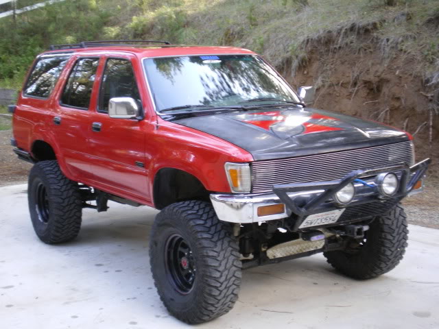

Here are some pics of my old 91 with a 4-5" Pro Comp lift and 33x12.5's on 15x8's. The lift is pretty much the same as the Rough country you are getting. I had no issues with rubbing.

Hope this helps.

Yes it does and is the right height I am looking for...Thanks!
