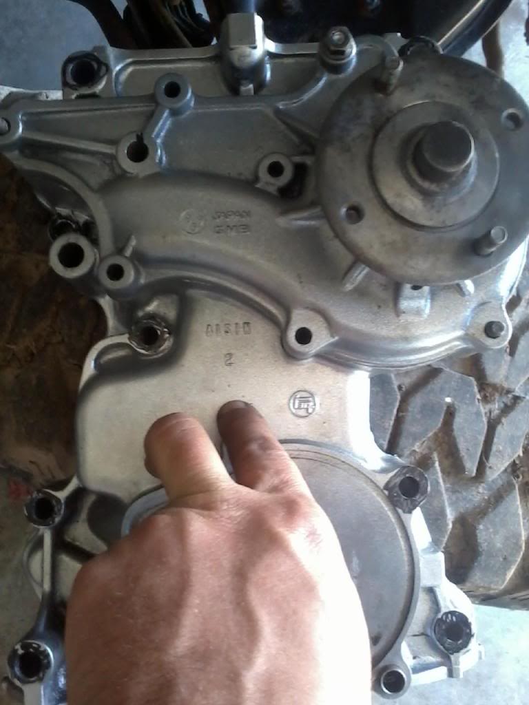

Here is some of the differences and other ways I use to check which block.
Copied...
I got my Timing Chain on and had to replace the Timing Cover due to it being worn. I tried to use a early model 22r and they wont interchange. Thought I would put some info up to help others identify what they may have.
84 and older. 22r has no dimples/circles and the number "2" on it. Twistedyota got it right on the height thing, see the last picture for a good example. I also tried to mark which bolt holes for removing the timing cover on down the road when I have to do a chain again. Hope it wont burn off but it if does I tried to come up with an easier way. Never can remember which bolts they are.

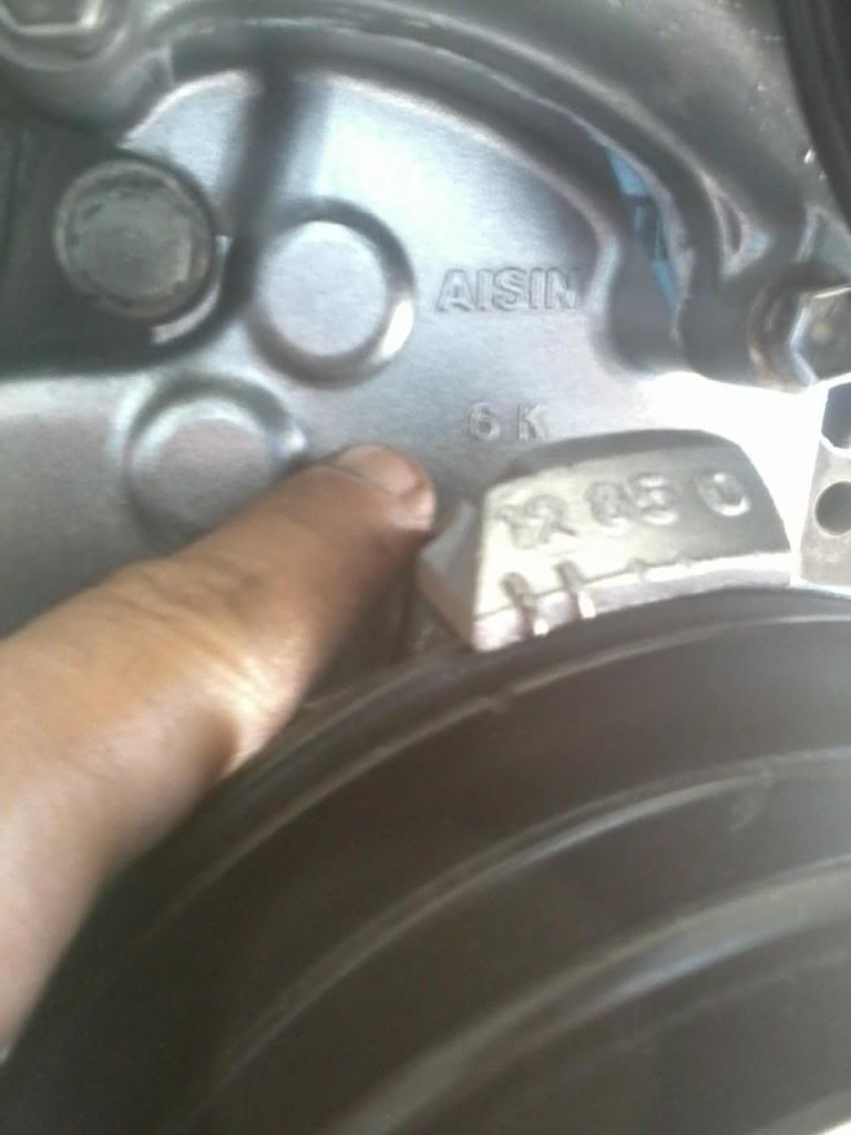

22re has "6k" and dimples/circles. 85 and up.

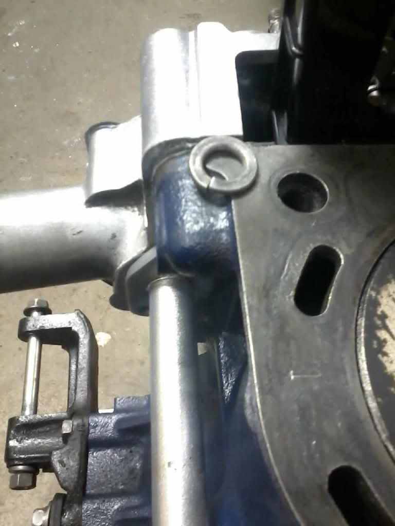

Here is what I am talking about on the 1/8th inch height. I used a lockwasher to help show how much of a difference. This cover is 22r. Seems like the oil pump bolts were to short. Hope this will save some one some trouble. It is an early model 22r timing cover on a newer 22re block.
