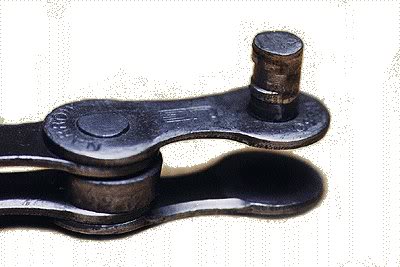

Ok, so regarding Chain Stretch:
I don't have measurements on the old chain yet, I will take those later today. The chain in question seems to be a strange fluke, it stretched over a 50,000 mile period, which is most definitely NOT normal. But, here is some general information:
The 22-R circa 1981-1984 was unique to the 22 series of R motors in that the timing chain, sprockets and guides were more like those of the 20-R, double row with metal TC guides. As a result, guide failure is not very common on an early 22-R. What is more common (and just happened to me, which is why I replaced the chain) is that when the chain gets slack to the point where the tensioner can't keep up any more (or the tensioner fails), the cam sprocket jumps a couple of links, advancing cam timing by several degrees. If you are driving the vehicle when this happens (and since it commonly happens when the engine is under load, you usually are), it feels like the world is ending. My truck made a number of loud choking noises while I was going uphill at 55 miles per hour and 3000 RPM in third, and shook the whole vehicle while it shuddered horribly to a halt. Upon removal of the valve and TC covers, the chain was slack to the point where I could touch it together in the middle, with the tensioner fully deployed at max tension. As a result of the skipped links, the cam was advanced 15-20 degrees, I have no idea why my valves are still intact.
On the 22-RE motors, from '85 on, the TC was a single row chain, with plastic guides. Any slack in the chain was immediately transmitted to the drivers (slack) side TC guide. Also, being a single row chain instead of a double row, the TC was weaker, and more susceptible to stretch or breakage. Between the increased amount of stretch, and the new, crappy plastic guides, that made the TC cover, water pump issue arguably the weakest link in a motor known previously for its indestructibility.
Chain stretch, specifically, is a well known occurrence. Just ask any motorcycle rider, and their chains are built much heavier than any timing chain. The biggest culprit for causing a chain to lengthen, or "stretch", is not actual stretching or lengthening of the links (I'm guessing you know this already due to the fact that you put "stretch" in quotation marks earlier ). Instead, it is caused by wear at the pins and bushings where the individual links connect. Here is a picture of what this looks like on a bicycle chain:
Since I don't have the actual chain in front of me at this time to measure, or a brand new one to compare measurements with, let's look at a completely hypothetical timing chain. Lets assume a timing chain that is 64 links in length, where every link is .5 inches from the center of the pin to the center of the next pin. Such a chain, in a straight line, would be just a hair over 32 inches long (in circumference, through the center of the pins), or about 18 inches doubled.
In such a case, if every link "stretched" by 1/64th of an inch (or 0.015625), the entire chain would gain an inch in length. If every link "stretched" by 1/32nd of an inch (or 0.03125), the entire chain would gain two inches in length. Realistically, if you get out a pair of calipers and look at the distance involved, it would not seem unrealistic to see up to 5/64ths per link of "stretch" (or pin and bushing wear), which would manifest as a whopping 5 inches of gain!
The tensioner is probably capable (again without measuring) of removing 2-2.5 inches of slack from the chain at full extension. This could leave as much as 2.5 inches of slack in our hypothetical chain.
In a 22-RE motor, most TC guide failure seems to occur at around 100-150k. I can't imagine 5 inches of slack at this point, but it certainly wouldn't need that much. Even 1/4 inch past what the tensioner can handle, plus the wear damage that is already occurring due to normal use would be enough to make the guide fail. I think 1/4 to 1/2 of un-tensioned slack in the chain should be enough to let the chain run to the water-pump edge of the TC cover, but I don't know for sure.
Thoughts?
