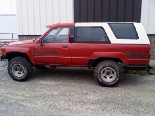

well what daya think ?
Old Sep 21, 2010 | 06:49 PM
whokrz's Avatar
Posts: 535
From: Suisun City, California
Looks pretty clean for a 25yr old rig.
