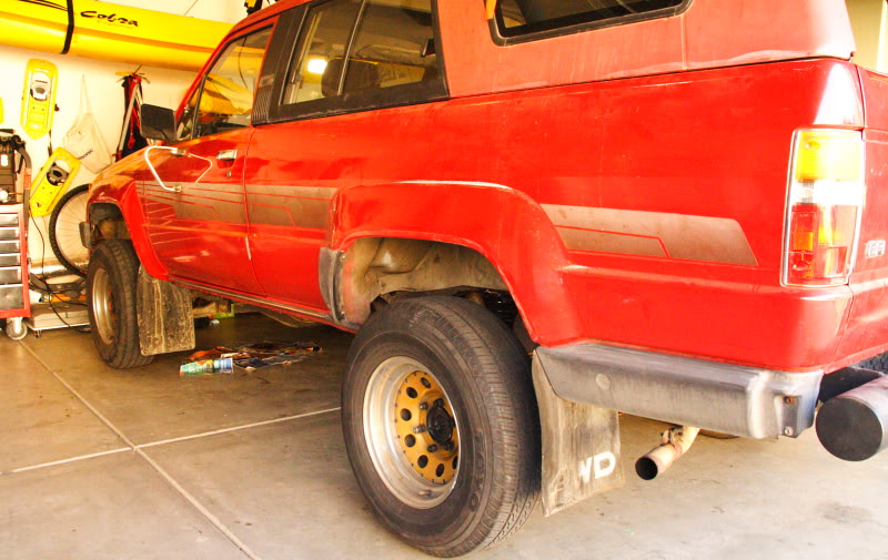

Hi guys,
A friend is offering his stock alloy rims (2nd gen 4Runner I believe) to me. My current rims are after-market steels (pic below) that sticks out around 1 inch beyond the fender flare.
I believe stock rims would not stick out as much, correct?
Do you think not sticking out (is that what's called zero offset?) would help with gas mileage/efficiency? Would it present less strain on steering components?
I understand wider stance is more stable but I;m a conservative driver so no big deal.
I don't really know how much the current steels weigh, but is it safe to say that alloys would weigh less?
This is a DD and not a rock crawler so chance of bending the rim is minimal.
Thanks a lot for your expert opinions, guys!
Here is my current rim:

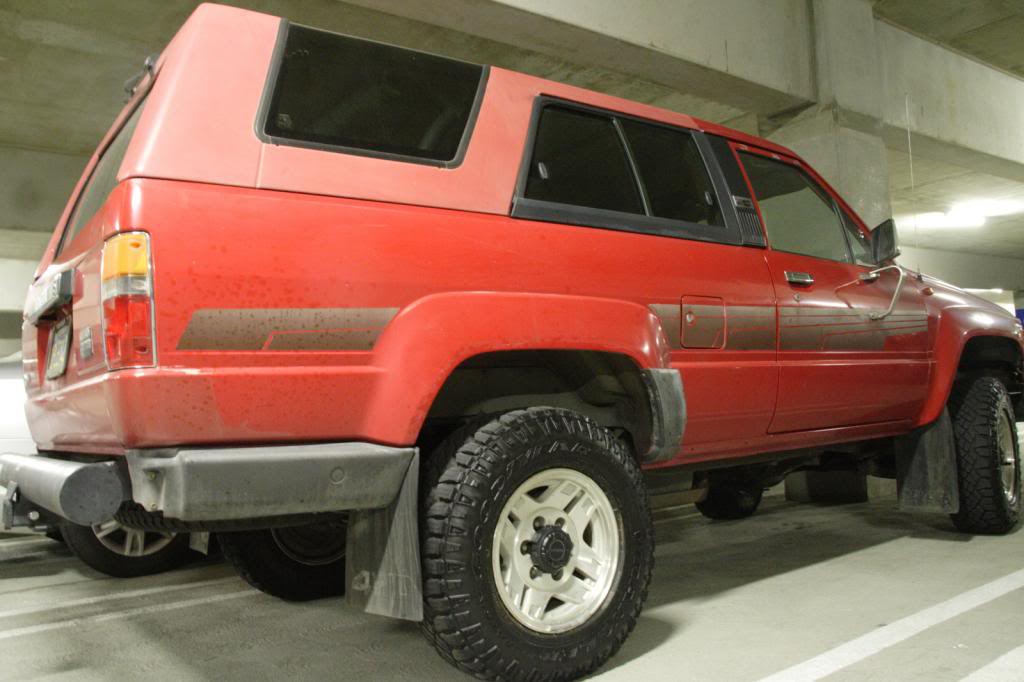

Hi Rad,
Here's a pick of my '86 with 2nd gen alloys on it. They are relatively light with 31x10.5s on them.

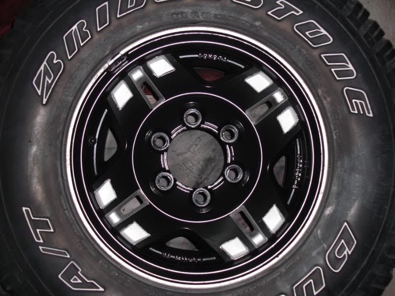

sorry for the crappy cell phone pic, but you get the idea. I actually have a second set of these rims, and I plan on painting them like this:
and putting 33x10.5 bfg ats on. These look soo sick!!!

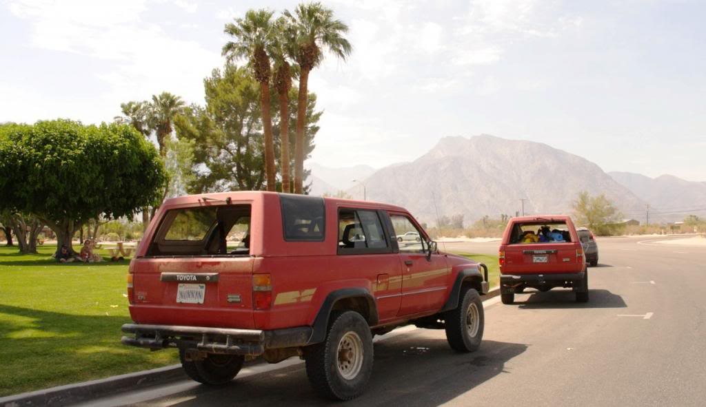

BTW, Matdisney, ours are twins, and here's another 86 Runner behind Ruby Tuesday...

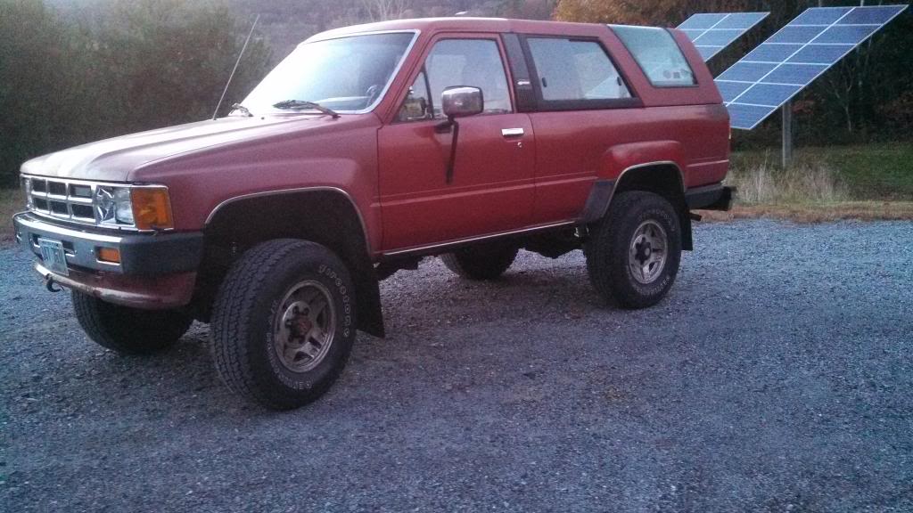

Got the 2nd Gen 4Runner tires installed today and I really like the almost stock look:
Tires don't stick out as much as the old steels. More details are on my build thread.
