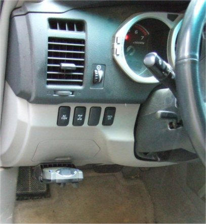

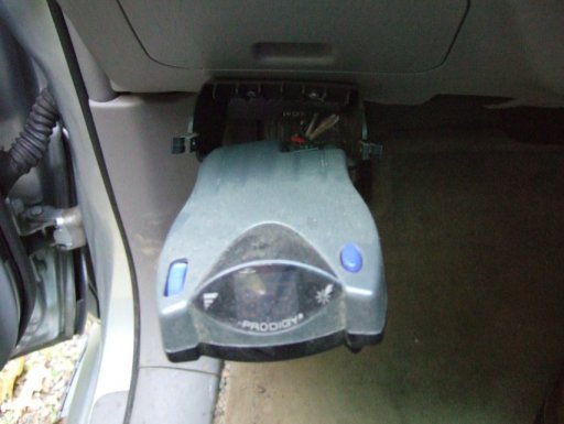

Prodigy mounting and pics...
Overview...
Mounting clips pulled (removable unit), but wires still attached
Mount with Prodigy removed

One more. Shows the wiring. See the Prodigy mount wires in the bottom right corner and the top right shows the white connector under the dash.
I had to cut the zip tie when connecting it, then put a new one on.
Not the best pic, but it's hard to get lighting in the rain
Hope this helps.

Sweet, really appreciate it. I read thru the other thread too. I think thats the controler my dad has in his cummins and really likes it.
sidenote.. whats that switch all the way to the right? VSC off??? I could like one of those..
That switch on the right? Oh, that's the chaff deployment switch. Can never be too careful these days...
Just kidding. It is the RSCA off, side curtain airbags, so they don't deploy if you are offroading a little rough. Even if off, they're supposed to deploy on impact, like a complete roll, but won't anticipate in a steep tilt.
I haven't tested that theory, just what the dealer told me.
If you want to see all the gauges and buttons light up at once, just get it going and off the ground for about 3 seconds (around 65-70mph over a good hill) and the whole thing lights up and beeps. Lots of fun...
