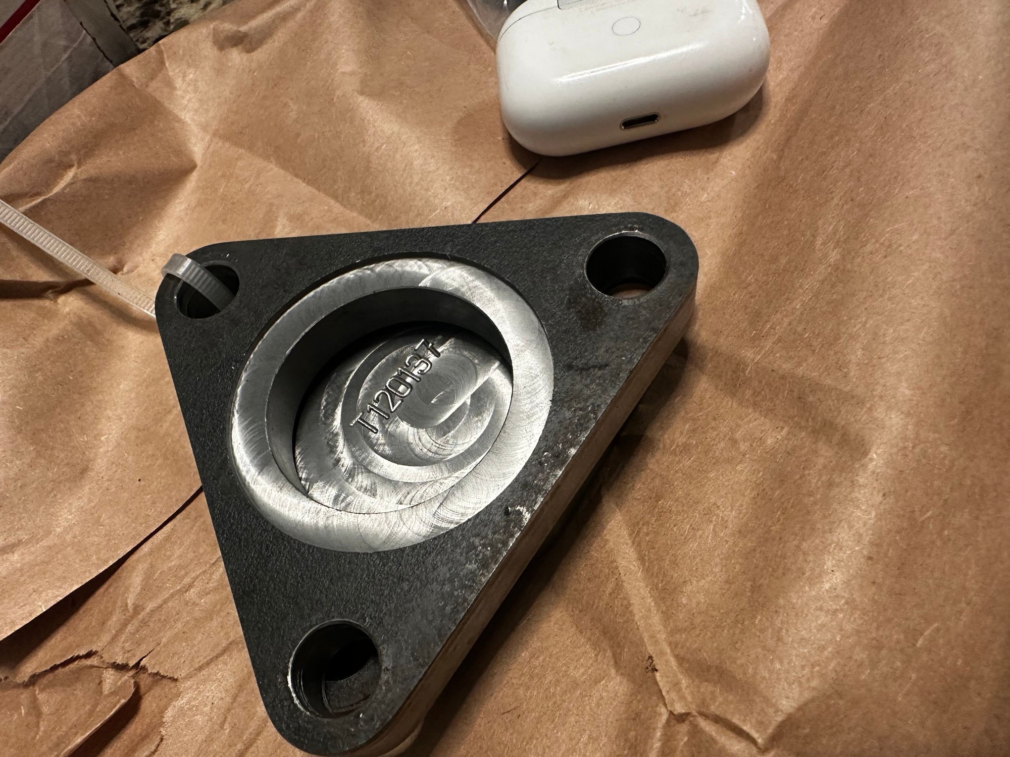

I have purchased this kit. Doesn’t come with the pipes. I will get my local fab shop to knock it out. Expensive for block off plates yes. Cheaper than headers … yes.
Ordered today. Will report back.

Here is the add. Which looks great. But the pipe is not included.

Got the kit today. Looks well made. Hopefully the install goes well. Where does the metal ring go ?

Originally Posted by Spread5150
... Where does the metal ring go ?
Gaskets.

Interesting diagram. So the crossover tube goes into the manifold ? Here is a question …. Would my replacement passenger side pipe also go into the manifold with the gasket around it ?
In the video it looks like it stops at the plate and the gasket goes into front ?
I plan to get into this project tomorrow
