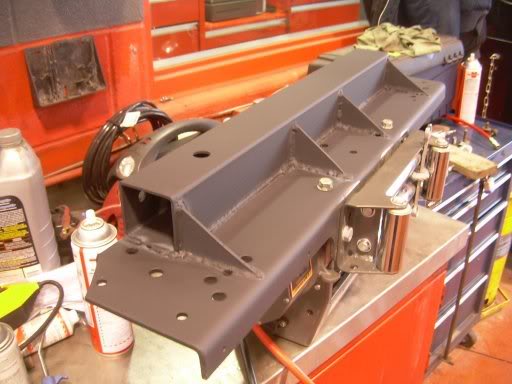

That "brush guard winch mount" looks like it's last exactly ½ a second actually pulling something.
You can't bolt on a winch mount w/the stock bumper & actually use it. You need to get to the frame and solidly mount your winch to it. There are a TON of front bumper options. Don't waste your money on something that will fail when you go to use it.
There's a good thread on Pirate; Clicky Here.
Here's what I did for a cheap solution 'till I can make a full-on bumper;
Size:  36.0 KB Name:  WinchMount2.jpg
It's worked well so far, but I wouldn't pull up or down with it - only straight on. There's a 3" body lift on my truck, so to do the same on a stocker would require cutting the bumper clean in half, and probably some of the grill. Sacrifices will be made
