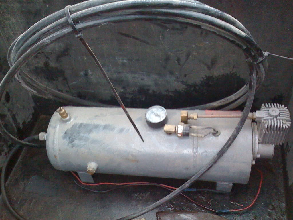

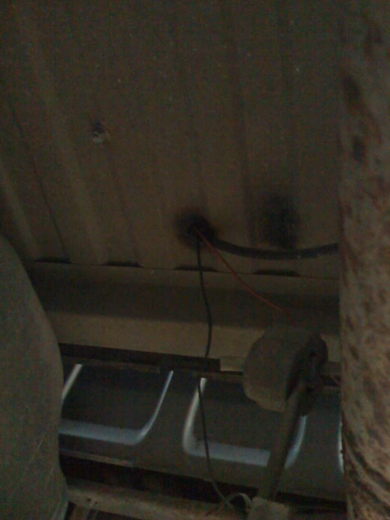

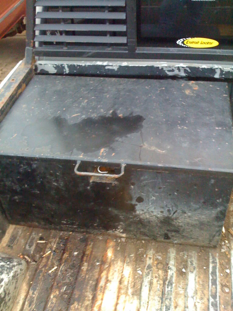

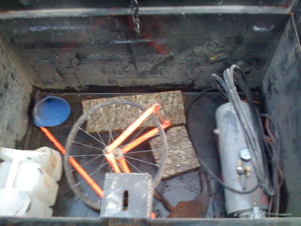

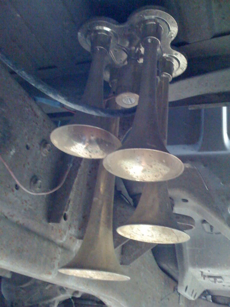

Old Sep 24, 2008 | 04:31 PM
  #40
SwampThing's Avatar
Joined: Sep 2006
Posts: 2,094
From: South
I used to have dual bell 36/26" horns mounted up under the bumper, but that's just a horrible place to put horns sound wise, and I didn't really want to mount them on the roof. These 4bell siege's are super loud, and combined with the fact that they're pointed at the ground, they reflect off the pavement so they're not direction and they sound much much much louder than those longs ever could have.
