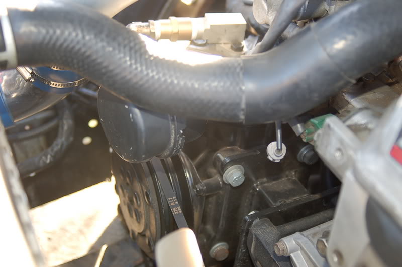

Old Aug 31, 2008 | 11:15 PM
Matt16's Avatar
Joined: Oct 2007
Posts: 5,377
Likes: 5

Old Sep 1, 2008 | 07:37 AM
Junkers88's Avatar
Joined: Mar 2008
Posts: 4,371
Likes: 6
From: Texas
Originally Posted by Matt16
Matt where did you get the bracket?
Old Sep 1, 2008 | 08:31 AM
bigt's Avatar
Joined: Nov 2007
Posts: 3,278
From: chippawa niagara falls ontario
and where is your afm matt16
Old Sep 1, 2008 | 08:48 AM
Matt16's Avatar
Joined: Oct 2007
Posts: 5,377
Likes: 5
That's not my engine. Those were just all the pics I could find of Yorks mounted to a 22RE.
