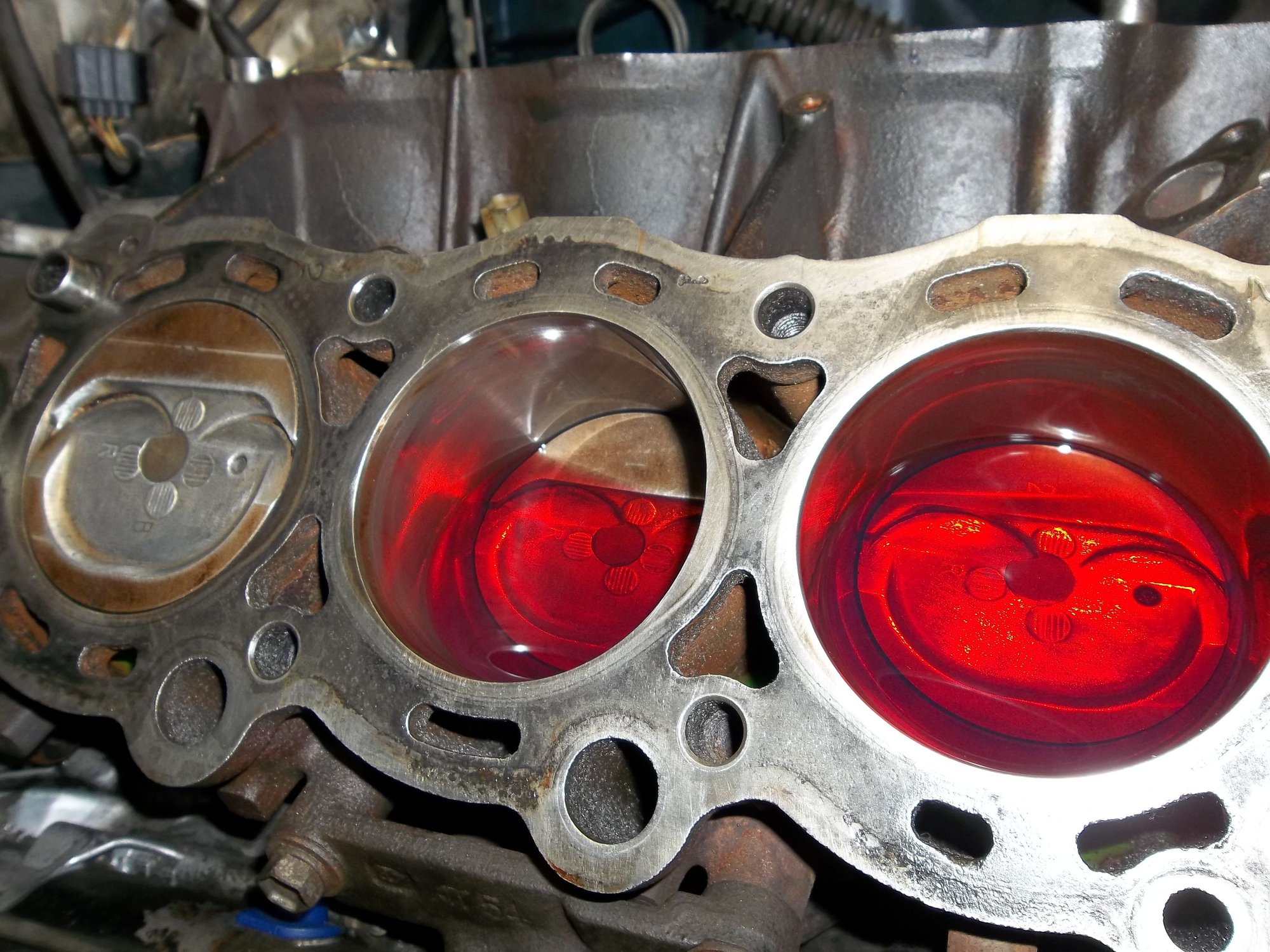

Going to buy some PB blaster and put on the tops of my pistons let sit overnight check to see if any fluid leaks out and if it does can indicate a bad piston ring. A suggestion a friend who is a mechanic gave me. I found an vertical indent in one of the cylinder bores. hmm? And as far as the heads I was going to get the oem stock rebuilt ones supplied by engnbldr

When I have seen a vertical indent in the cylinder in the past, what happened is a piece of the ring snapped off and gouged the wall. I rebuilt a motor with the same indent and it had to be taken .30 to get the bore straight again. I would not be surprised to see that cylinder not hold the fluid.
I use Marvel Mystery Oil for test like you are doing but you should get the same results.

If your heads are off, just do a close inspection of the top inch of each cylinder bore. You'll see "cross-hatching" in the bores from the original machining process, it will be worn away where the first ring stops, as well as along the top and bottom walls of the cylinders. If you see TWO steps, you most likely have a broken ring. This area is where neglecting oil changes will show itself.

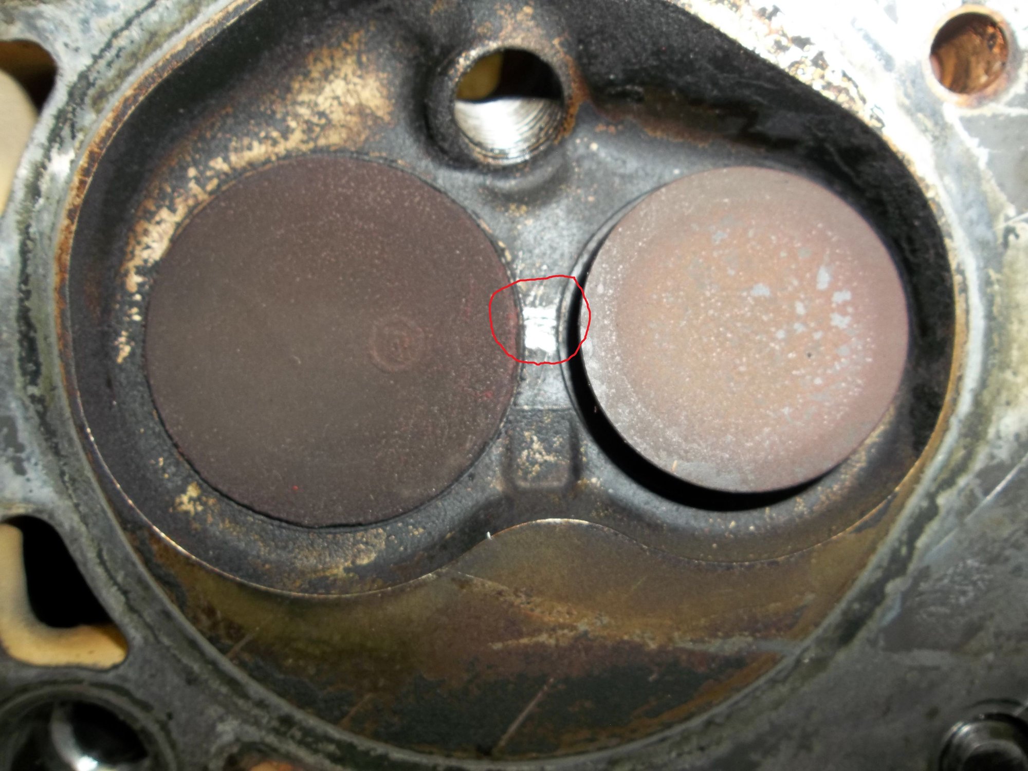

look closely between the valves
Heads usually crack in between the hardened valve seats. Look for a very faint line at the closest point.

Here's a pic of one of the head cylinders.
I scraped this area off with a screwdriver, why its so clean right there but I did wonder if this is a crack. Is this the area you talking about?

Yup, you found it
That's the crack they're talking about.
And for the sake of clarity, the cylinders are in the block. The indentations in the head are combustion chambers.

That is not the gouge I was talking about in the cylinder earlier, ones I have seen are DEEP. I cant see anything in your pic and think you will be ok with what I can see but a picture does not show dimensions so have it checked by a shop or someone who can on that.
Heads can have a hairline crack. Literally the size of a hair. One I thought was cracked was carbon, one I thought was carbon was a hairline crack. Not sure why it would be so clean where you circled the head.

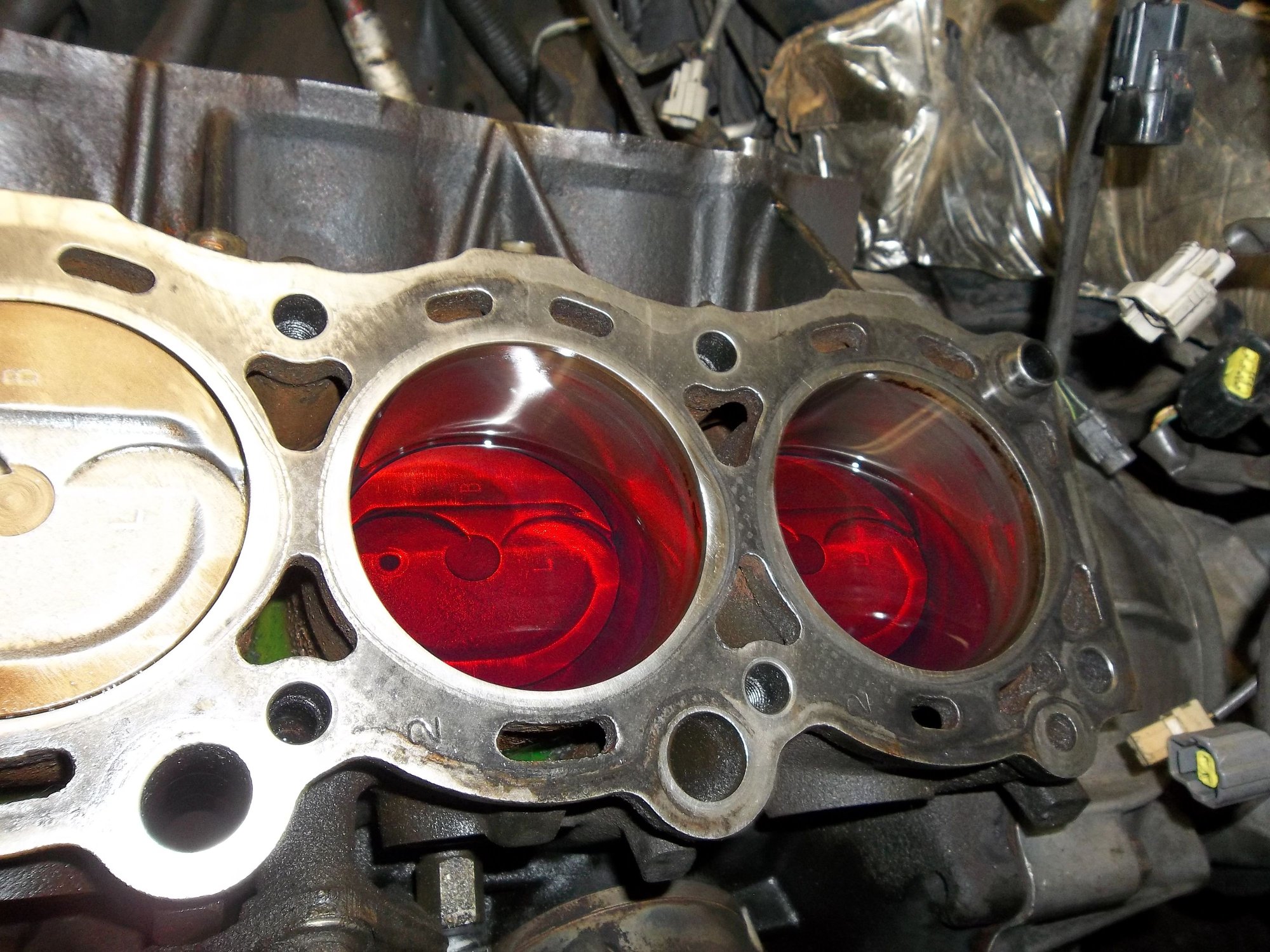

So cylinder #3 leaked that much compared to the others over a 24hr period. Testing the remaining cylinders tonight. Cylinder #2 was the one that showed up with low compression (20psi). I don't know what the others tested at but assume they were within 30psi of each other. We also checked the block surface for flatness with a straightedge and a feeler gauge with the spec in my Haynes manual (0.0059in) and that showed up good. Can't find any cracks from looking at it either.

So I tested the others over a 24hr period and cylinder #2 drained a little but not as much as cylinder #3. Guess my bottom end is fried. I've been side tracked working on my Camry doing the camshaft, crankshaft and oil pump pulley seals. I pulled off the spark plug tube that has been leaking pretty bad into the spark plug (this is after a new valve cover gasket set which could have been felpro though). I don't think these have spark plug tube seals where it screws into the head unless it was completely disintegrated. Anywho you guys think I should just get a used 3 slow since this test came up bad?

I've been watching your thread, because I'm not sure I believe that test works. When cold, the piston rings have a spec gap of about 1.2mm; about the thickness of a nickle. The rings are (supposedly) installed with the gaps spread around the circumference to slow the passage of cylinder gasses.
But it's not water-tight. The oil you used is relatively viscous, so it might not flow too quickly through a small space, but the slightest variation between cylinders could change that. You could have a ring with slight mis-gap, or a few rings where the gap rotated toward the lower side in your test.
The difference between cylinders gives me pause, but I'm not sure yet whether you need to rebore the block (expensive) or just re-ring (not so much).

too many variables to really trust that test
As scope stated, ring gaps should be clocked around the piston to minimize compression loss. The rings have a gap cold because they grow as operating temp is reached. You might be able to see where the gap in the primary ring is, but you still have the secondary and the oil ring gaps, and without pulling the piston have no idea where these are. The closer they are to the bottom, the faster your oil will leak. The closer they are to each other, the faster your oil will leak. The less carbon on your rings, the faster your oil will leak. Sludge buildup in the oiling ring. Whether the piston is in the up or down stroke. These things could all affect your test, not to mention you're doing it deep in the bore, where wear and stress is minimal and might actually work against you.
I wouldn't condemn anything based on that.
