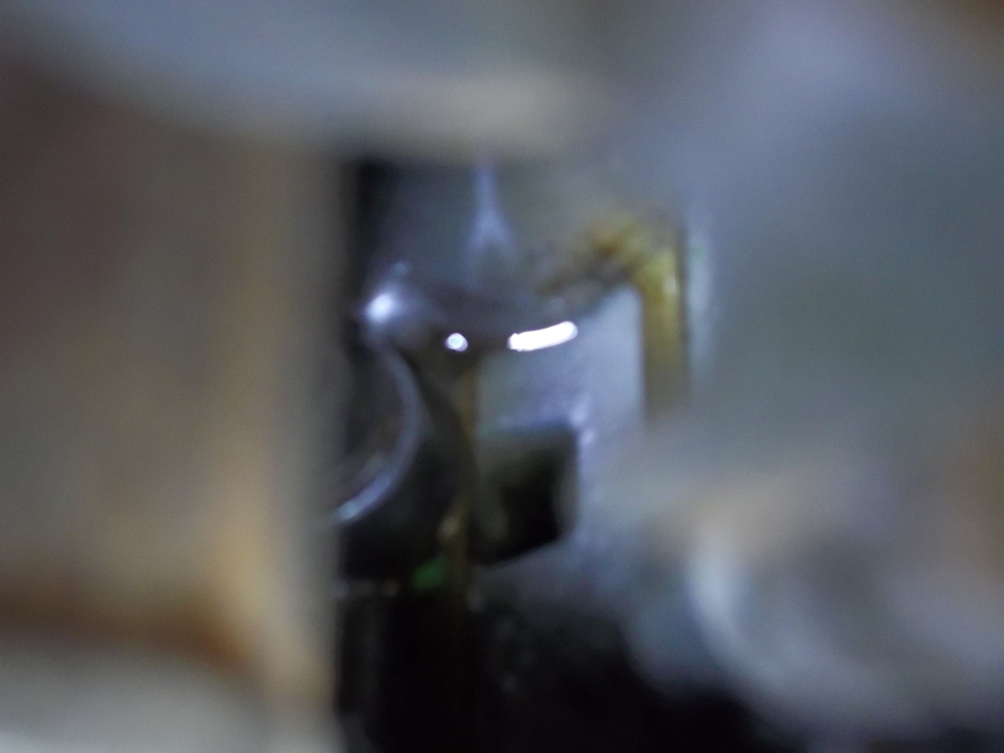

In the pic is the driver side that shows the edge of the middle fuel injector. Fuel is coming out of the hole on the cylinder head (small rectangular hole in pic). I concluded it is coming out of there because a puddle formed and I can clearly see air bubbles coming from there. First off I don't know what is causing this and it also means tearing it apart again. Yay
EDIT: I start it and immediately it starts leaking and the puddle forms very quick.

Can't make out the pic, you mean intake manifold rather than head? It's very easy to roll one of the injector o rings out of the channel it seats in. Best to oil it a little and turn it back and forth as you insert it into the rail and then again checking all three as you put the rail onto the intake, feeling for any increase in resistance which would indicate a gasket coming off track. All injectors should spin pretty freely after insertion.

Actually that's exactly the problem I can clearly see the fuel injectors aren't seated all the way. I thought I made sure they went in well but I guess not. I'll try taking it apart again and straighten them out. Thank you for the help

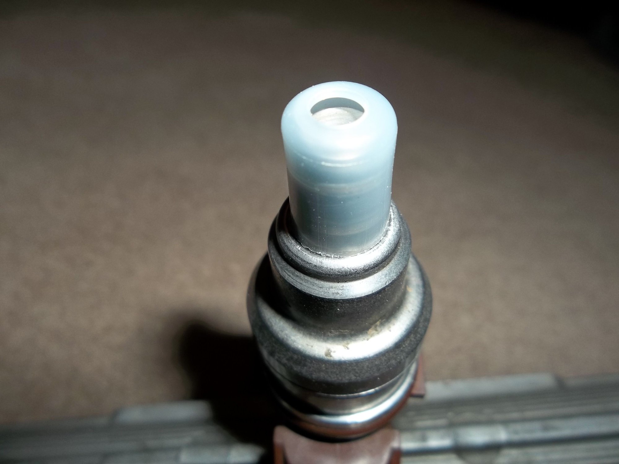

Ok so I discovered that the pintle cap on the middle injector (where it was leaking) was broken so I ordered a rebuild kit for the one injector and wasn't sure if the pintle cap that came in the kit is okay to use because its a little bit different with a larger hole.
Stock is the bottom pic

It would probably be ok, I would probably return it anyway.
