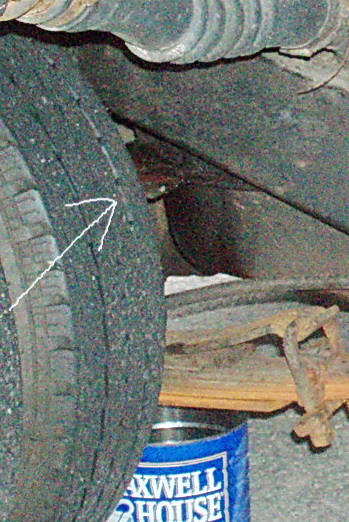

Thanks for your help. I had to leave early this morning for the tank. Its the same length as mine. Looks to be in very good condition. I have posted a picture of where the rust is. Its on the seam and has expanded out, split. The thank I bought which is in my first question looks good to my eye. Its rust on the bottom. I'm getting ready to wire brush it then paint with rustoleum hammered finish. I see a sheild in one of your pictures. Mine had none. I plan to look for one and put it on later. Thanks for all your advice. Since I'm a sculptor and not a mechanic I will have a mechanic do the work so its done right. I had a hell of time replaceing the fuel filter which looked as if the mechanic I was taking the Truck to never replaced it. I will let you know how I make out.

If the runner tank does not work for you, you can take that tank and clean it up on the inside and then use Red Kote to seal the inside of the tank. It will seal up some good sized holes.

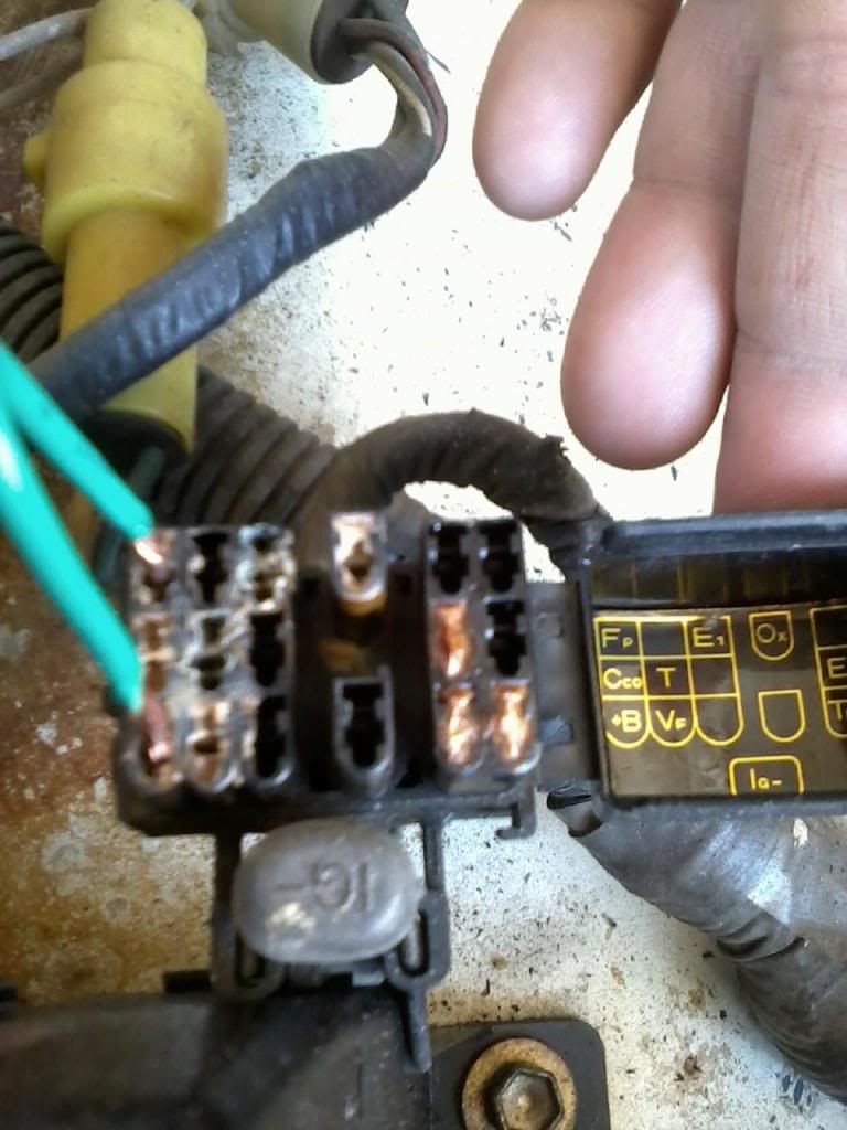

Now I have a new problem. After they put the new tank in with the new fuel pump bracket, & the fuel pump that was in the old tank the fuel pump is not working correctly. I drove the truck home. It sat for an hour or so. I tried to start it, no luck. I took the rubber hose off the gas line from the tank to the fuel filter had someone try and start it, no gas pumping out. Had it towed to the mechanics. He tested the pump with some test equipment its not the pump. He checked a relay under the hood. That was ok. Then he said there was another circuit opening relay under the dash on the passengers side. I took that metal box out and could not find it anywhere. I don't know if he found the relay they didn't call today. I have been waiting for days to have this fixed. I don't blame him at all. Obviously hes stumped. Anyone got any ideas what could be wrong? Thanks

The Circuit Opening Relay is right behind the passenger speaker cover. Will it run with the jumper in below? This will energize the pump. You do not want to keep it installed, just to see if the pump circuit is working. If so, then you can start looking at other issues. If not then you may have a bad pump or wiring.
Did he get the correct bracket? If it is the wrong one it may not be picking fuel up from the bottom. I would fill the tank and see if that makes a difference. These brackets do vary in length by alot. If he got one to short, it may just not be picking up fuel.
Fp +B Fuel Pump Test for 87 and newer. Use a paper clip for better results.
