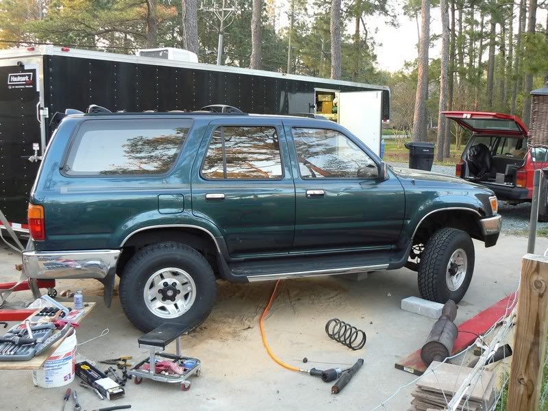

Heres a shot of the passenger side(it's the best I have right now) - look at the front of the fender

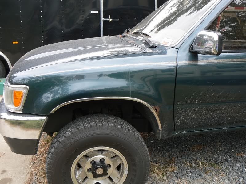

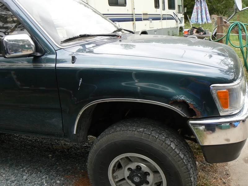

Here are my problem fenders -
I also figured out the hard way that not all Sherwin Williams have autobody supplies - I got it straight now though.
I would up with a qt of 2 part primer -
got a qt - 2 part clear coat -
and she mixed my base coat(qt) so its ready to spray
Now I am waiting on the weather to be clear.
