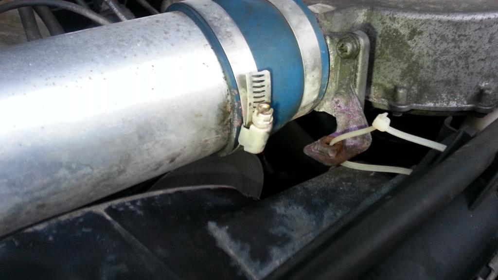

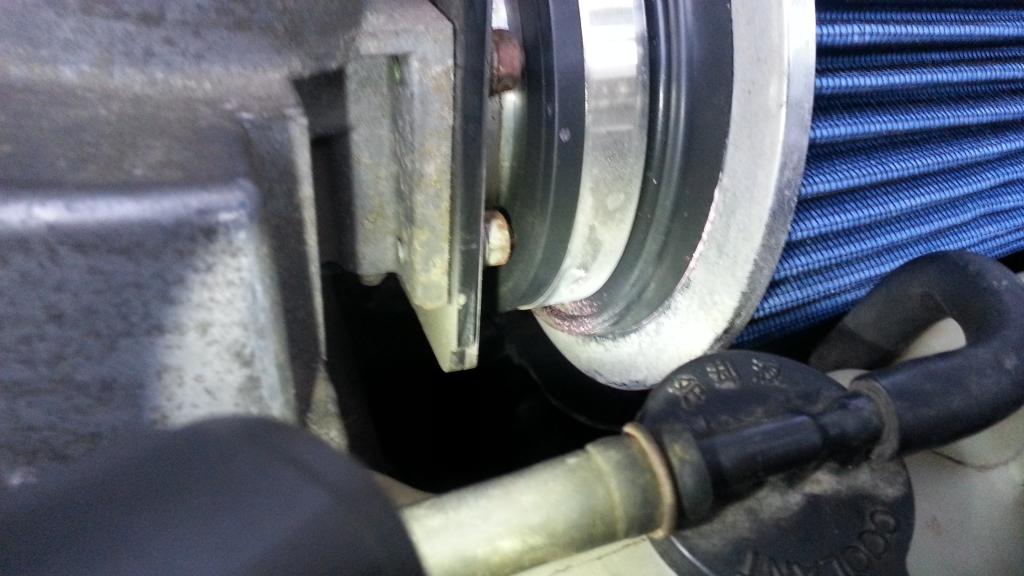

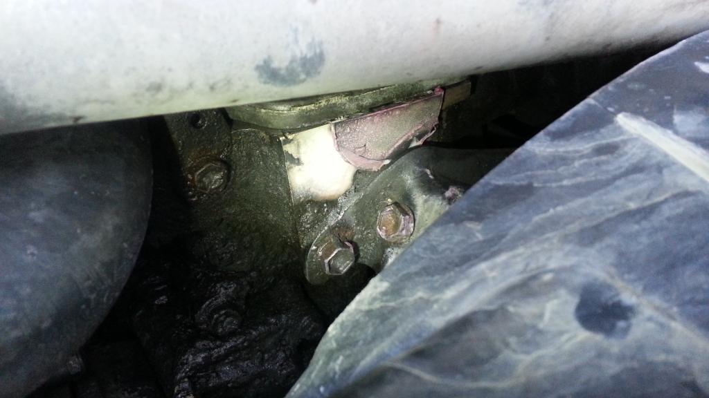

Where is this coolant coming from?
Where is this coolant coming from? I noticed it after a 100 mile highway ride. I did another one shortly after and didn't seem to notice any additional buildup. The coolant reservoir seems to slowly fill, I haven't had it fill to the point that it overflows, I just occasionally suck out the excess and put it in the radiator. After the highway trips the radiator is low maybe a quarter gallon, some of that is in the reservoir, some is missing.
The filling reservoir has been happening for a while but seems to be a bit worse now. About a month ago I was in traffic and due to a bad fan clutch, it got hot, not into the red but close before I noticed it and immediately shut it down. I was of course worried about the head gasket, I have been checking my oil religiously since then, making sure coolant hasn't mixed. Oil looks fine.
Is it a head gasket? Where is that coolant spray coming from? The rad cap was steaming a bit when it overheated, maybe some of that spray is just from then and I didn't notice it until after the highway trip when I was missing a concerning amount of coolant?
If it is a head gasket, am I fine to run it, just top off coolant and check the oil regularly? I don't have the time to replace it right now. Should I check the coolant for exhaust gas with some of those strips or whatever they are? See if I just have exhaust pressure filling the reservoir?
Any ideas are greatly appreciated!

Could it be a pin hole leak in your radiator core or tank spraying when there's sufficient pressure? That might also explain why the coolant in the reservoir doesn't get sucked back into the radiator when it cools down. Look for odd colored spots on your radiator or missing/bubbling paint. Those are signs of at least a potential leak.

Sounds like the radiator. Either it's got a pin hole like nv said, or it could be rusted on the inside and clogged not allowing it to run through and siphoning back to the reservoir.

So I cleaned off any dried coolant, topped off the radiator, and went on that 100 mile Highway trip again this weekend. As soon as I arrived I popped the hood, coolant was bubbling from the radiator cap and had sprayed on the underside of the hood and ran down to the fan where some was slung around. It seemed like it had happened towards the end of the trip, didn't lose much coolant. Temp gage was just under half the whole time. Overflow was just slightly over the full mark. Could it just be a bad radiator cap? I replaced it a few months ago with one of those types with the red lever you can pull to make sure it's depressurized. Maybe during that slight overheating event the cap was damaged? I'm heading back later today, I think I'll get a new cap, top everything off again, clean it up, and see how it does on the return trip.
Before I left I drove around a bit, then checked everything. I did notice that there was a bit of coolant on the cap that I thought I had cleaned off. It would make sense. It leaking right there would let it flow directly onto the fan, spraying it around like it was when I first had the issue.

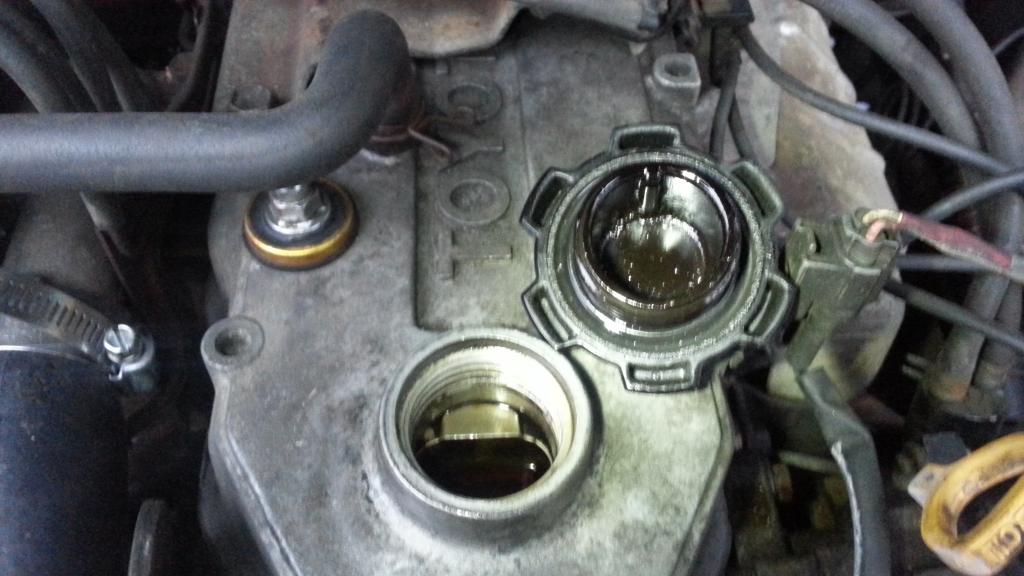

Old Sep 23, 2014 | 07:20 PM
Nickdigg's Avatar
Joined: Feb 2011
Posts: 35
So I replaced the cap, drove home, no coolant spray or loss. The overflow had filled up some. I let it sit for a while and removed the cap, there was still a bit of pressure so I suspect that if I had left it the coolant in the overflow would have been sucked back in as it cooled more.
So looks like that was the main issue. Bad cap. Surprisingly simple fix. I'm going to keep an eye on the overflow and make sure that it gets pulled back in like it is supposed to next time.
