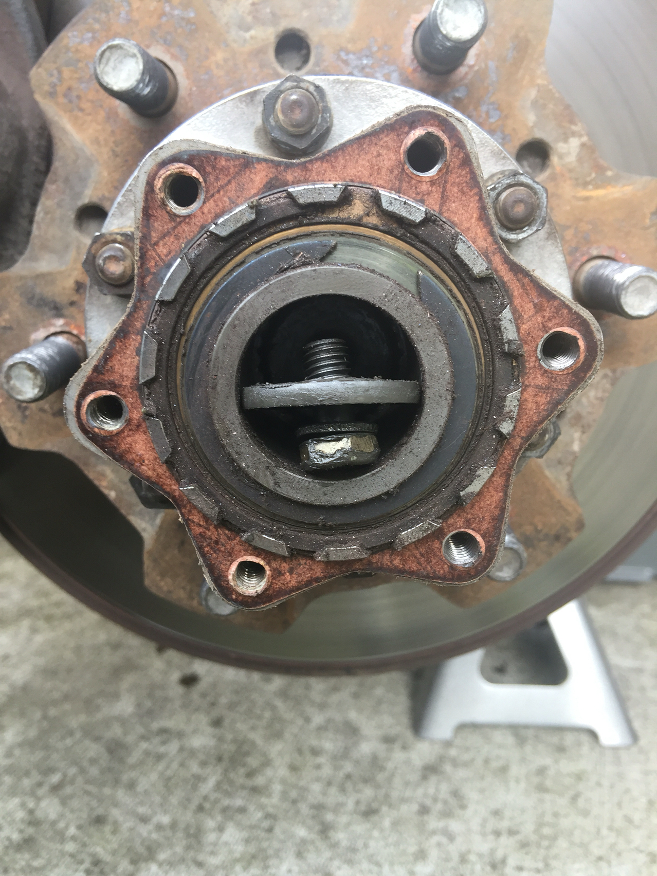

So went to get a alignment guy wouldn't touch it because all my steering components are to loose and worn so I need new pitman idler wheel bearings. Wasn't the ball joints wasn't the cv joint but the axle it self was not bolted inside the hub Attachment 103738 any one got brands they like to replace ifs parts with besides sas!! Haha I wish. Any upgraded pieces

Will check that out thank you. I need bearings too there not loud just not in great shape gonna fix all the kinks out down there hopefully have something going by next week and I'll add this to my build page thanks for helping. Let's try the pic againWheel sound not a bearing not a shock mount.-photo44.jpg
