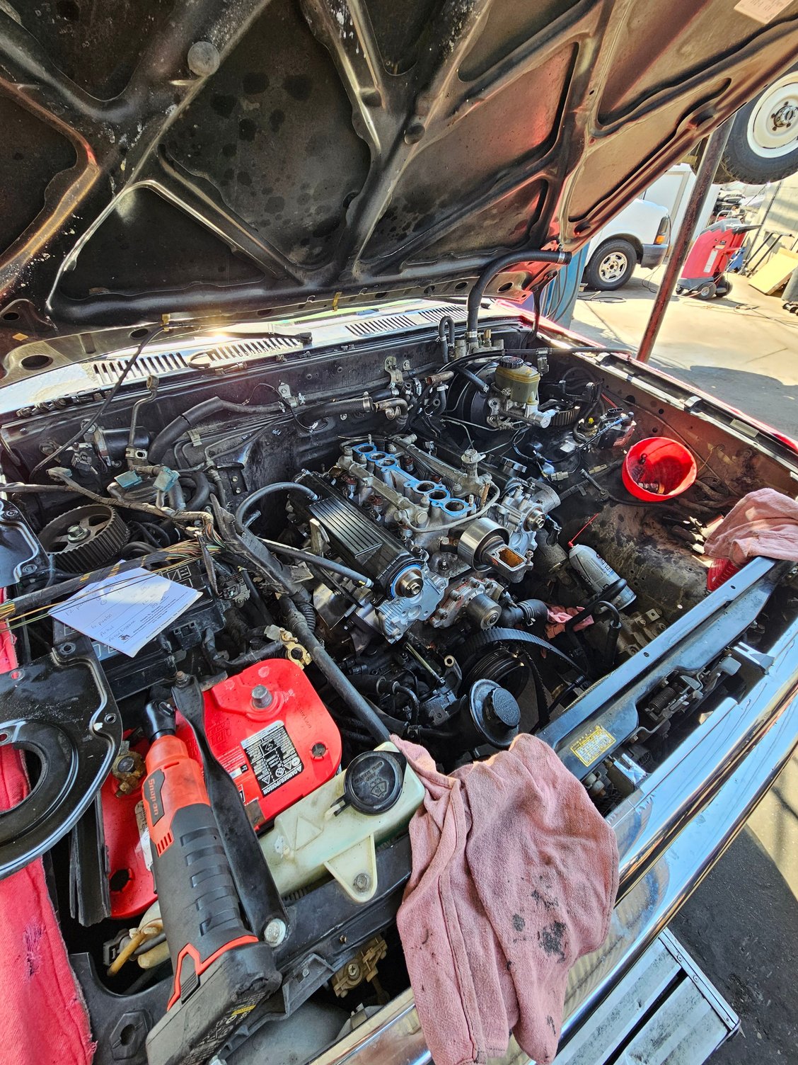

What's up duders. I recently purchased a '94 4 runner 5sp manual 3.0 with 186k original miles from its original owner. A rare find for only 3k. I had saved up funds because I thought I'd spend way more money on it originally. I have seen many posts about the 3.4 swap, but my question is, has anyone tried to swap the 3.0 with the 2F 4.2 inline six? Or should I just flip this truck for the money and buy a land cruiser. I really love the 2nd Gen 4 Rnner body and would hate to see it go. Let me know what you think

Got impatient and I'm a glutton for punishment. Decided to just tear it down and rebuild. Maybe In the future I'll consider the 5vze. Before I bought this I had 99 tacoma with the 5vze that gave me 17 years and 350k miles. Sold it 15k. I was just looking for something different, not necessarily speed, because after all it does look cooler offroad the slower you go. I'll keep you updated 🤙🏼 thanks for the input.
I might just drive the 3vze until it blows up on me.
