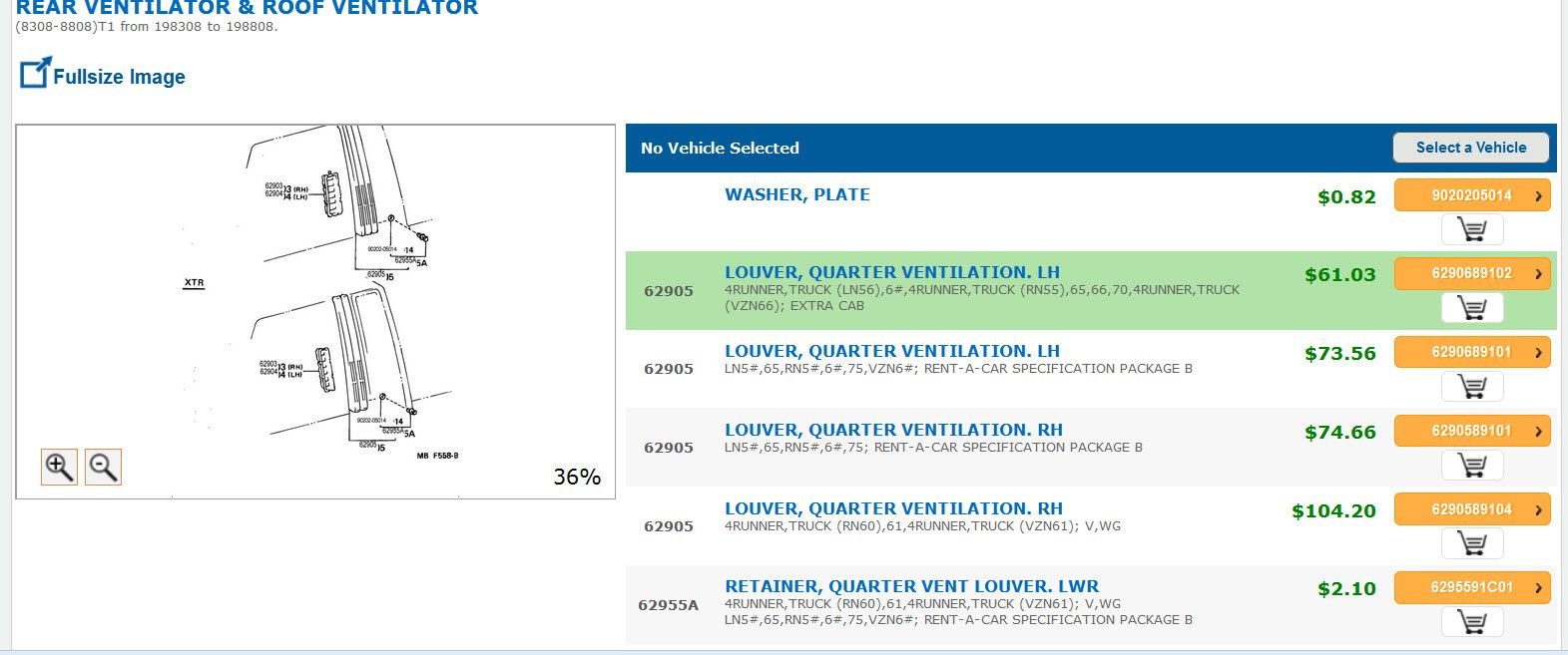

http://www.toyotapartsoverstock.com/...ssembly=529811

Yikes 60 bucks. I wounder if i could find it at the bone yard? Probably not for a 30 year old truck.
Thank you for the info on what it is called.

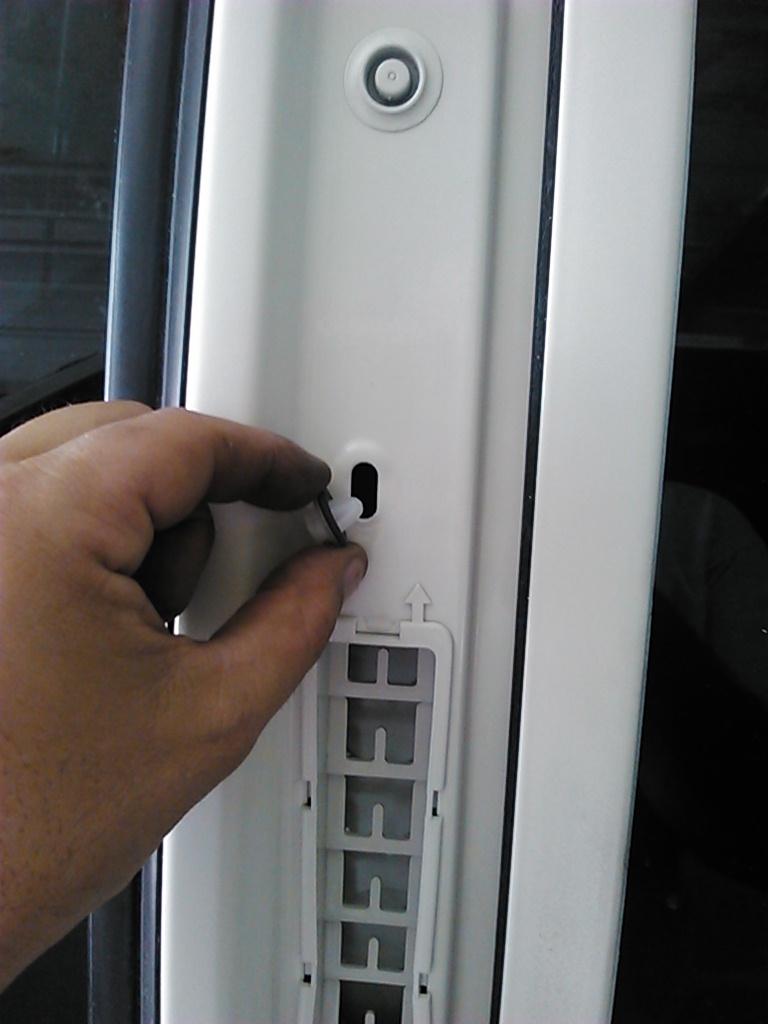

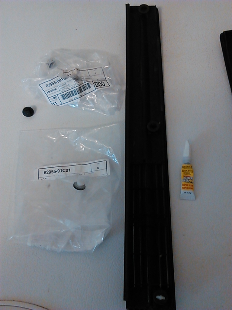

Just so I will have the numbers at a future time. It take 2 clips PN# 62955-89101 for the top and middle of the side trim. 1 clip at the bottom of the trim PN#62955-91C01. They look similar but are not interchangable. No way of getting them out without breaking them. They have to be replaced. 4Runners use twice as many of the above clips. Prices are reasonable at Toyota but you maybe able to find them on ebay or an autobody parts store.
I put a dab of super glue to help hold the rubber strips on. Not needed but it is such a small amount and it keeps them from sliding down and easier to install. There is a little lip that sticks out. Pay attention to how you remove the rubber strip to install it right.
