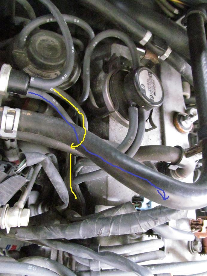

Can someone please tell me what the name of the part I am pointing too in the picture is?

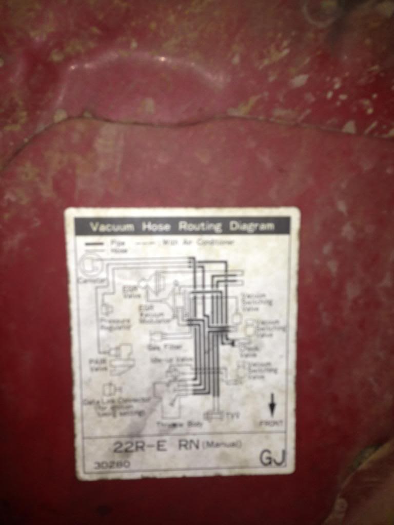

It has 3 spots for a vacuum line to come off at 2 of which have a hose on them and the third one does not. I can't find another spot where there is a missing vacuum line so I don't know. I tried looking at my Vac line diagram and since I don't know the name of the part its hard to tell I took a pic of the diagram too (kinda blurry) but its the basic diagram for a 93 22re 5 speed.

More to the point the spot on the part I'm pointing too that does not have a vac line is sucking in air and I have a mild idle surge (up n down) once my truck is warmed up, of course this is made worse when the brake is depressed. All help is greatly appreciated.

It's just a vacuum port. One line goes to the VSV for the PAIR valve. The other goes to the VSV for the fuel pressure regulator.
I seen people that mess with their vacuum line put the EGR on that port too. However, the EGR is actually coming off of the ports at the throttle body.
I only have two vacuum line coming off of mine. I think your good.

The top most port goes to the large black canister on the fire wall (a long hose). The rear most one goes down and connects to one of the metal tubes next to the cam cover. The forward most one goes to the plate on the cam cover next to the blue electrical connector.
Look at the diagram on the hood closely it's all there.
