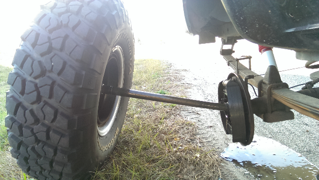

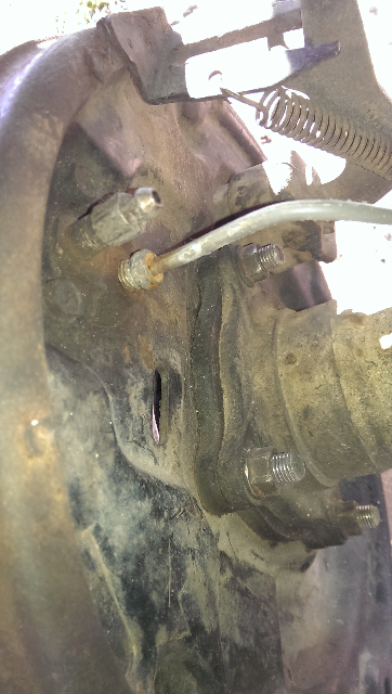

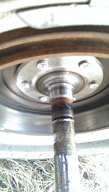

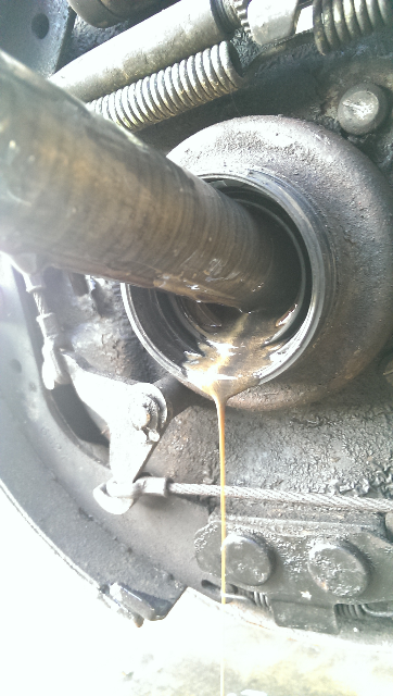

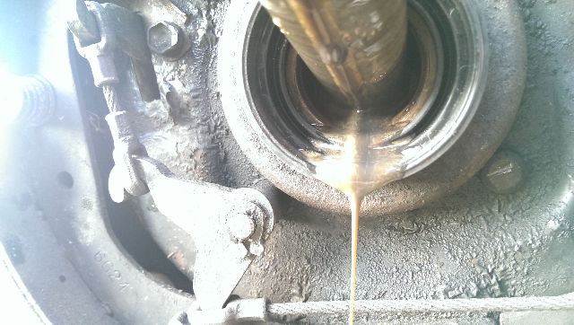

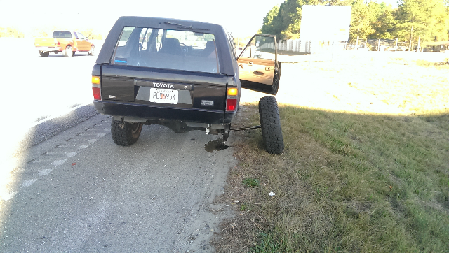

1986 4runner. Axle broke 3 weeks ago and had a shop put a new axle and bearings on. Been driving it for about a week. This morning took a drive to drop my daughter off at school. Turn to get on the interstate and this happened. Any ideas from the pics as to what exactly broke or came loose? It is at the shop now that repaired it the first time. Want to know if you think its something they did wrong or didn't do that they were supposed to do. Thanks

Looks like the bearing failed to stay on the axle. I only use OEM bearings, retainers and c-clips. Never had one fail like that. So, either they forgot the retainer and ring or the actual axle shaft is bad, meaning the bearing mating surface is out of tolerance. These bearings are pressed on and off.

The c-clip is missing (pic 3 and 6), but it is probably still inside the axle housing. Seems unlikely you could drive it even for one week without a c-clip at all. You might ask if the bearing retainer was replaced. That's the part the c-clip rides on, and if it had been damaged when you broke the axle the damaged part might have pushed off the c-clip.
