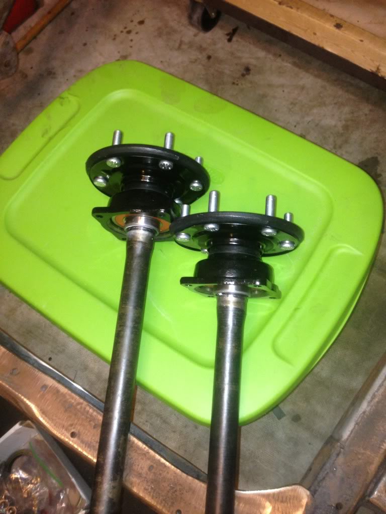

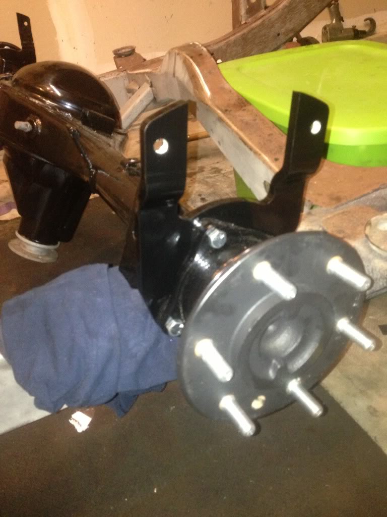

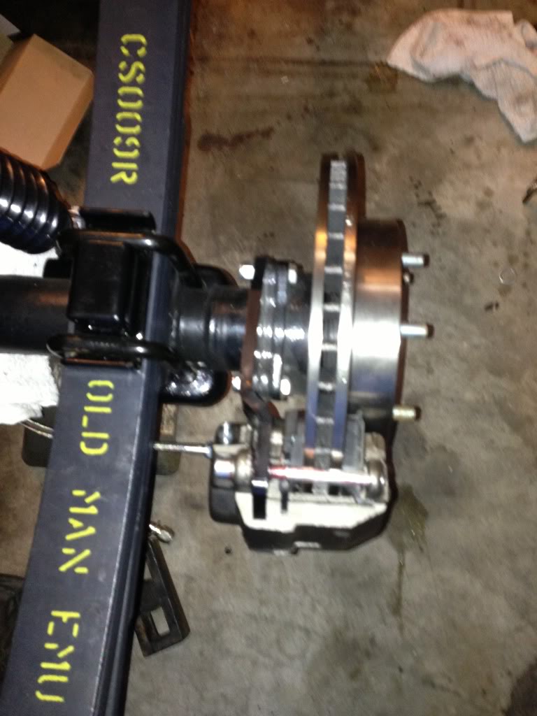

Here is a picture of my axles if you aren't familiar with how they go together - notice the c-clip and the collar between the c-clip and bearing. The whole axle slides into the axle housing and four bolts bolt through the bearing cup to the axle housing. The actual bearing cup pretty much holds the axle in place while the clip just keeps the axle from sliding out. The c-clip can be a weak point in very extreme conditions, but for daily driving there is very very little chance of failing.
