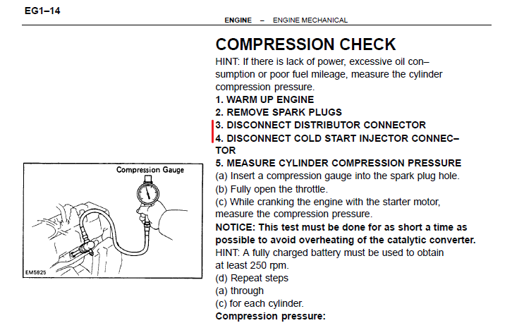

This happened at the time I did the compression test. Before initializing the test, I unplugged the ignition coil high tension cord from the ignition coil but forgot to unplug the cold start injector connector. I cranked it to check it would not start (which it didn't) and was about to proceed to remove the spark plugs, when I realized it would be best to warm the engine for a better compression reading. I plugged everything back as was before, turned to key to start the engine, only to hear it cranking but starting no more.
What the hell? It did start flawlessly a few days before this. Could having cranked the engine with only the ignition coil unplugged, but not the cold start injector, somehow altered the starting system?

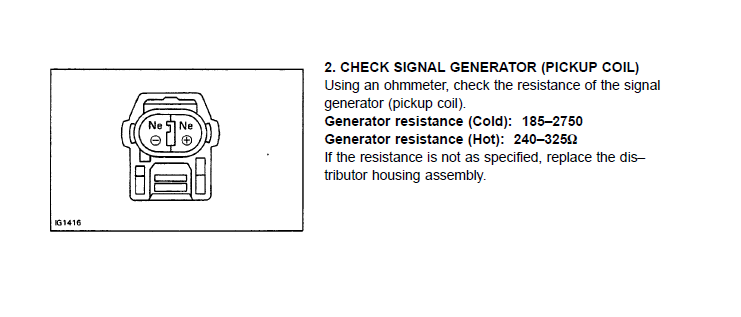

5.- ¿Could someone please indicate to me where exactly is the pickup coil located?

If those are "cold" readings on the igntion coil, the coil is out of spec & should be replaced. Your Primary Resistance is 3 times what it should be, and you Secondary reading is well past average but even with this, the coil will still produce spark when cold (not subjected to engine compartment heat, which will only make the readings higher).
If you are getting spark your Ignition Control Module (Ignitor) is probably working & so is the Pickup Coil. The Pickup Coil is located in the distributor.

The proper procedure for a 22RE(RTE) is to disconnect the EFI fuse (cuts power to ECU, VAFM.. No fuel pump, no injectors firing), and to disconnect the distributor mounted pickup (NE signal, which disables spark).
What you have been doing is firing the ignition coil with nothing for it to drain the high power into, this means it's only output path is to arc across its internal connection and cause damage. As well as firing the primary fuel injectors..
You shouldn't be worried about if you can make it run at this point, you're risking damaging engine internal parts. Depending how bad your head gasket leak is you could hydrolock the cylinder, water is not compressible. This can do very bad things like bend/stress connecting rods, and then you're not just replacing a head gasket but worst case buying a new engine block because the rod broke and poked a hole in it.

I followed the FSM manual, which states to only disconnect the distributor connector and the cold start injector connector (which I forgot to do).
It does sound logical to remove the EFI fuse, though. I'll keep in mind that for future situations!

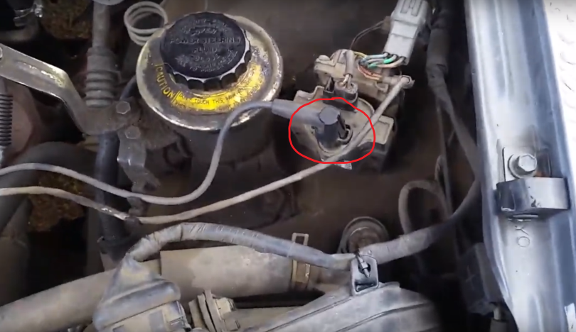

Originally Posted by old87yota
Co_94_PU brings up a good point about the ignition coil. Just what did you unplug?
This:

Well hell, I just can't find it. I have looked repeated times inside the distributor, removing the cap, and I nowhere do I see anything which remotely resembles THIS:

The connector should be outside the distributor. http://web.archive.org/web/201101242.../5distribu.pdf
