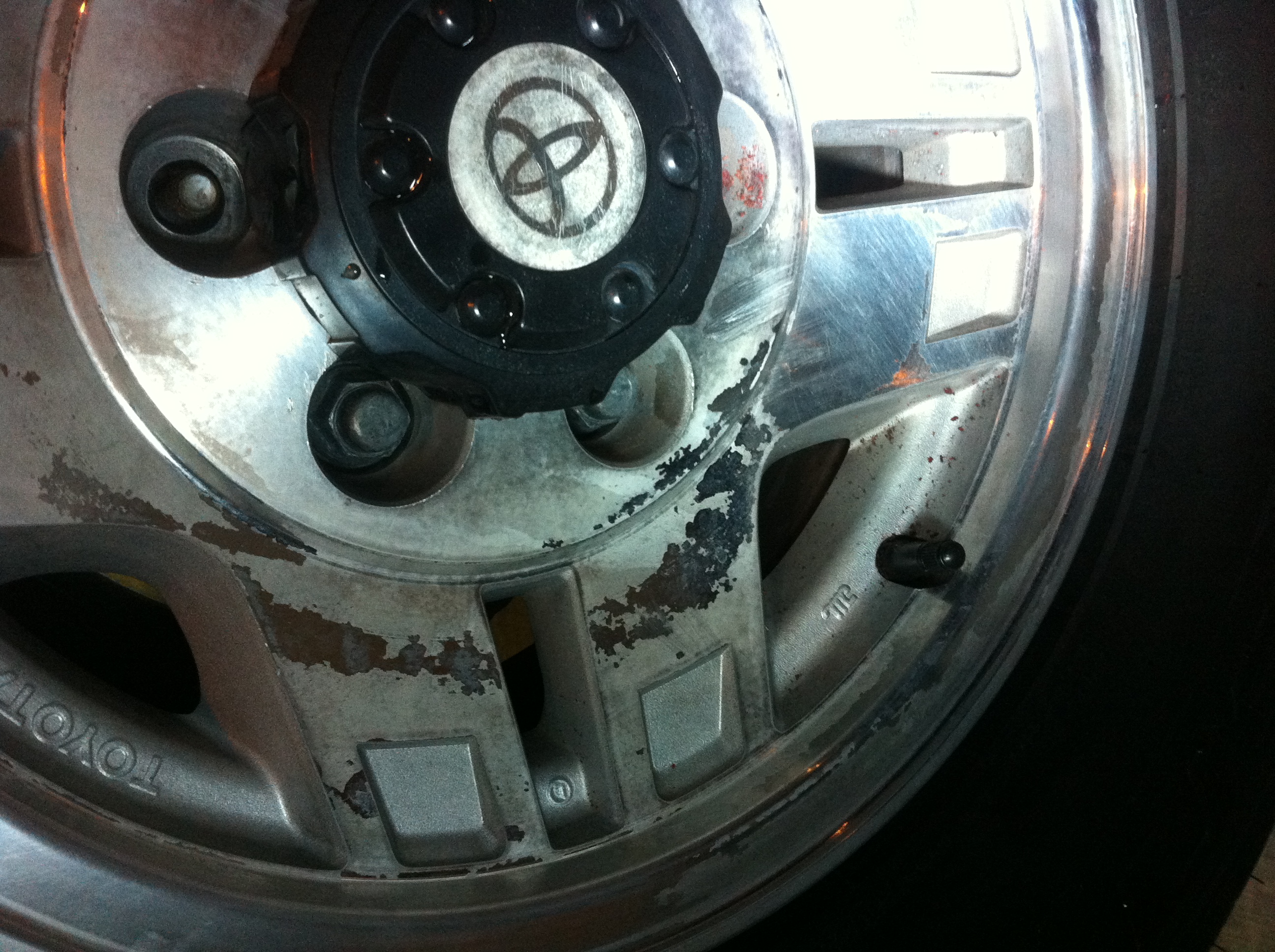

I've had my truck sitting in my driveway for 4 years and once I go to clean it my rims do THIS!!!

Weather, elements etc etc etc, its outside sitting that's what happened what were you cleaning it with and what kind of solution? Almost looks wire brushed or something?

the clear coat is coming off. my wheels looked like that when i bought it.
i wet sanded the clear coating off and polished mine.
easier said than done i'm afraid, i did mine by hand for a better finish (about 40 hours) and buffed them out with a polishing wheel on a die grinder.
you have to go over them with metal polish, like waxing the paint.

I have not tried it myself buy I have heard that aircraft paint remover will take the clearcoat off very quickly without damaging the aluminum. I could be wrong though.

It looks like chrome underneath the paint, am i wrong?

yea, the "chrome" look is the clear that is still intact.
the wheels are aluminum. you can polish them to shine like chrome, you could clear powdercoat them to reduce maintanance time.

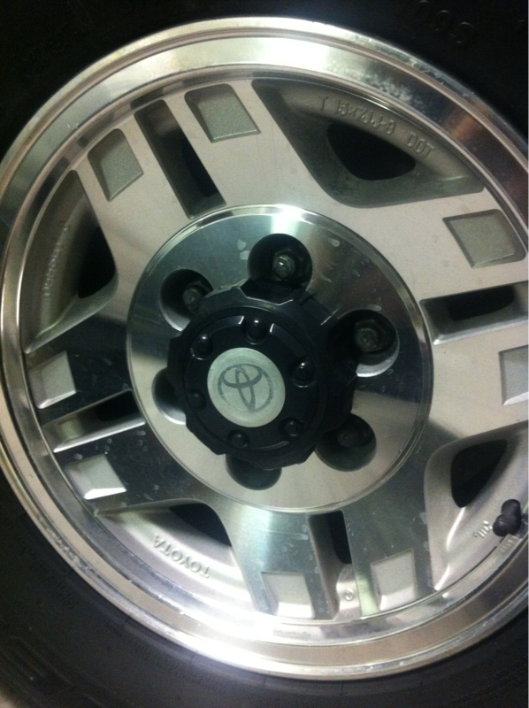

HOLY CRAP!!! You were right, aircraft paint stipper.
I tried the paint stipper and the clear coat peeler.
The clear coat peeler will remove clear coat without damaging the primer coat.
Since this is aluminum and not a hood... I first used the peeler, then the stripper.
The stipper definately worked better since it doesn't hold back in clearing primer and paint and such.
Anyways, the results were IMMACULATE!!! Spray on, wait 5 minutes, wash off... NEW WHEELS!!!
Ill post pics to follow of what I used and the after pic

Ta da!!!!

Nice result. Do you need to clear-coat it now?

Yeah I guess so. The more protection the less maintenance right? So I'm going to grab a can of clear coat spray and see how my novice spraying technic goes haha

wow, that stripper really came out clean for just a spray on/hose off approach!
if you're going to be re-clearing your wheels, i would suggest you do a little bit of black accents first, then clear them. had I been able to run my stock SR5 wheels with 33x12.5s, this is what I would have done with them for sure.

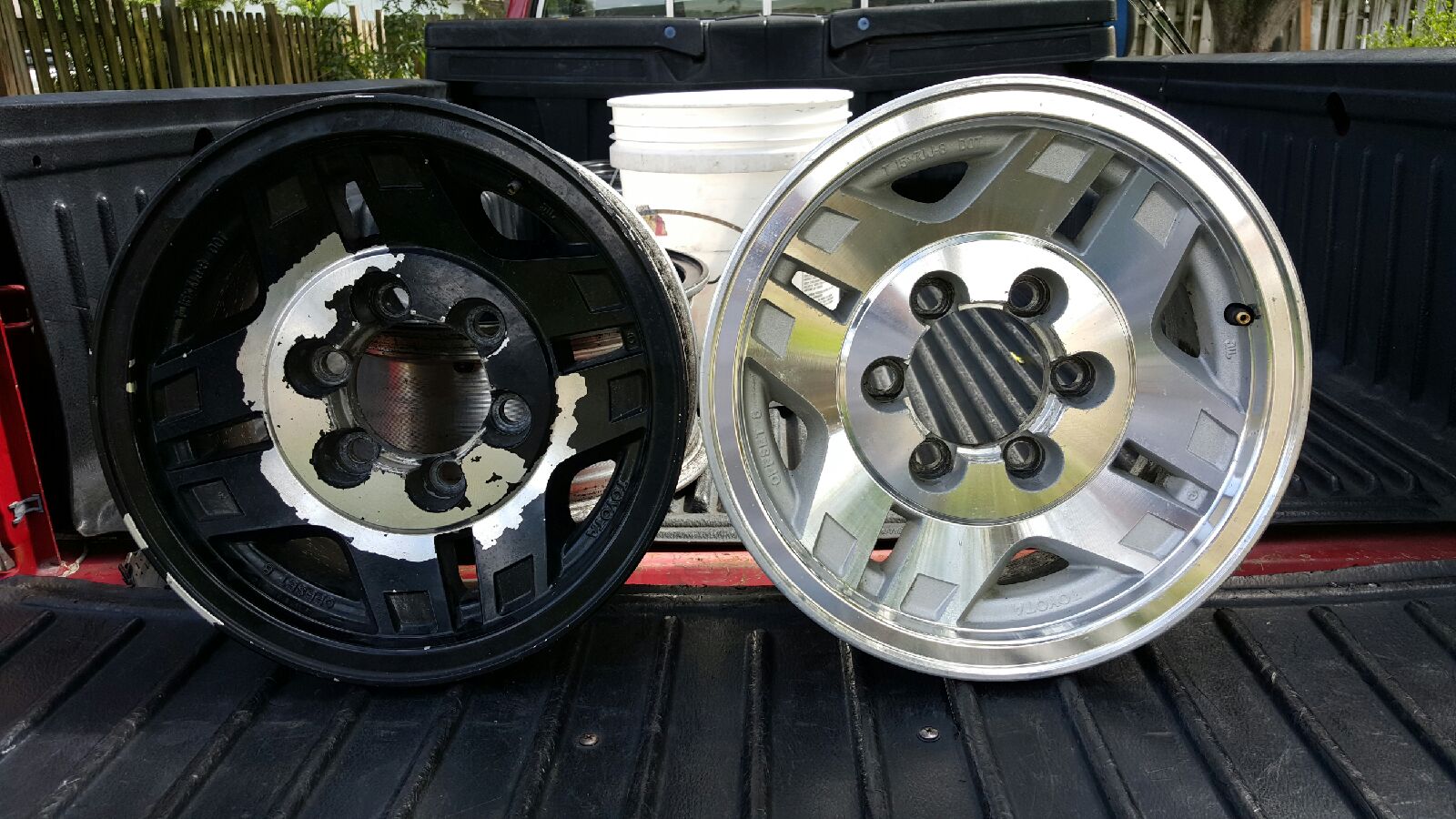

That Aircraft Stripper is no joke!
