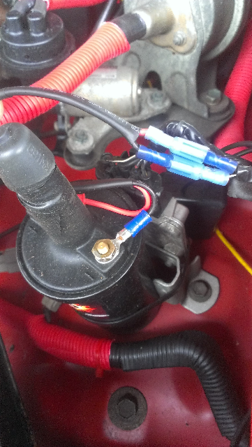

I don't know if they made it or not but that's what its called.
Oh that looks like a good alternative too, where did you put the plug from wiring harness that plugs into the original coil? Not the wire that goes to the distributor cap but the other one?

I cut it off and put male and female connections on them so I can just plug the old one in if I need to.

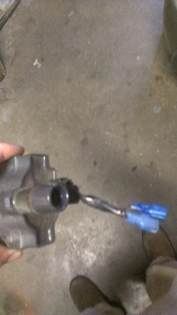

That's a good idea! I still don't really see where you connect the wires to once the oem coil is gone? Because the plug on the old coil that the wires connected to is non existent on the new coil? Therefor they have nothing to connect to?

Or do they splice into the red and black wires coming from the top of the new coil in the pic?

Yea there is two wires off the oem coil one is ground one is + and you just splice them and put connectors on them.
Okay yeah Its obvious now looking at the picture lol where'd you get the coil from?
