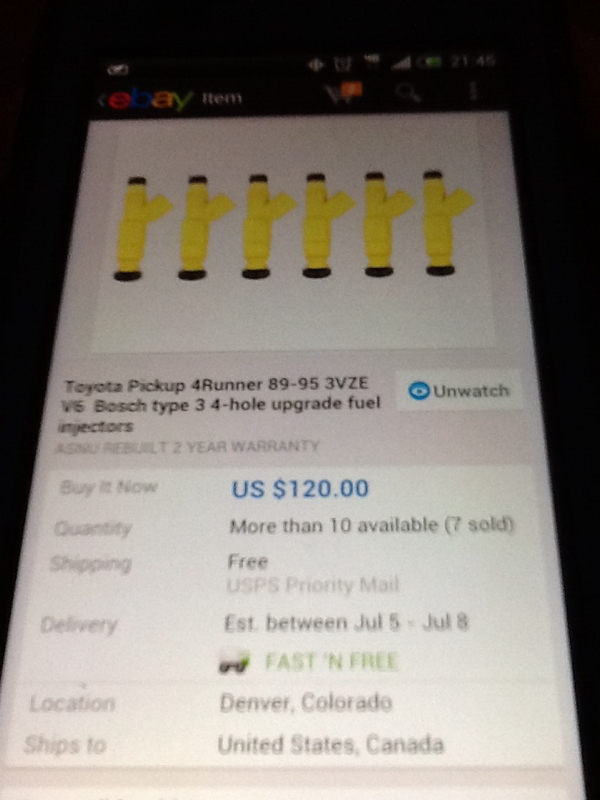

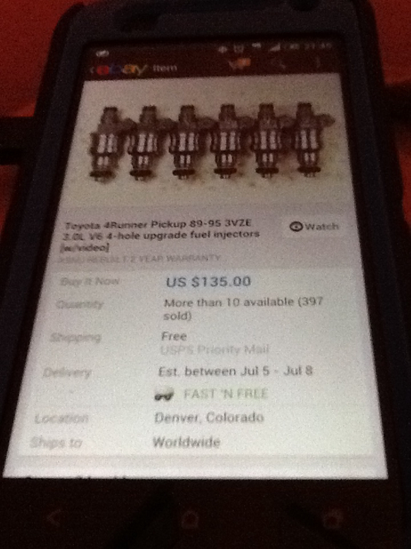

I am about to get a set of flamethrower injectors for my 3vze. I already have a cold air intake and the 7mge afm on it which i love..... I don't know what injectors will work better and what is the difference between the two?

Ok thanks I will call them. Does anyone have any experience with both of them? Woundering what effects each of them have on people's vehicles

Ask flamethrower about the flow rates of each. Decide if you want MORE fuel and want to adjust parts of your electronics to accommodate, or you want something the car's engine can handle on it's own.

Not entirely true. The ECU will adjust to a certain percentage of flow differential from stock.
I put the tan ones in my 3vze, and I don't need an adjustment to the AFM.

the gray (Bosch type 2) injectors flow somewhere around 8% more than stock. this has given a few people problems in the past.
the tan/yellow injectors flow within 2% of stock so there should be no problems or adjustments to be made. and the tan injectors are a later design (Bosch type 3) that is more consistent injector-to-injector and they are less prone to injector deposits.
i recommend the tan injectors. i have them at a low price at the moment because i am still rolling them out and i am still working on the videos i will have for them.

Ok thank you. i will be buying the tan ones then.

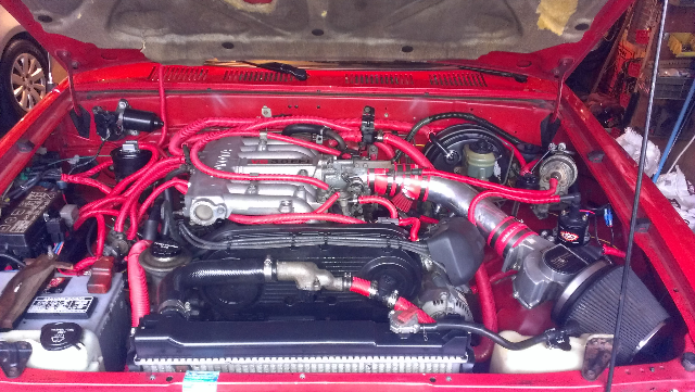

This is my engine compartment with cold air and 7mge afm

I also did the egr and pair valve del on it and took some hard pipe out that I didn't need after.

Wow that thing looks clean!! I have a cold air intake, flamethrowers, and egr delete also. Can't wait to get my supra afm and coil.. did you do the same to block off the pair as the egr?

I welded the holes on the mounting plates closed on mine
