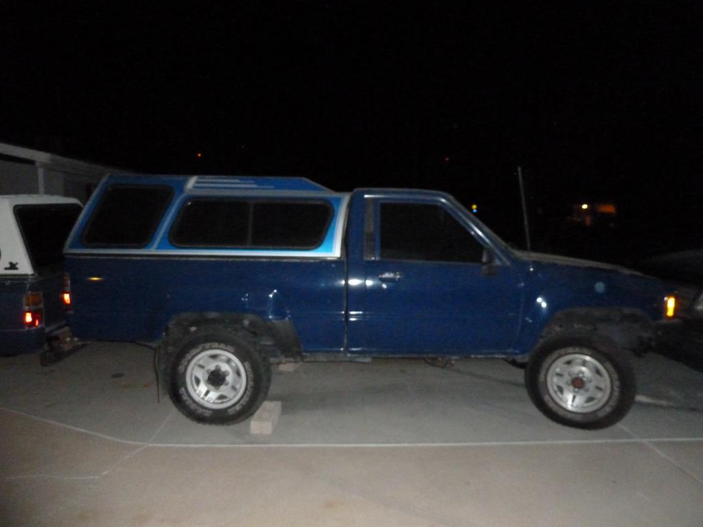

Old Sep 27, 2014 | 07:46 PM
greyheadedguy's Avatar
Joined: May 2013
Posts: 260
From: Arizona Desert
I GOT IT!!! My new Buddy! :
Better pictures to come...
