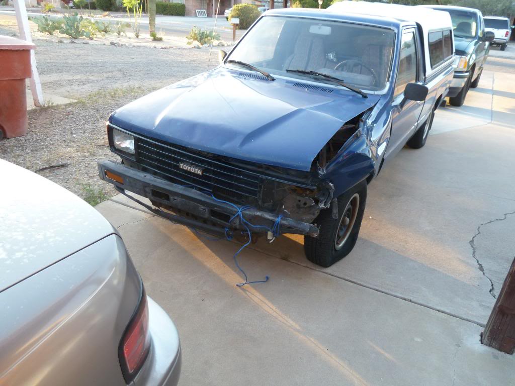

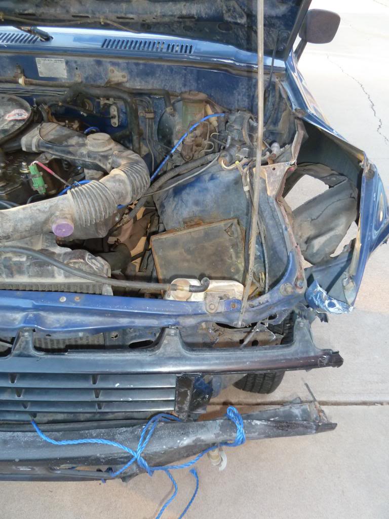

My beloved 85 Toyota truck was hit in the drivers front wheel with the front wheel and the rest of a Geo Metro doing 40 MPH. The other car blew through a red light and hit me I was getting ready to turn left. The grill, driver side fender, inside fender, bumper and hood is damaged and the frame bent downward. The force of the impact has lifted the engine a little making it idle very fast. Oh, there is damage to the suspension and steering linkage. After the accident I used a come-a-long and pulled the carnage off the front wheel and drove the truck home.
After getting the truck home and looking at it, the inside fender is the worst part of the damage, after straightening the frame. What is the best way of going about to fixing my truck. There is no damage beyond the fender that I can tell. If it will help I'll jack the truck up and get some pictures of the frame damage.
Thanks for any help you can give me.
Here is the side view of the damage, you can't tell from here but the space is still even all the way around the door.

A look under the hood and the damage to the fender:

get a front clip from a donor truck, cut and replace.
or try hooking a chain to it and pullng it out, but that buckle is pretty good

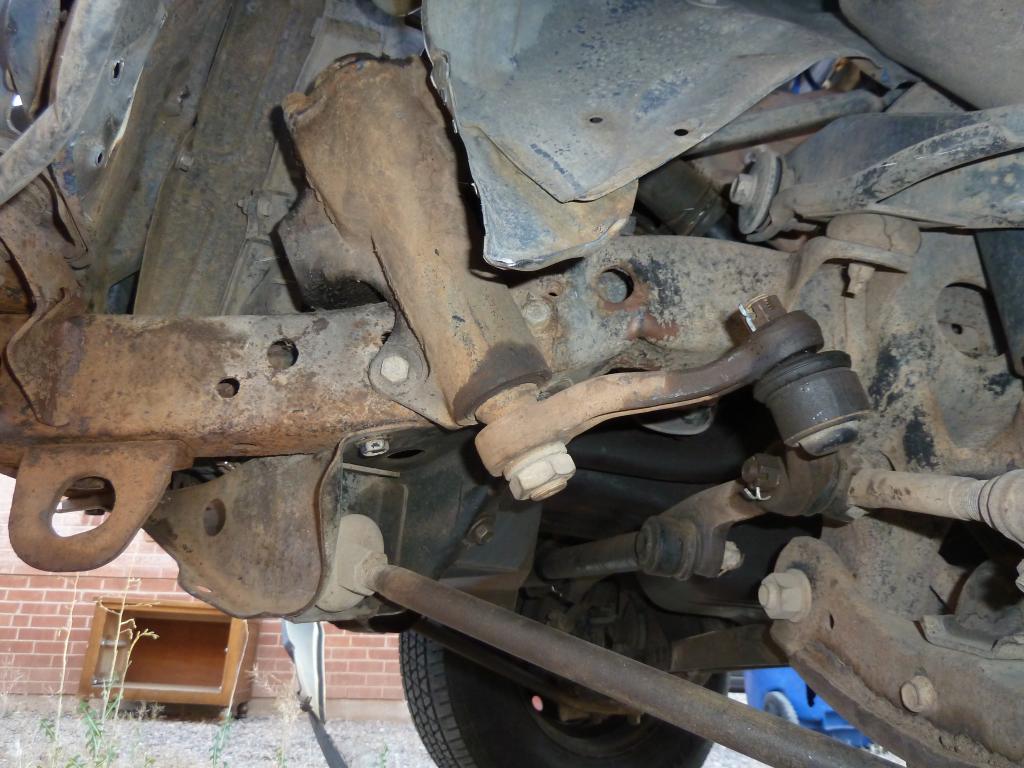

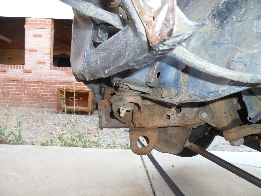

The accident shoved the drivers front wheel back almost 2" compared to the passenger side.
Picture of the frame damage:
Notice damage above the tow point as well as the kink where the frame rises to go over the link age.
