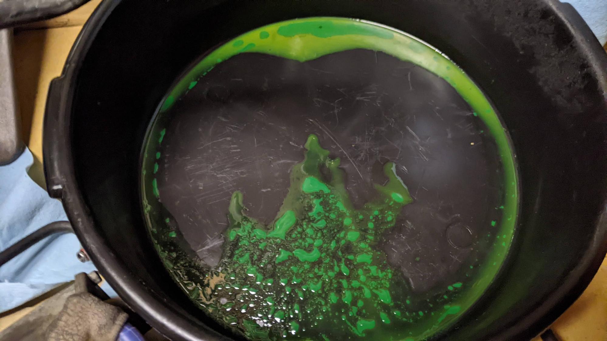

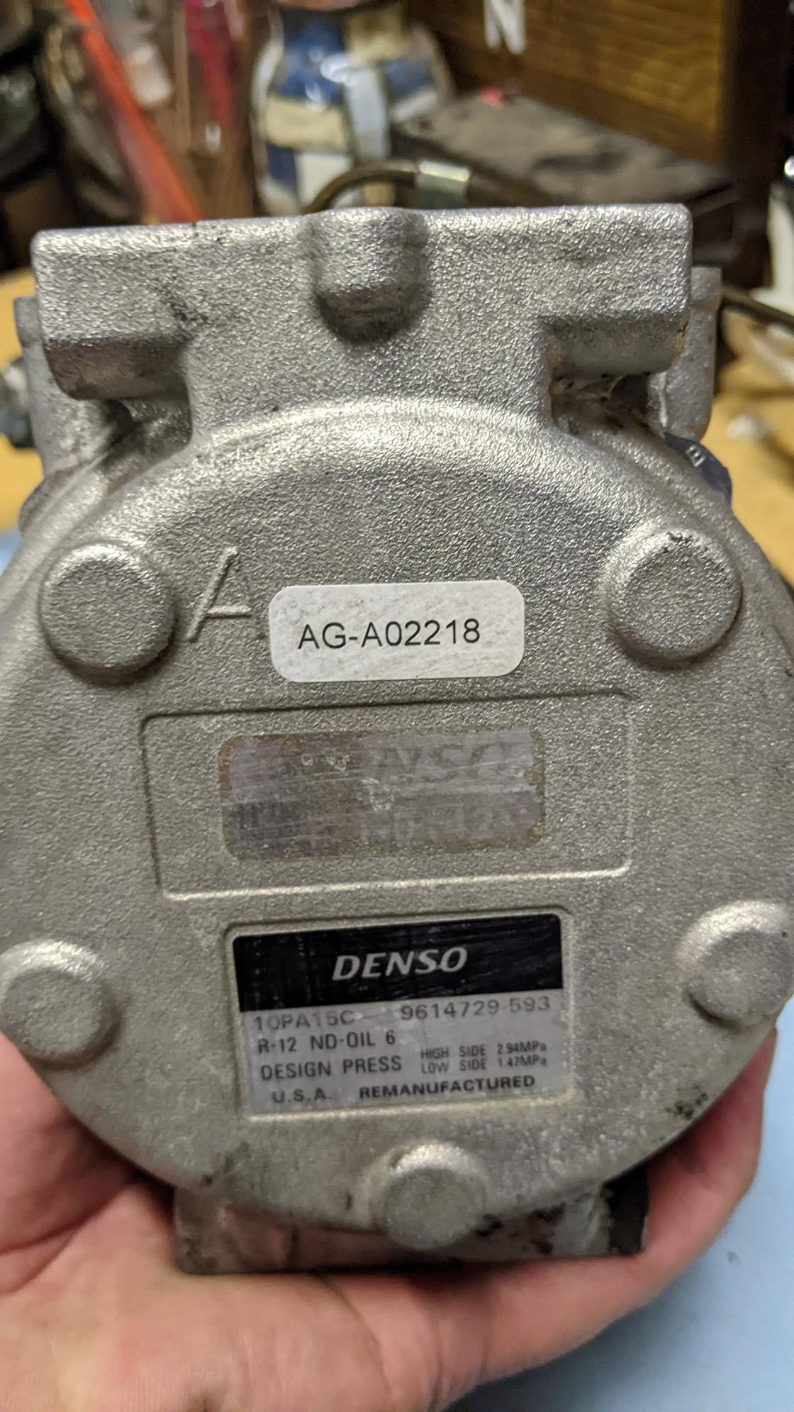

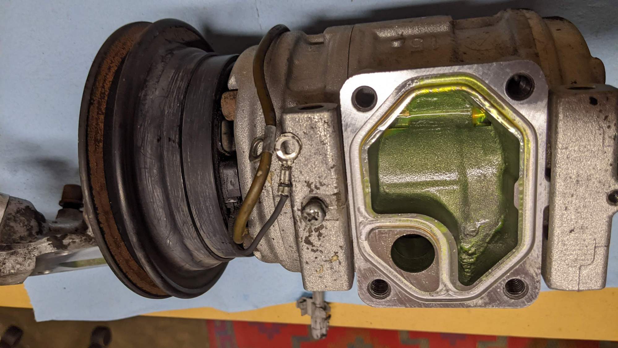

A/C Compressor turns smoothly and has great resistance when blocking the low-side port. No signs of metal shavings in the oil. Magnetic clutch engages when energized and spins with the pulley.
Inside top of compressor
What came out of the compressor. Fortunately, no metal shavings.

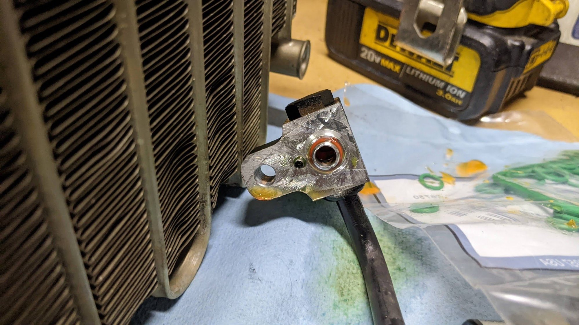

High Pressure side expansion valve with goop and some spherical clumps in it.
Orange oil in some parts of the A/C system?

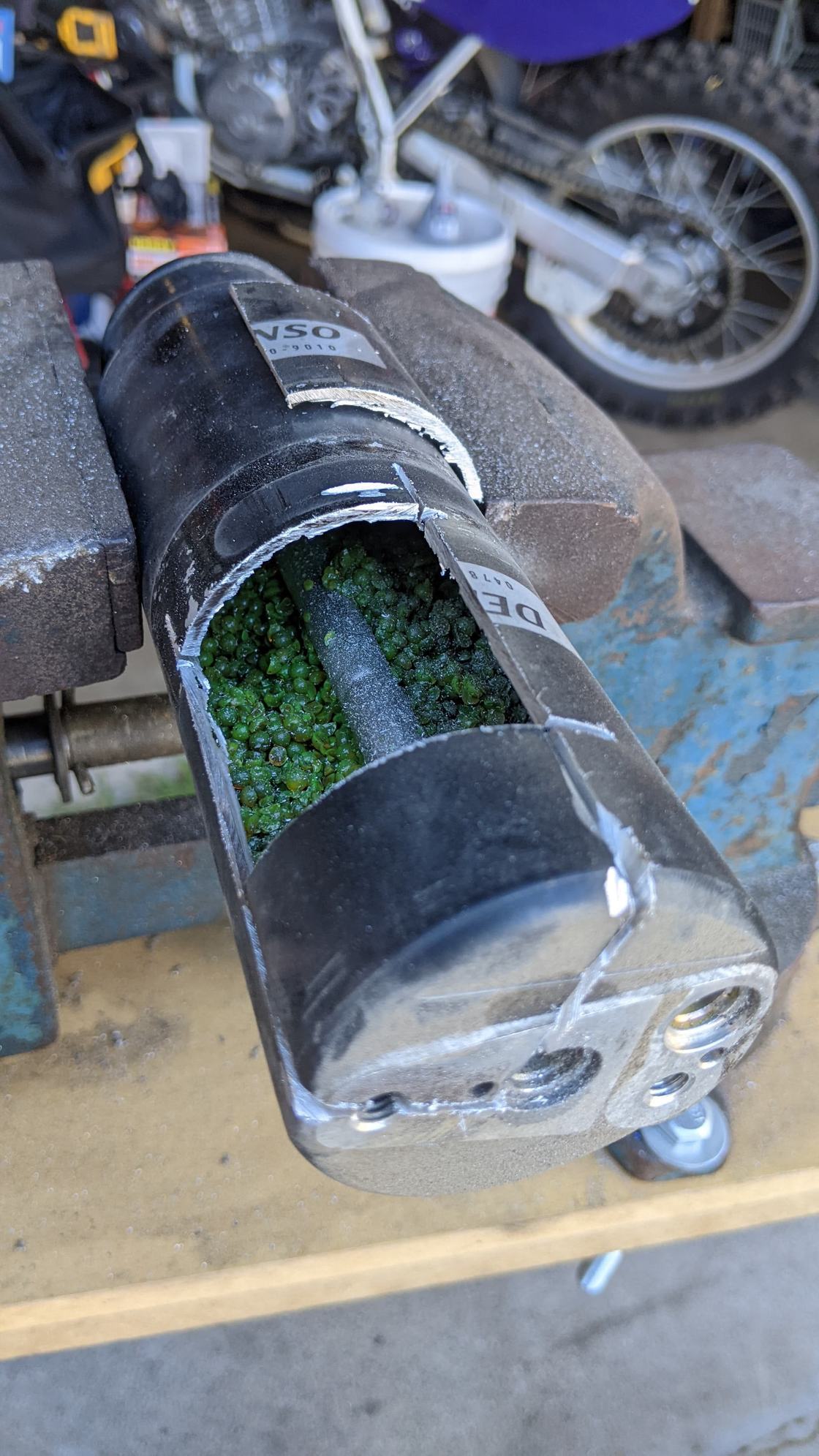

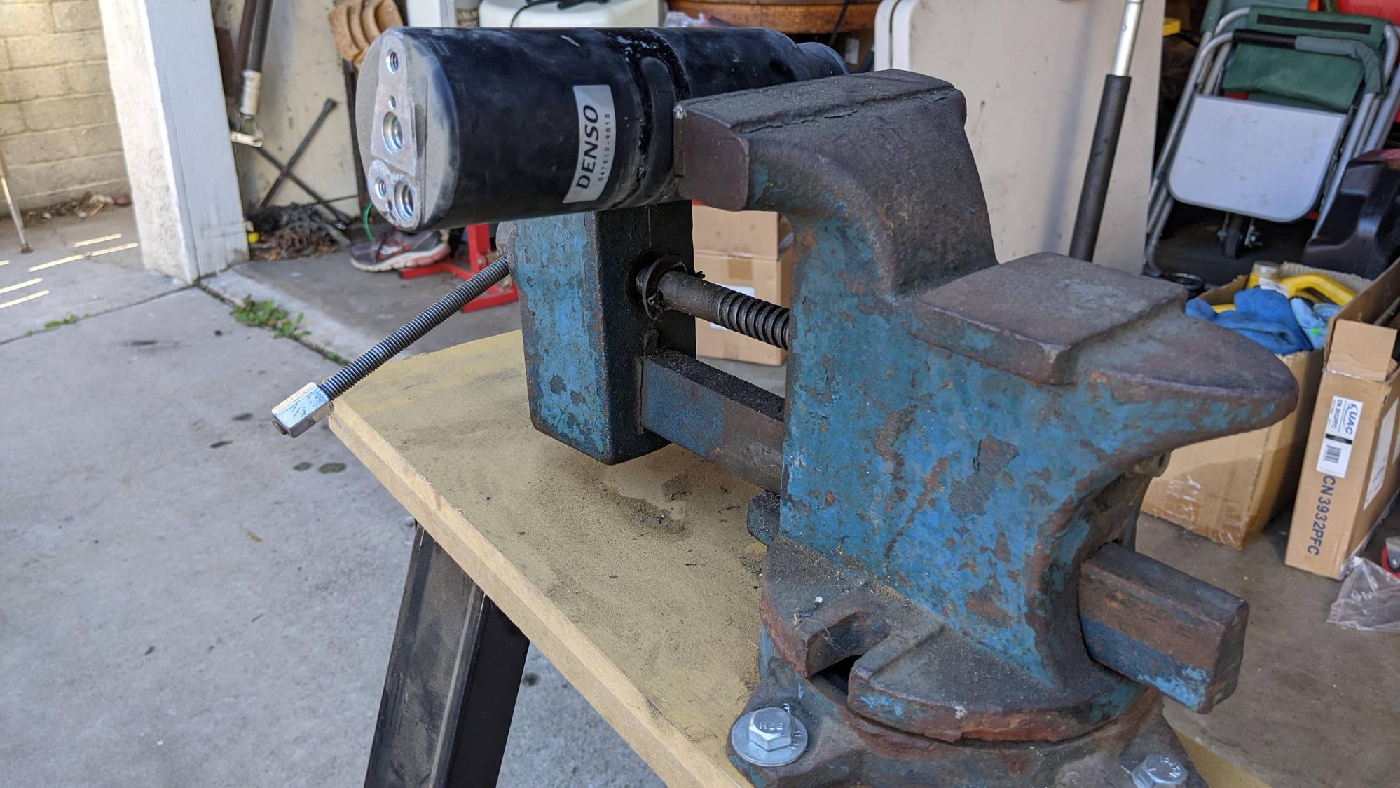

So I took the grinder with cutting wheel to the receiver and found this inside. Looks like the desiccant broke apart and clogged up the expansion valve. Any idea why this would happen?
I do recall the neighborhood mechanic did not replace the receiver. I thought that was odd since I've heard every time the A/C system is exposed to air, you must replace the receiver. I even had one on hand and asked him to replace it, but he assured me it wasn't necessary. I should have been more persuasive.
Cut open receiver. Looks like the desiccant escaped and clogged the expansion valve.
I ordered a replacement Denso Receiver 478-0107.

There should be some sort of mesh that holds the dessicant.
Sometimes the dessicant is held in some sort of bag; other times there is screening at the refrigerant entrance and exit points.
Sometimes both. Belt and suspenders, I guess.
Is your dryer a genuine factory part??

It's screening on both sides. The side towards the expansion valve failed and the center pipe has a few bits of desiccant in there. It states it's a Denso 047810-9010 which doesn't seem to be in production so I don't know if it's genuine or not.
Original Denso 047810-9010 Receiver.
Input Screening
Failed Output Screening
