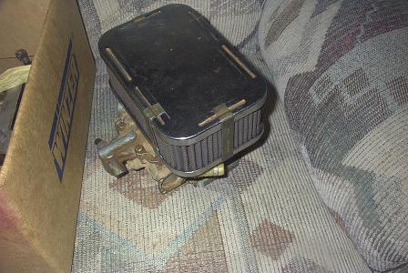

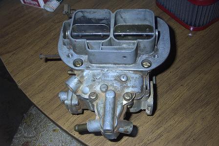

Well i picked up a weber for 40 bucks over the weekend. Its amost new and in great shape. Just wanted to know if anyone had any pointers when installing. Anything to look out for ? I have replaced the stock one before and it was not bad so i know this has to be pretty easy.Any advice will help .Thanks

Here is some pics

first problem I see, has the wrong throttle linkage on it. Kinda looks like a knockoff weber too.

Well the guy had the throttle rigged up so i ordered the adapter kit for throttle, and a new adapter plate and manual choke kit should be in bye weekend or next week. I belive its a real weber says made in spain, and has weber all over it. Who makes the knock off weber?

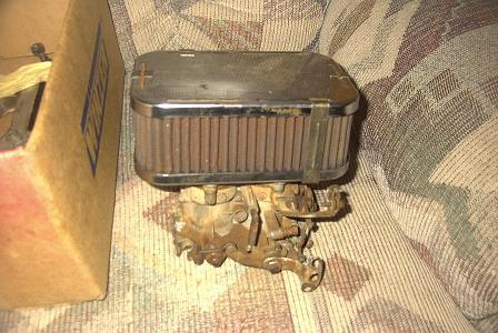

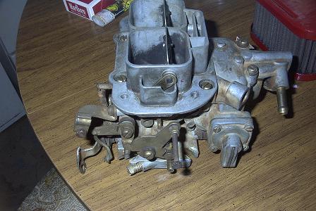

Here a few more pics. Dang xtreme u got me worried its a knock off . ima be mad if it is.

ok nope your good.
