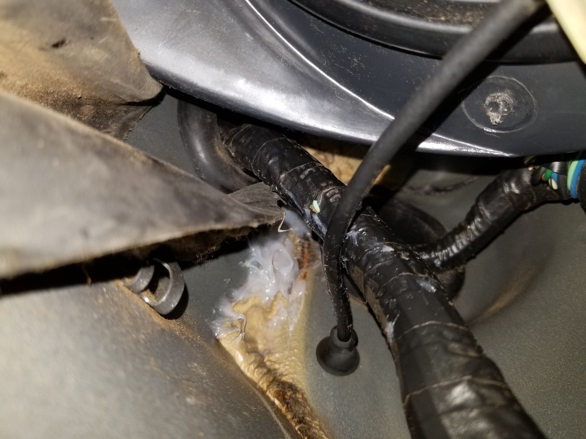

I know the pictures suck but this was the best I can get in the spot it's at. The little wire is the antenna wire and that fat bundle of wires is the wires going to the ecu if that helps any. As best I can tell it runs down that clear silicone I put on yesterday and runs down the old caulking into the floor. It may come even higher where the older caulking is. I will try to get some pictures of the cowl tomorrow when I pull it off.

Can you see if the water is coming in where the fat bundle of wires goes through the grommet?
Old Jul 12, 2017 | 05:16 AM
teepaw's Avatar
Joined: Sep 2016
Posts: 12
no I checked that. It is dry there
