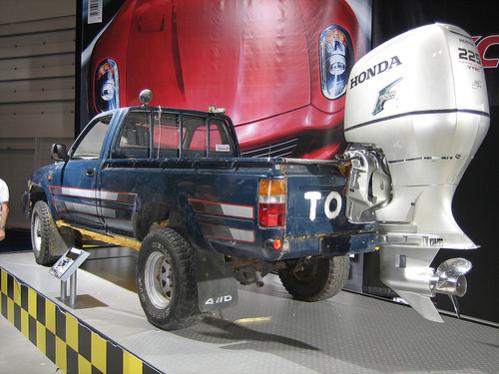

The guys at TOP Gear got the water thing right, just add a honda outboard
