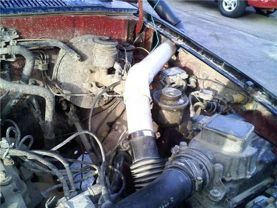

Well changed out all the fluids today, aswell as made myself a snorkel. 30 bucks at the local home supply store. 8feet of 2inch PVC, 2 45deg elbows, and 1 90degree one, and some of that PVC cement. Not to shabby. I'll have pics tommorow, she's not pretty. But it works.

Snorkel installed. Came a out a little further from the fender than I would have liked, but it doesnt stick out farther than the mirror does when it's folded in, so it shouldn't give much of a clearance issue.
Not bad for 30bucks and a can of matte black rustoleum I had lying around.

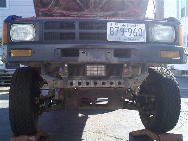

Meanwhile today I fitted a skid plate to the front I ordered from ebay, and forgot to do the diff breathers again!
