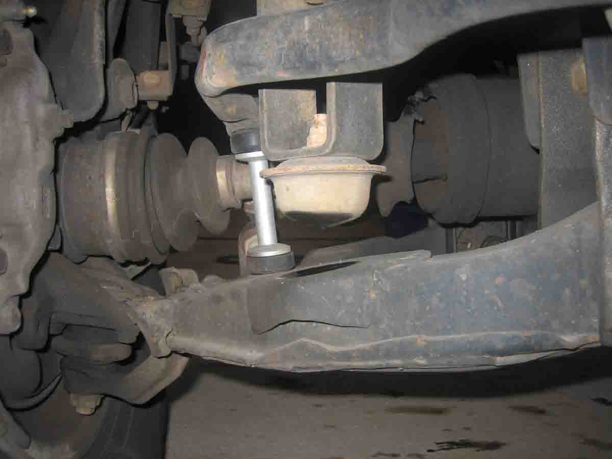

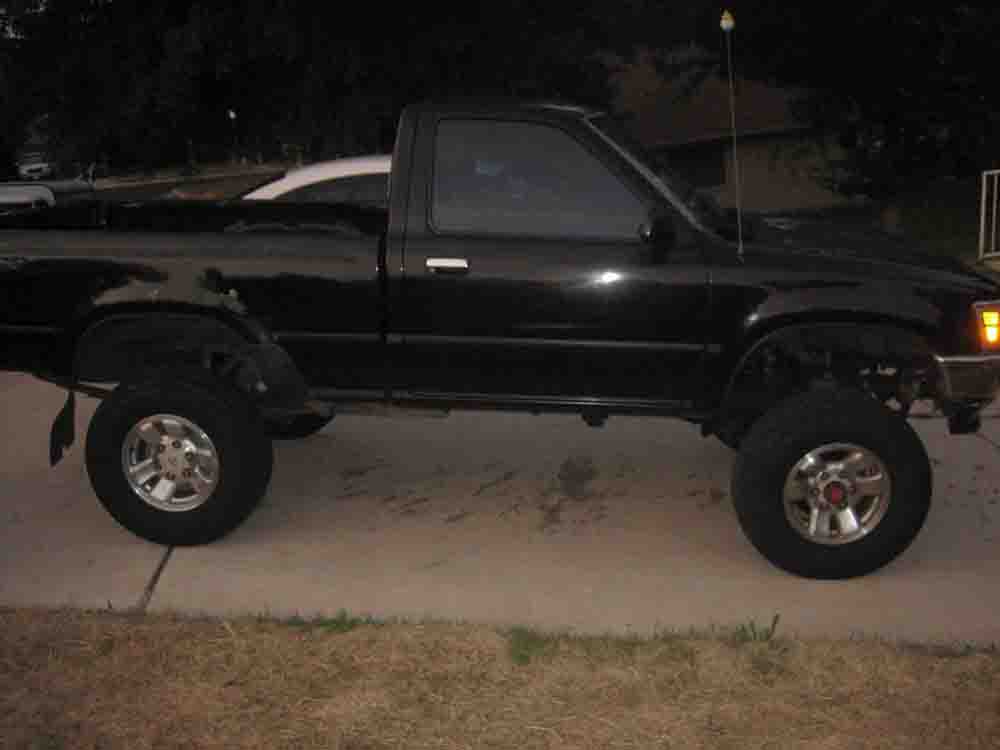

https://www.yotatech.com/attachment....tid=9381&stc=1
this is a full view...it's a crappy pic, had to compress to fit on here. You can see the front has a lot more space than the back.
https://www.yotatech.com/attachment....tid=9382&stc=1
this is the front bump stop. I'm not on a completely flat driveway, but as good as it gets.

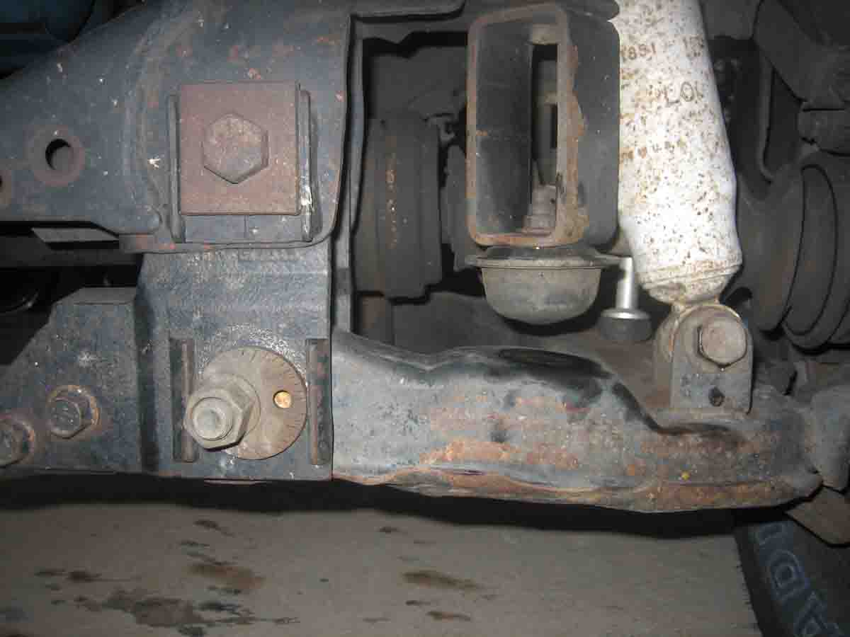

https://www.yotatech.com/attachment....tid=9383&stc=1
this is the rear bump stop. It has a bit more space than the front, is this normal?
I don't know how to put a picture up on a post...can't figure it out. Just click the link.

Yeah looks like you were/are riding on your lower bump stops. Were those before pics or after pics?
Well, your CV angle is certainly better than mine is

Darn...sorry...didn't mention that.....these are the AFTER pics. You can see, the bumpstops have about 1 1/2" space now....before they were about 1/2".....so I RAISED the bumpstops.
Is there a stock height? Or does it matter?
The rear lift looks like about a 3" block, I'm not positive though...but it does sag a little bit, I think...I drove it around the block, and the ride seemed a lot let harsh.
I'll have to do some real bump tests though....
