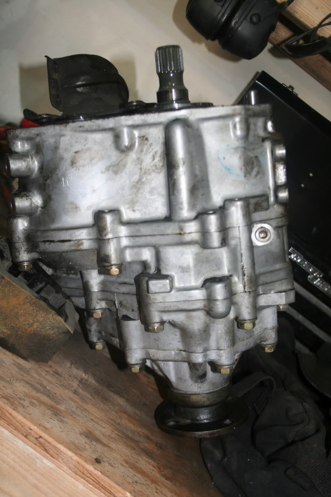

So my new 4runner has a bad reverse gear. When I shift into reverse, I have to hold it in gear, and it clunks loudly trying to throw itself out of gear violently, every rotation. It usually succeeds at popping out of gear rather easily, and when it does will grind until things slow down enough to go back into gear again. I got a transmission I believed to also be a w56 but turns out it is a g58, you can tell by the bolt pattern on the rear end of the transmission, as well as the number of bolts on the shifter. So scrap that idea, cant find any used transmissions locally for a reasonable price that are top shifters... does a forward shifter fit into a 1st gen 4runner?
Anyways, it looks like I have to teach myself how to rebuild a transmission. Anyone know of any good threads / manuals / walkthru's / advice for rebuilding a w56?
Here are some pics- Where is the reverse gear located on this tranny?

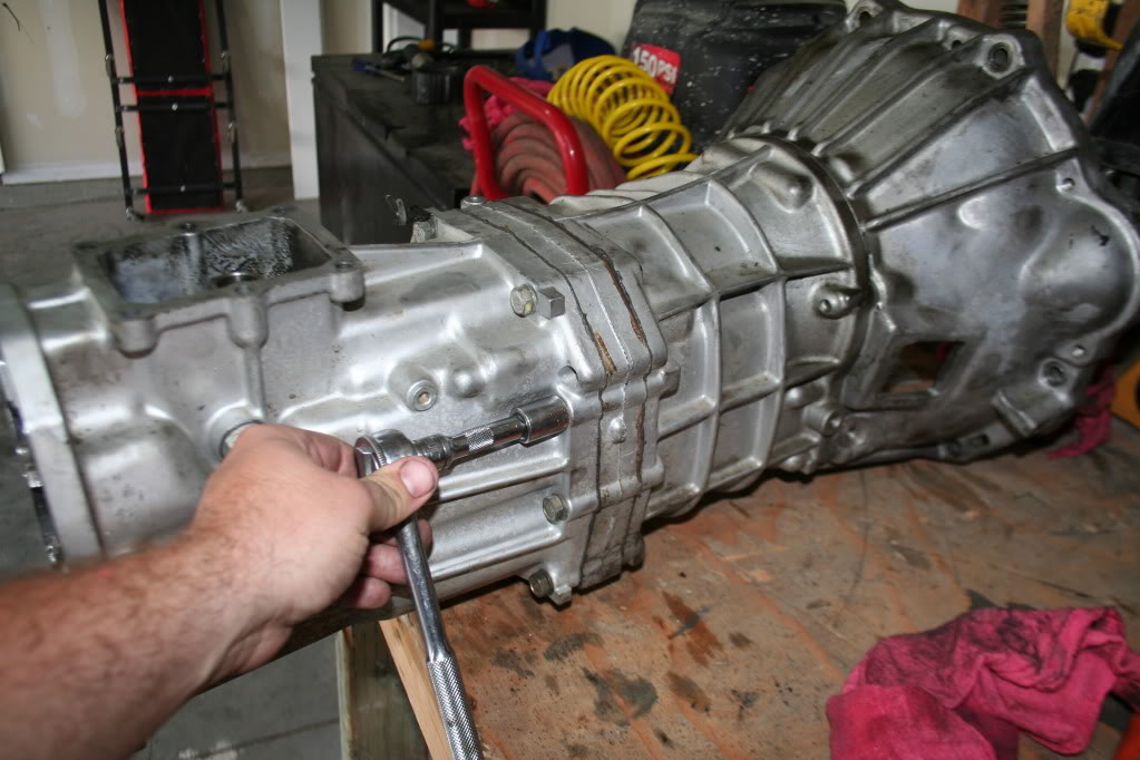

So I got to tear into this thing a little today- dont do what I did and take it apart before draining the oil- its messy when you do it that way. Heres the drainplug.
Drain it...

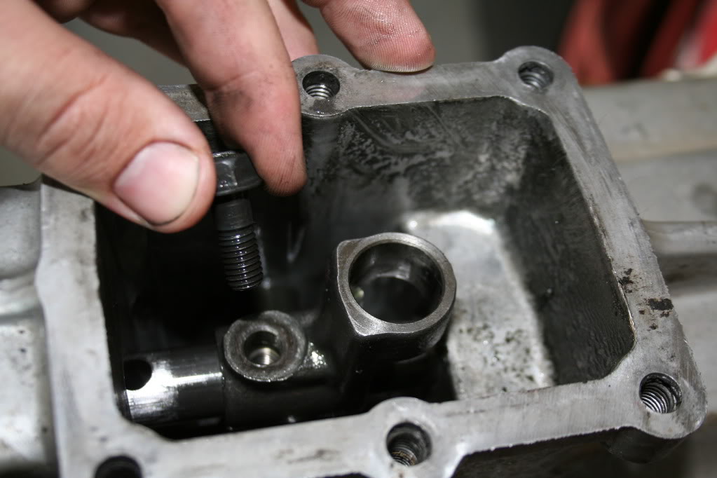

take out this bolt on the shifter guide
Now remove all the bolts holding the two pieces of the transmission together

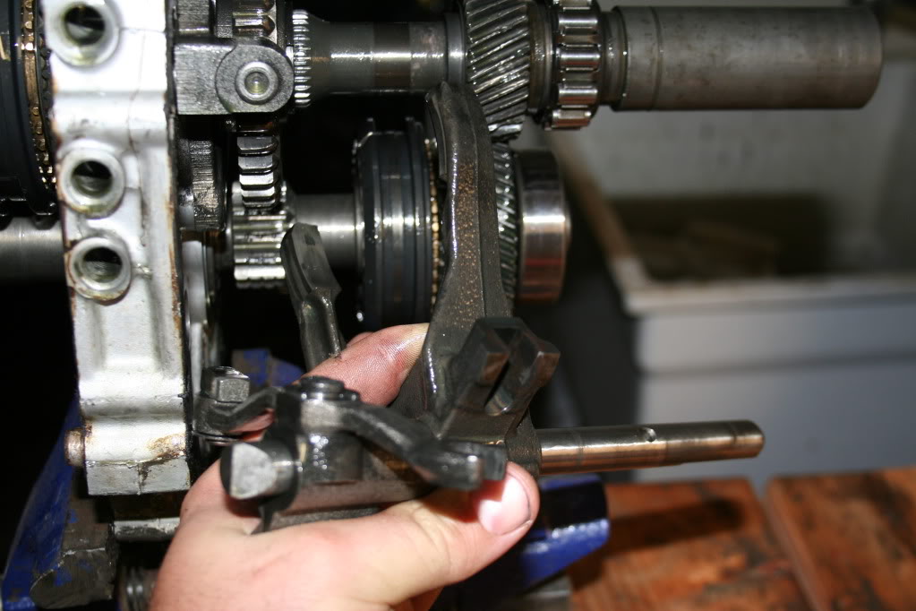

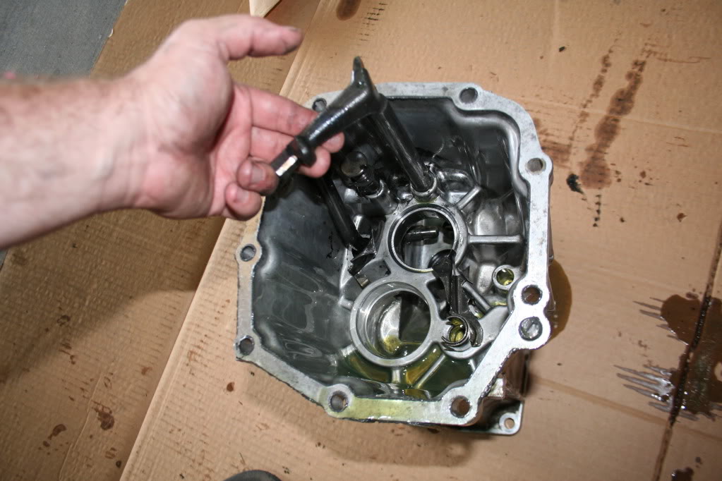

tap it apart with a rubber mallet and remove the shifter guide from the rail

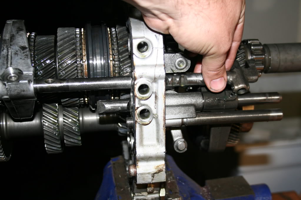

remove the shifter rail (inner view once the transmission is taken apart)

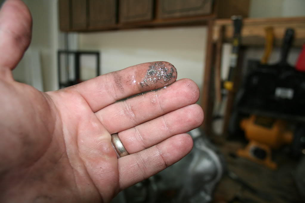

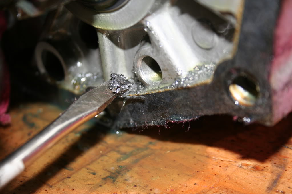

I knew this would be here... if you find this in your oil, your off to a bad start hehe

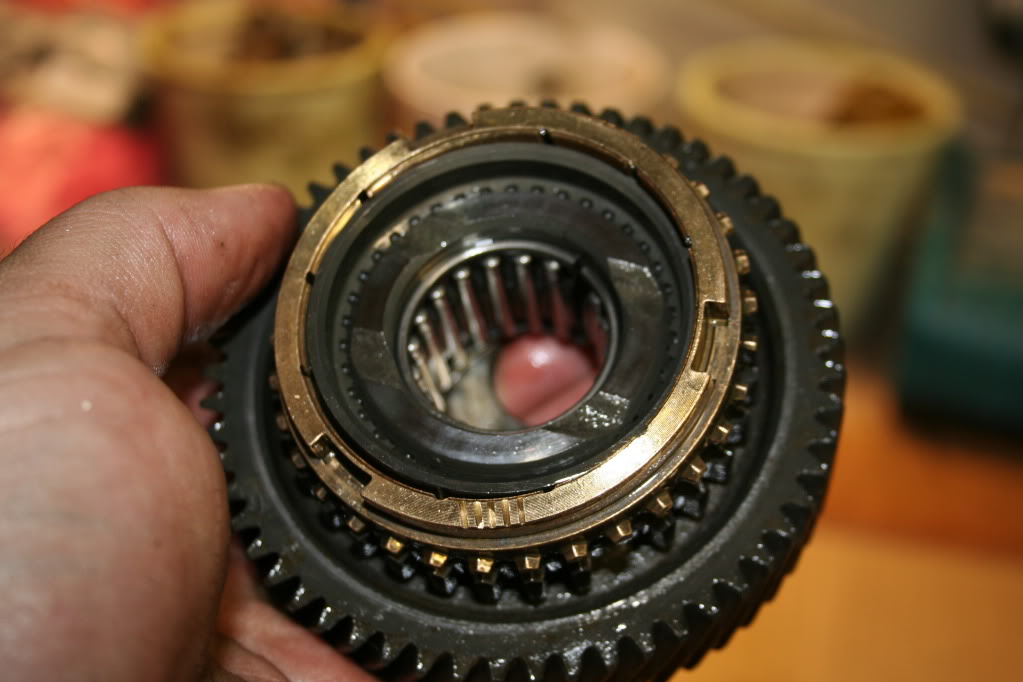

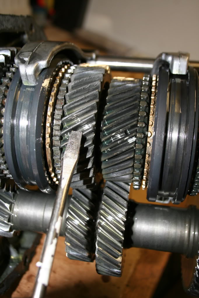

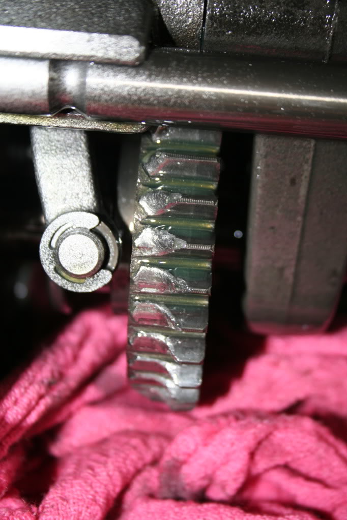

More crushed up gears
chewed up gears
This is probably my reverse... not much left of it.

The one I tore apart looked much the same. My 5th gear was like your reverse. Also the input shaft gear was missing a lot of teeth. My problems with these are always the input bearings go then the shafts start floating around destroying everything.
There must be a problem with oil getting to the input bearing. (I have gone through 3-4 in 10 years, used trans but same problem on all of them) Is the input bearing the major cause of this mess?? or was it just a broken gear that started chewing everything...??

heh, flash you got to excuse my mistake here, after spending some time with it i realize that the only way oil can swap between the transfer and tranny is if the seal is broken- i drained my transfer and there was zero metal shavings in it, thankfully.
After pulling the other side of the tranny apart it is obvious the input bearing is in great shape, but the rest of the gears are trashed. This means it was a reverse gear problem- reverse was probably broken by someone letting the clutch out halfway habitually while in reverse, breaking off teeth, and those teeth running amuck inside the oil.
So whata this means for me is.... all my gears are trashed. rebuilding this transmission would cost me over a thousand dollars in gears. the good news it......

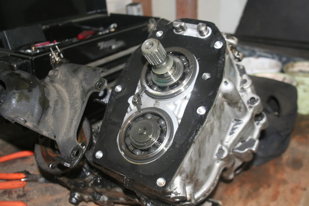

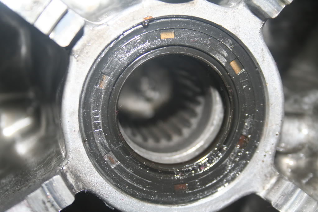

Then remove the bearing cover

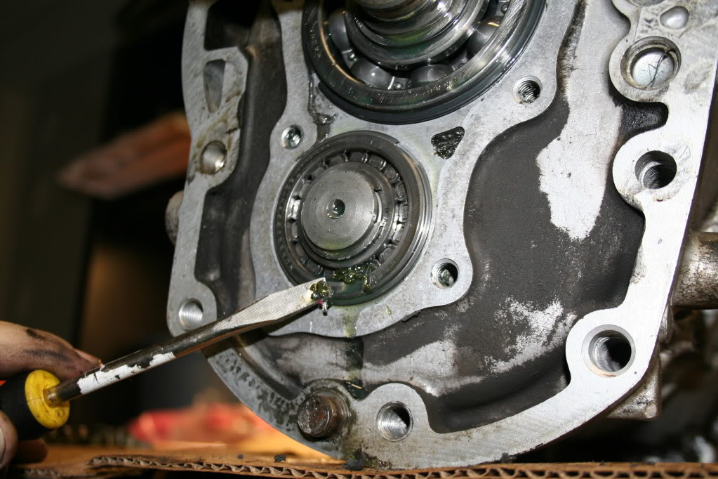

the first clues of bad news.... hey that rhymes!

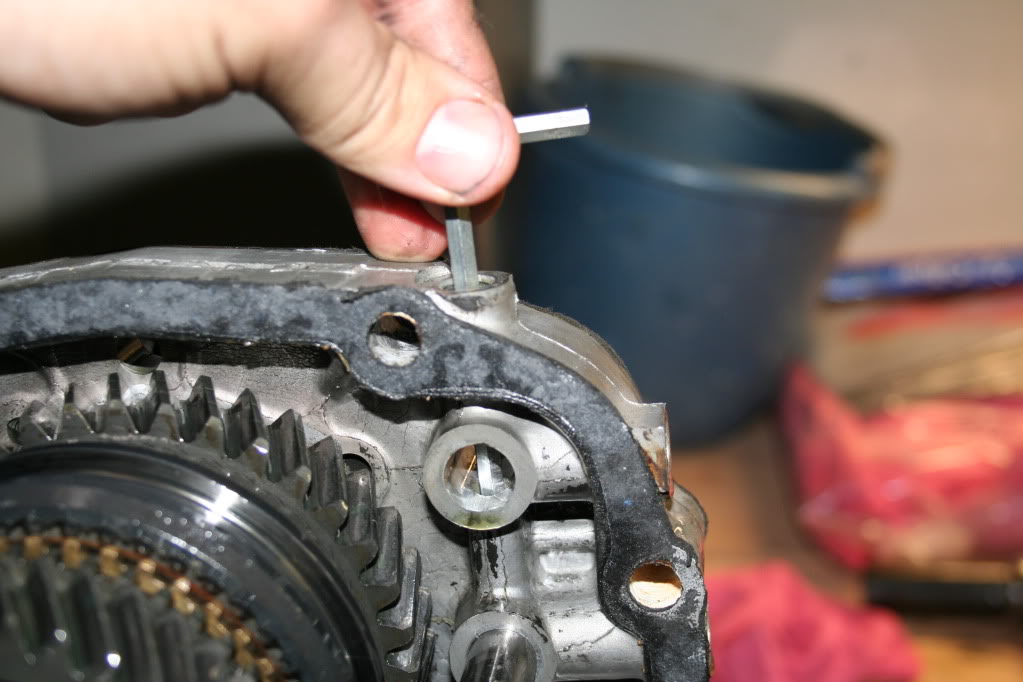

now at this point i checked the transmission for other things that might keep the cover in place... ended up removing these just in case, not sure if it was necessary but it cant hurt, really.

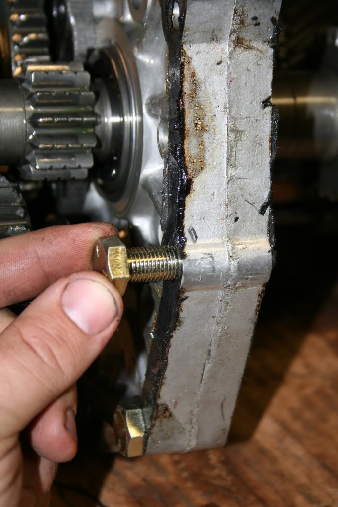

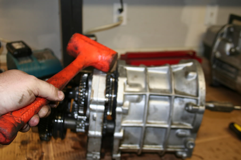

smack it with a hammer (plastic or rawhide)

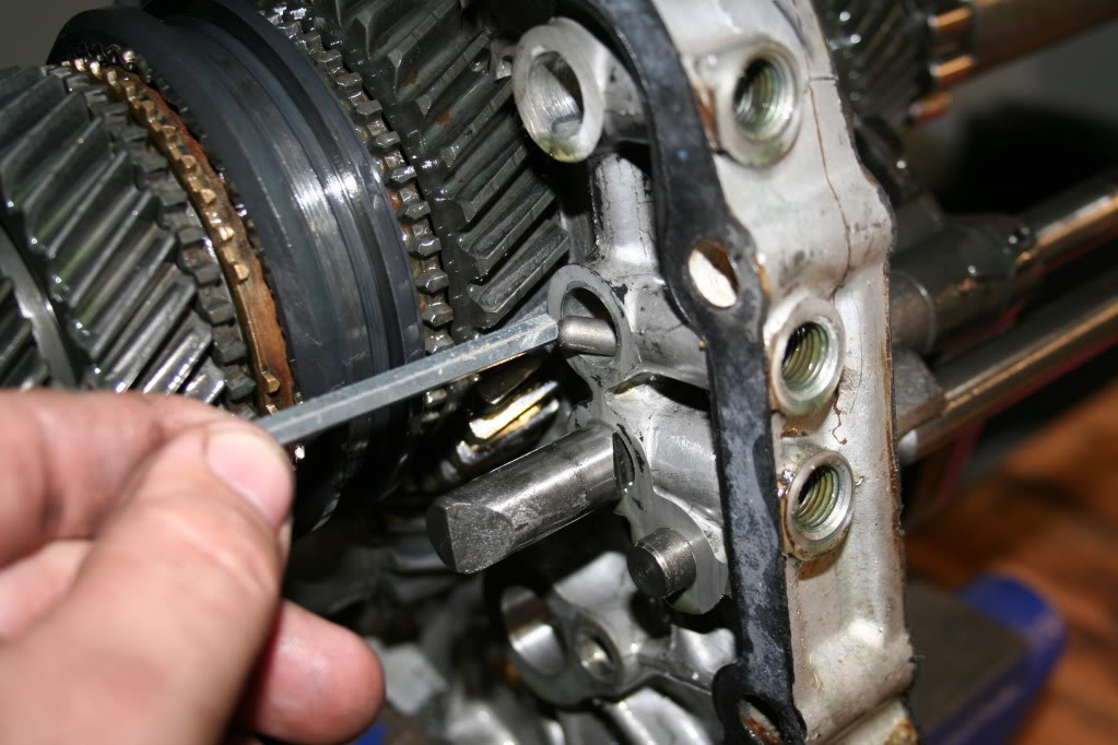

closeup- im pointing to a few grooves with the screwdriver here... these are apparenty oil grooves and not damage.

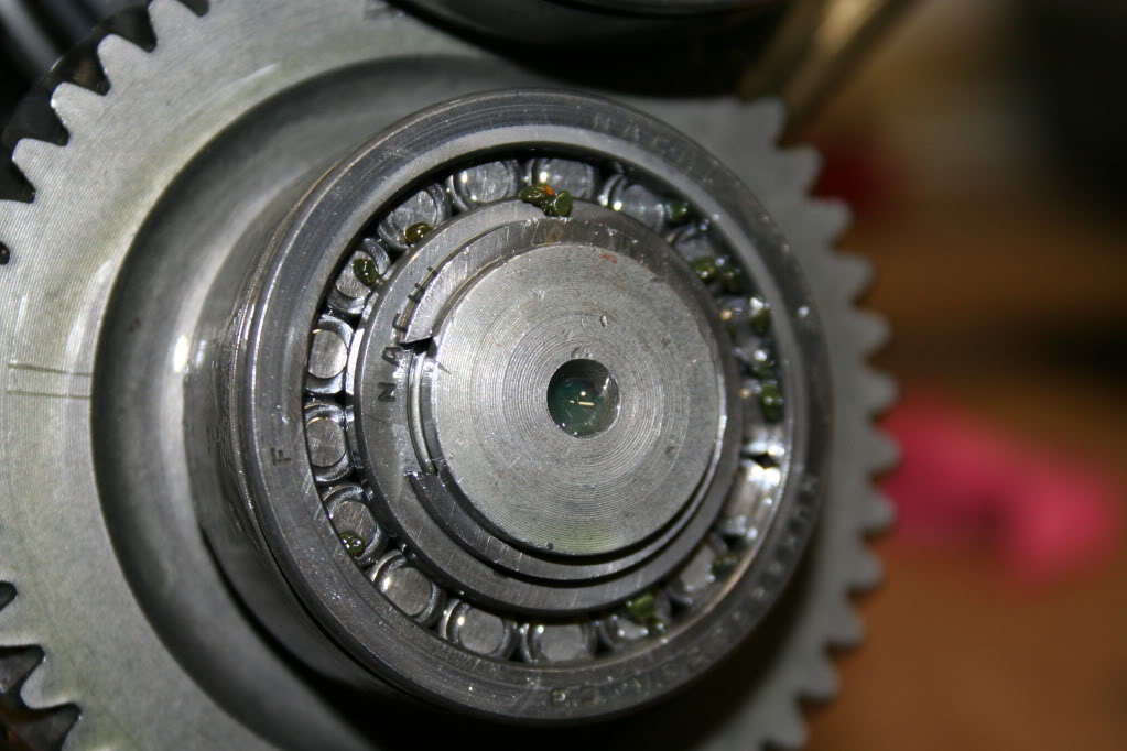

these are for flash- input bearings

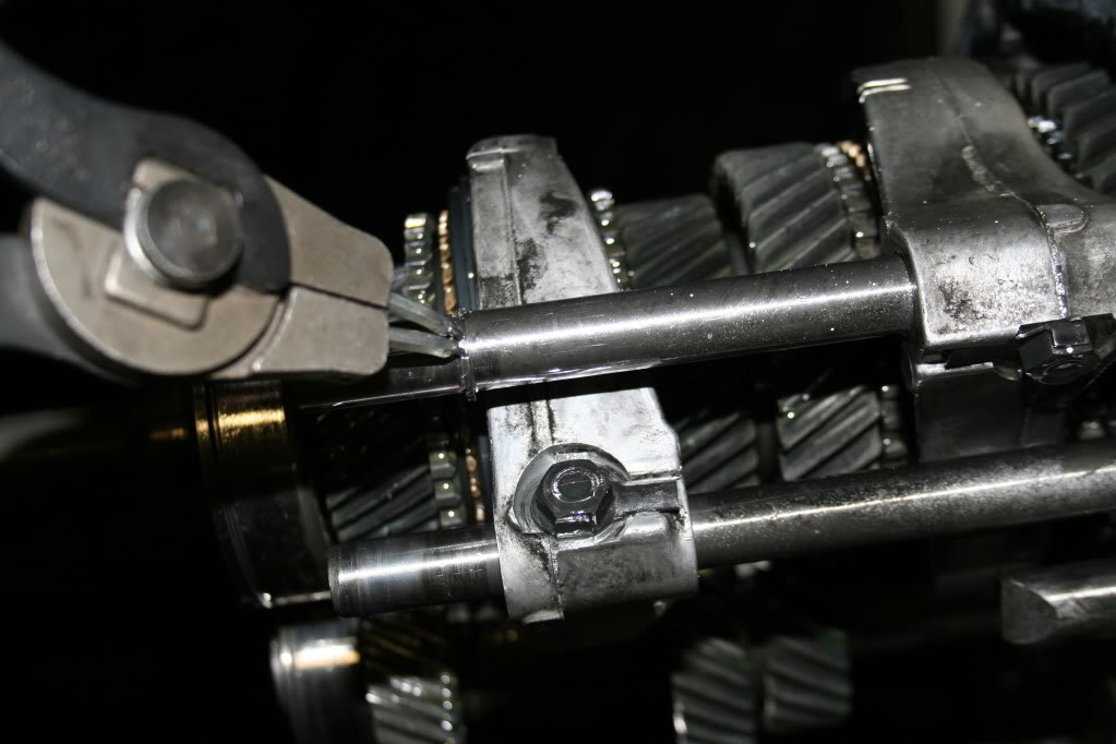

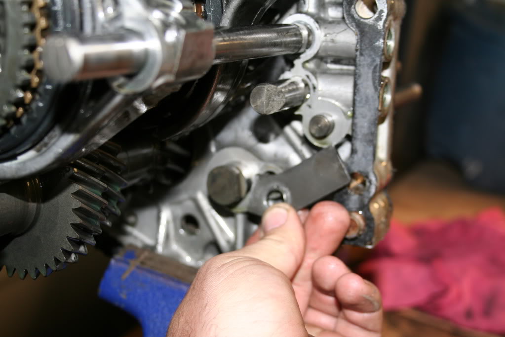

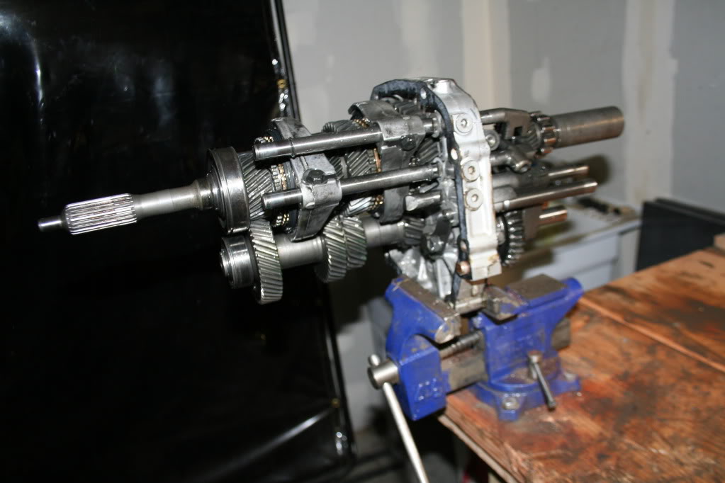

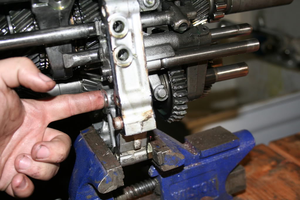

now here i am putting some bolts in the bottom two holes so i can mount it safely in my vice... the fsm recommends clutch bolts with nuts on the other side... i dont have any handy so i just dug in my junk droor for some bolts that poked thru just a smidge, should work the same.

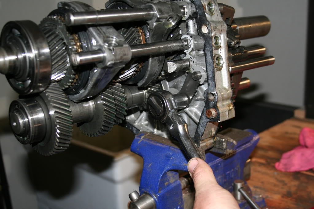

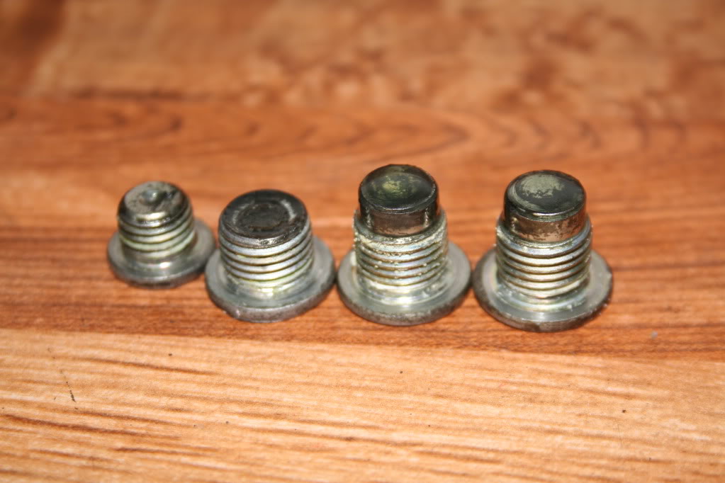

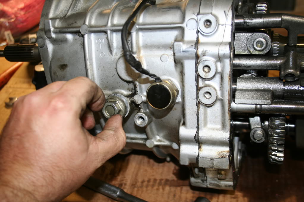

now remove the plugs with an alan key- keep them in order
dont mix them up, theyre all different...

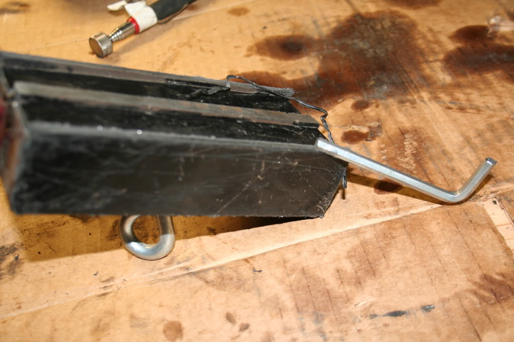

now this next part calls for a special service tool called a "magnetic finger" .... yea.... i dont got that....
so i magnitized my alan key by rubbing it on a high powered magnet i had laying in my shop
now use the alan in the three lower plug holes to remove a spring and a ball. (sorry no pic)

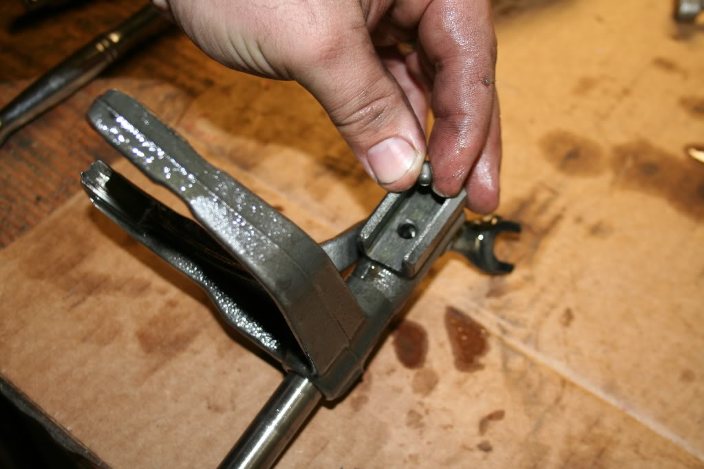

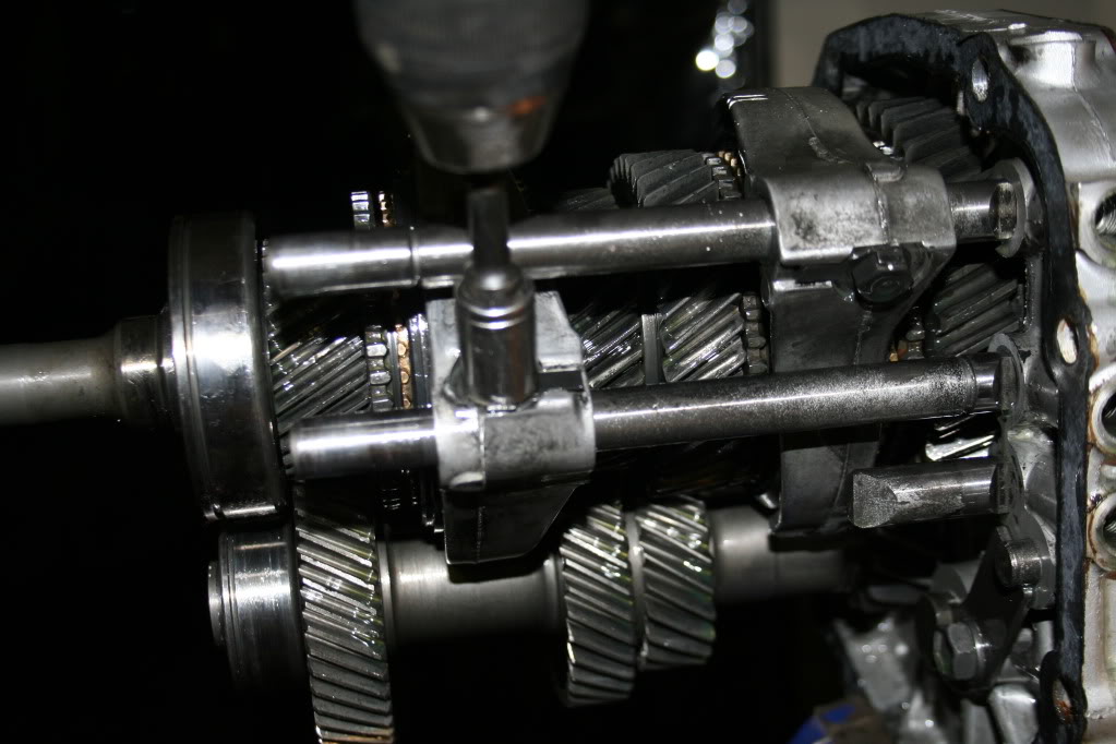

remove the reverse idler "gear shaft stopper"

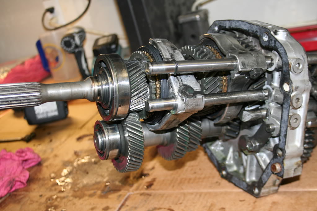

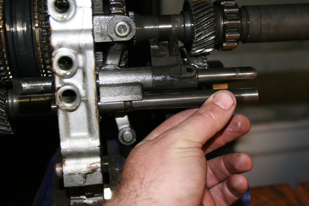

take the gear shaft out
now remove #1
Now use your new sst.. magnetic alan key to remove the key

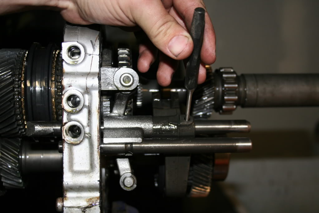

punch this retainer pin out

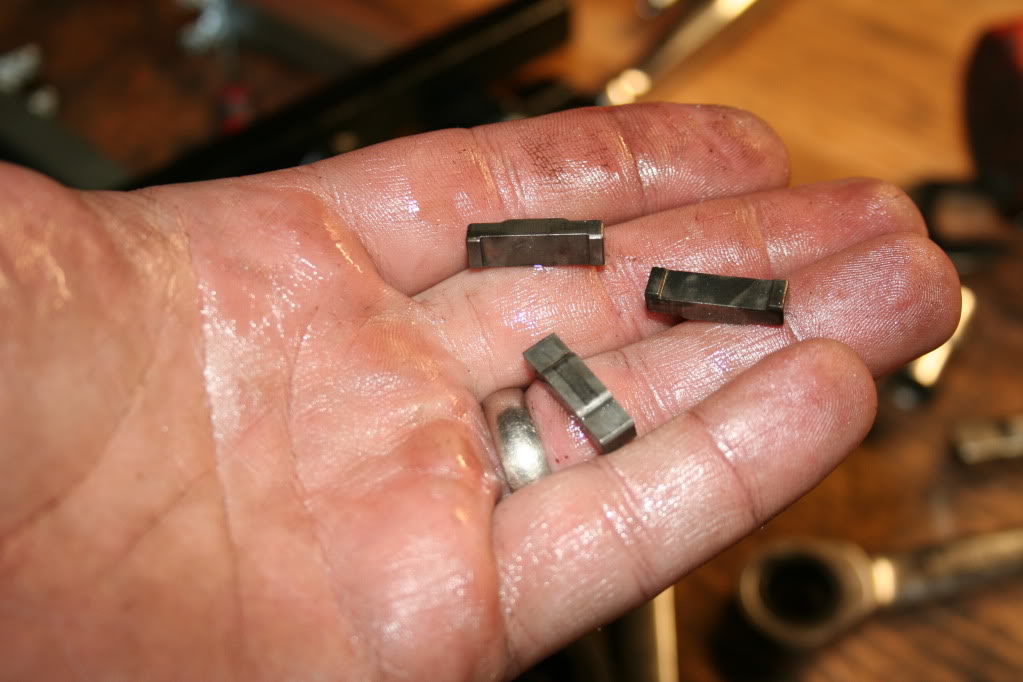

now pull all this stuff out- be careful there is anothe rlittle tiny key that will drop out... look at the pics below.
this is where it came from

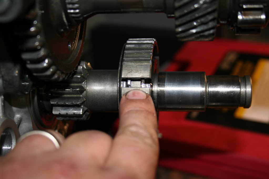

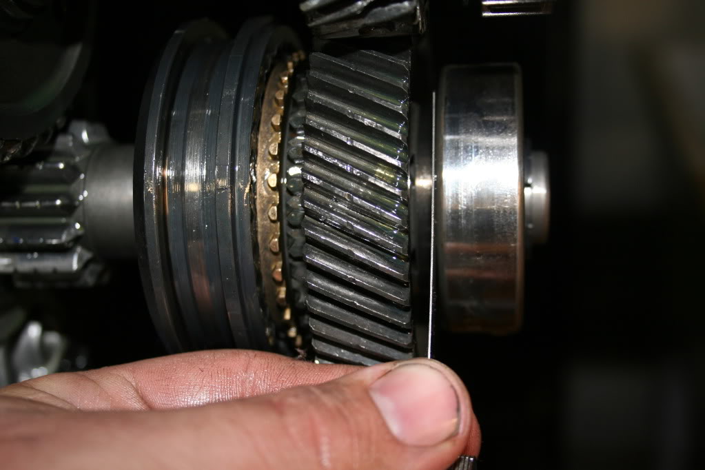

NOW the manual says to measure the gap here.. should be a max of .48, but i think im missing something here because this gap is WAY bigger than .48
am i doing that wrong? please let me know.

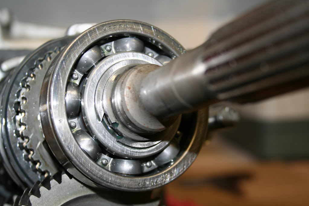

so here i remove the snap rings on the bearings

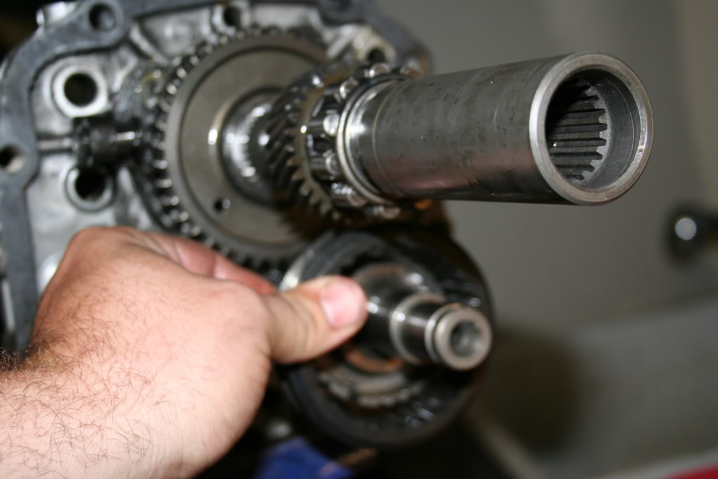

start pulling it all off
be careful here, theres some bearings (see pics below)- also dont catch your puler on the lip of the other gears

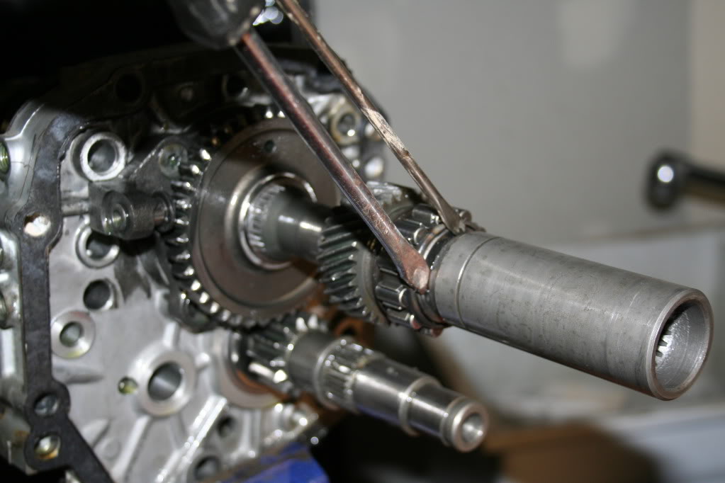

now i did this wrong and ˟˟˟˟ed it up.. dont do this like i did...
I pulled the clutch off because my puller didnt want to fit correctly over and behind it

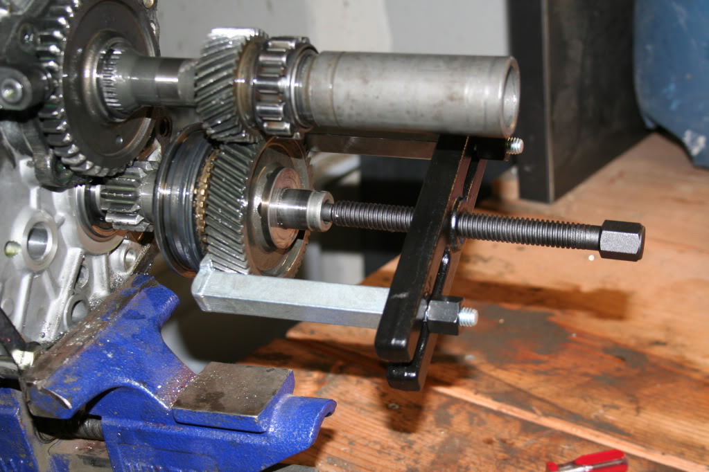

now when i put my puller on there, it fits... but in the back there is a weak metal sleeve or some ˟˟˟˟.. i squished the hell out of it and ruined it... not sure if its a replaced part from a rebuild kit or not. pulling this first clutch baffled me, anyone know the right way to do it?
remove this snap ring

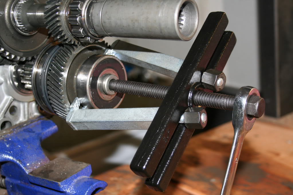

ok now i am taking a break due to lack of tools.. i need some pullers i dont have, got to find someone to borrow them from.
i am teaching myself as i go so please critique and correct me where necessary, this is a learning experience for me and hopefully many readers. lets help them get it right where i get it wrong.

I had a different '87 4Runner that I ended up turning within a couple months of ownership because I found my current 4Runner locally with some of what I wanted to do for off-road mods already done. Within this couple of months of ownership, I swapped the w56 out with another used one due to a bad 4th gear.
I don't have it apart yet, but judging from the pics above and the metal that came out of the fluid, I am thinking its a bearing:
It looks like the ball retainer above.
I'll get it apart soon and have a look. My current trans shifts like butter, but it has 180k on it. If I get this one apart and its not a huge expense to fix, then I'll swap it out when the need comes. Only stock drivetrain thing left would be the bottom end then.
To answer a previous question, a forward shift trans w56 C/D/E (89-95) can be swapped in place of a w56 A/B. There is a how to thread somewhere with pics if you want to search. You will have to trim out the floor pan forward of the gear shifter and modify the center surround shifter trim piece by moving the storage bin from forward of the shifter to behind the t-case shifter.
