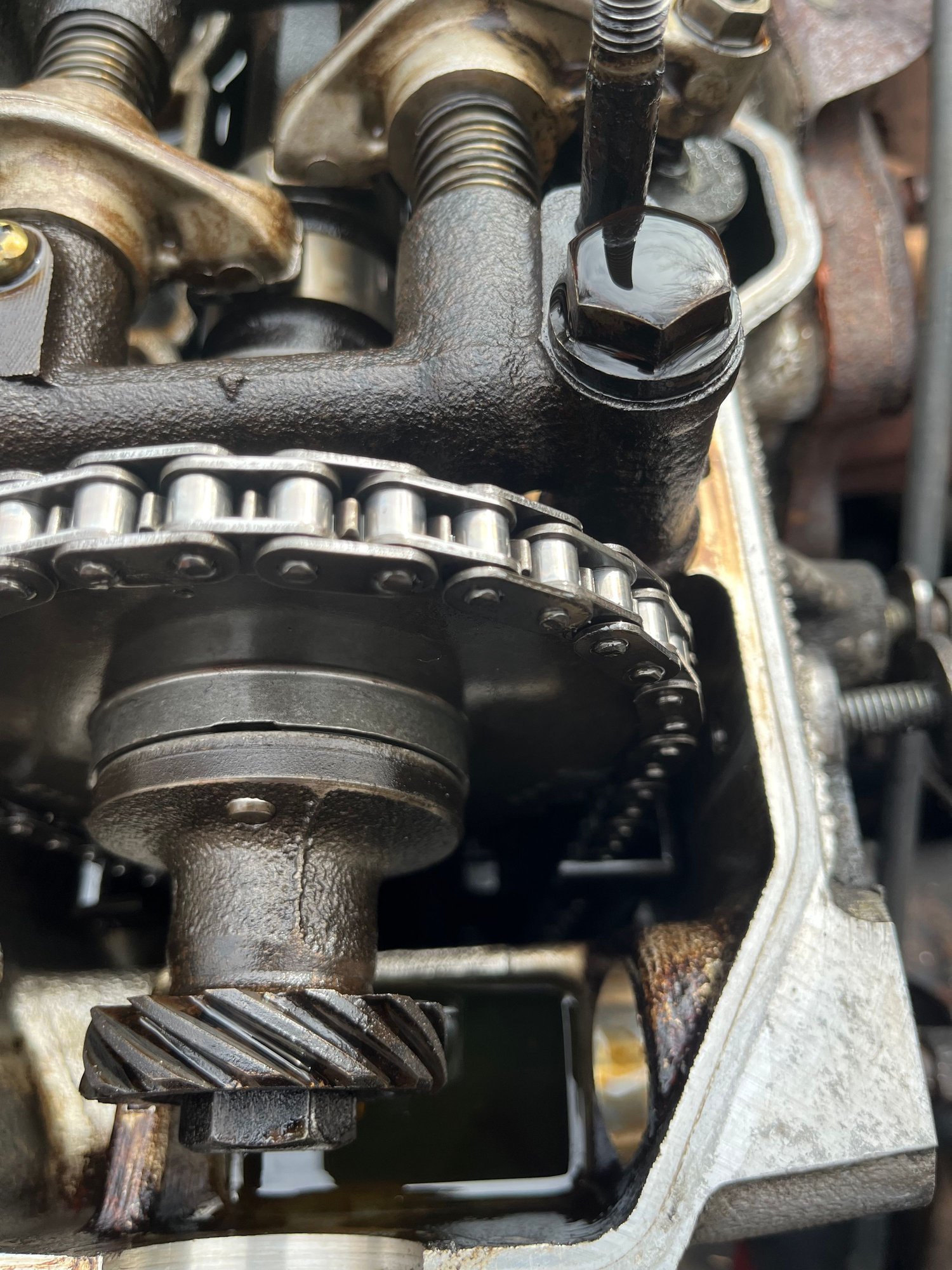

Hey guys,
brand new here. I just bought a 1990 4runner with 200K miles. Clean frame, decent interior but I bought it with the sole intention of learning to work on it. I figured given the age/mileage I would change the head gasket and timing chain not knowing if either have been done before.
I've gotten as far as having the intake manifold and valve cover off. It looks like the plastic timing chain guides are still in tact and, I may be fooling myself, but the guts look pretty clean compared to pics I've seen online. Just thought I'd share initial progress and ask if folks would gutcheck my initial perception of the motor.

This looks cleaner than a near 25 year old engine with 200K miles on it.

Stop. Look for any marking on the timing gear that could indicate it isn’t original. Might be stamped “usa” or something. Put the valve cover back on and drive it.

It is hard to tell from the pictures, but the timing chain cam sprocket doesn't appear to have holes in it like the original Toyota one.
If the sprocket doesn't have holes in it, then an aftermarket timing chain kit was installed at some point. It is a good sign to have the guides intact. Is there any timing chain wear (grooves) behind the driver's side guide?

The third pair of headbolts look strange.
Perhaps as if there are studs and nuts there. Not stock.

Ok the timing chain is def. aftermarket, but given the head gasket reference in the records I decided to proceed.
The head bolts are all normal and oem as far as I can tell. Those two middle ones had a little oil on top which made them look like nuts. With that said, the the bolt behind that one was stuck in the head so hard that it took 2.5 hours of torch, impact, breaker bar, PB blaster, (repeat ad nauseum ) to get it out. when it finally came, it was thick with gunk that made it super tough to get out of the head. With the head off I see that 3 of 4 pistons are black with carbon buildup. The head gasket wasn't in great shape but its not clear to me if it was blown or not. That said, the worst spot in the gasket is where the head bolt was stuck so badly, making me wonder whether there was coolant getting into that bolt hole and corroding things.

  • Sometimes you've just gotta follow your gut. Turns out one of the guides was cracked and would have broken off in the not too distant future.

Head Studs
Good Eye!
