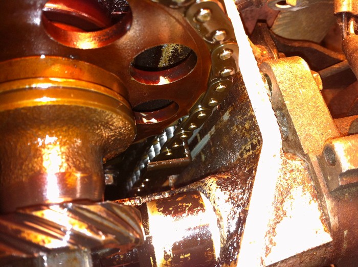

Hey all,
For the past few weeks I've noticed that my 94' 22RE was making a little bit of extra noise when started up for the first few seconds. I feared it was the timing chain on its way out.
I bought the truck at 99K and the PO said that he had just replaced the timing chain, but did it in his own shop, and had no way to prove it. The truck is at 116K now.
Anyways -- popped the valve cover off (needed an adjustment anyways) and what I found is confusing me:
Both timing chain guides are fully intact, and the chain is pretty snug. However, there are the characteristic 'tracks' in the head. What I don't understand is that the tracks are BEHIND the chain guide. How could the chain leave tracks without first breaking through the drivers side guide? The tracks aren't deep, maybe half a millimeter.
My only thought is that these tracks are from the original timing chain that may have been replaced a little late, but I figured oil would have covered the tracks up after 15K+ miles. Anyone have any thoughts?
If the chain is fine... I'm still wondering what my slightly noisy startup is... Perhaps I'll make a video and post it...

The tracks are from the first timing chain failure. Hopefully he dropped the oil pan to get all the plastic pieces out of the oil strainer.
What type of noise are you getting? Is it a rattle or something else.
If it's a rattle, your timing chain tensioner may not be getting enough oil pressure at start up to take out the slack in the chain. Once the oil pressure is up, the tensioner takes the slack out. This could be caused by plastic in the stainer, from the old timing chain, plugging things up.

The biggest thing is to make sure the guides are both there. Then check to see how much slack is in the chain. If there is a bunch of slack, then your chain is streached and it's just a matter of time before the chain starts slapping around.
Also check the water pump, make sure the shaft has no play in it. If it has some play, it's time for a overhaul - Timing chain, water pump, Head Gasket, seals,etc...

The noise is hard to describe. It's not a rattle like a marble in a tin trash can. It's just noisier for a few seconds at startup. It's most noticeable on cold starts. I'll try to take a video and post it.
If there is, by chance, plastic in the oil pan clogging things up -- am I safe to drive the truck? If I leave this AS IS for awhile, what could happen?
My oil pressure gauge has always read ZERO, but I've assumed it's just a bad sender, a bad connection, or a bad gauge, because I doubt I could have driven 17,000 miles with no oil pressure without something going wrong.

Would you describe the noise like a small flag blowing in wind?

Sounds kind of like an old Volkswagon diesel for a few seconds, less likely to do it on a warm start? I've got the same sound, it comes and goes. I've played with filters with anti-drainback valves, I've played with oil weights, it doesn't ever go away. I assume it's the timing chain tensioner, and one of these days I might do something about it...

It was not evident until I tore the timing cover off but the hydraulic tensioner (opposite the guide you show in the picture) had worn a groove through the block.
If you look at a new tensioner, the wear block should be solid. Mine wore a groove about the depth of the chain, basically to the point the tensioner's piston ran out of stroke.
My guess is for the whole 250k miles that tensioner was never changed.
