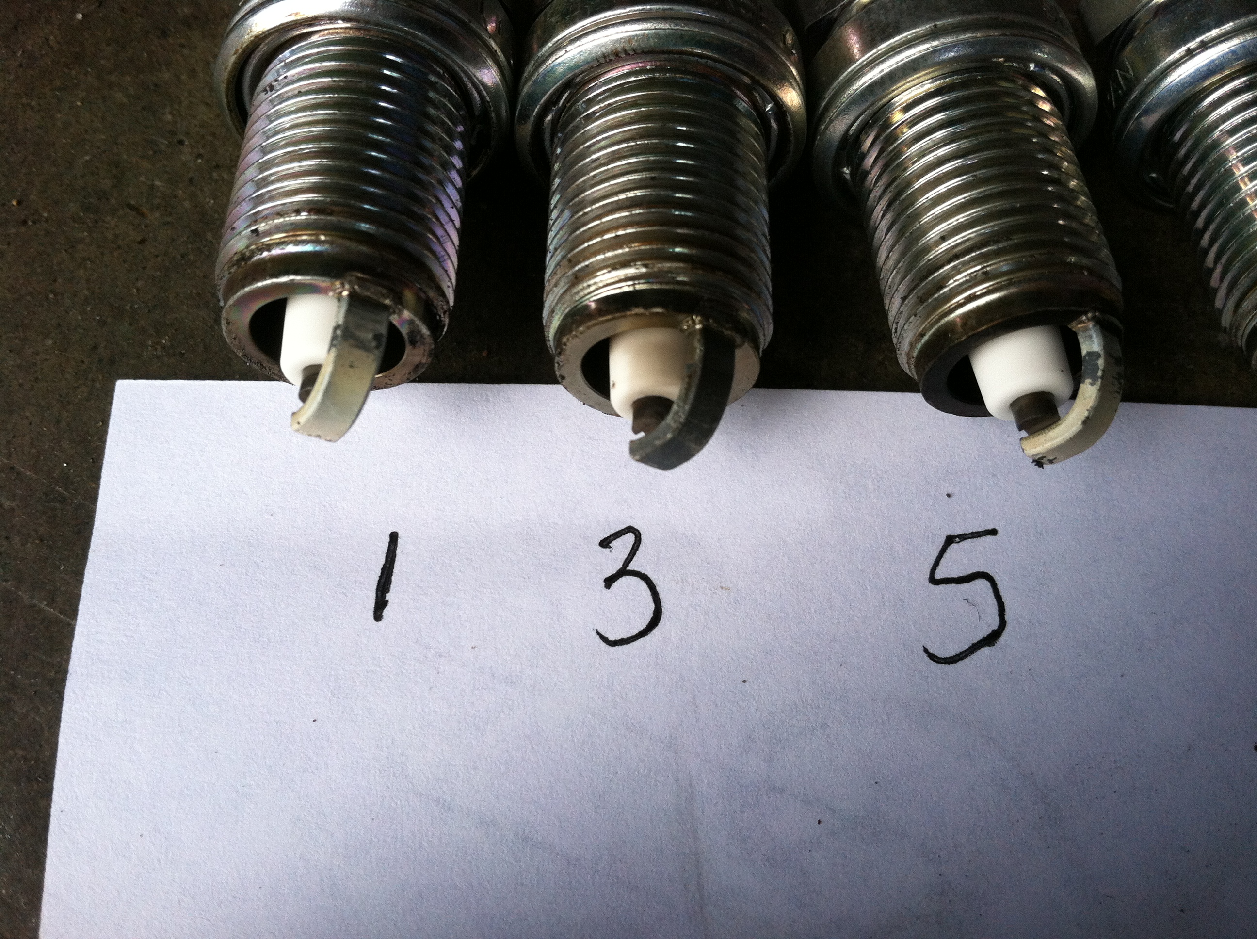

Hello everybody anyones input will be greatly appreciated. So i have a 1992 Pickup 3.0 V6. Went to the smog shop and the guy informed me that the truck was misfiring, I never noticed because i have a exhaust and never really just paid enough attention. Anyway My #3 cylinder only has 30 psi and all others are in between 175-180 psi. Anyone have this same problem and no the solution or
know the next step to find the problem?? Here is a picture of newer spark plugs (20 miles) and the cylinder number with the compression PSI.

I read on another thread to put oil in the spark plug hole and re-test the compression? Should i do this? also here is another picture
