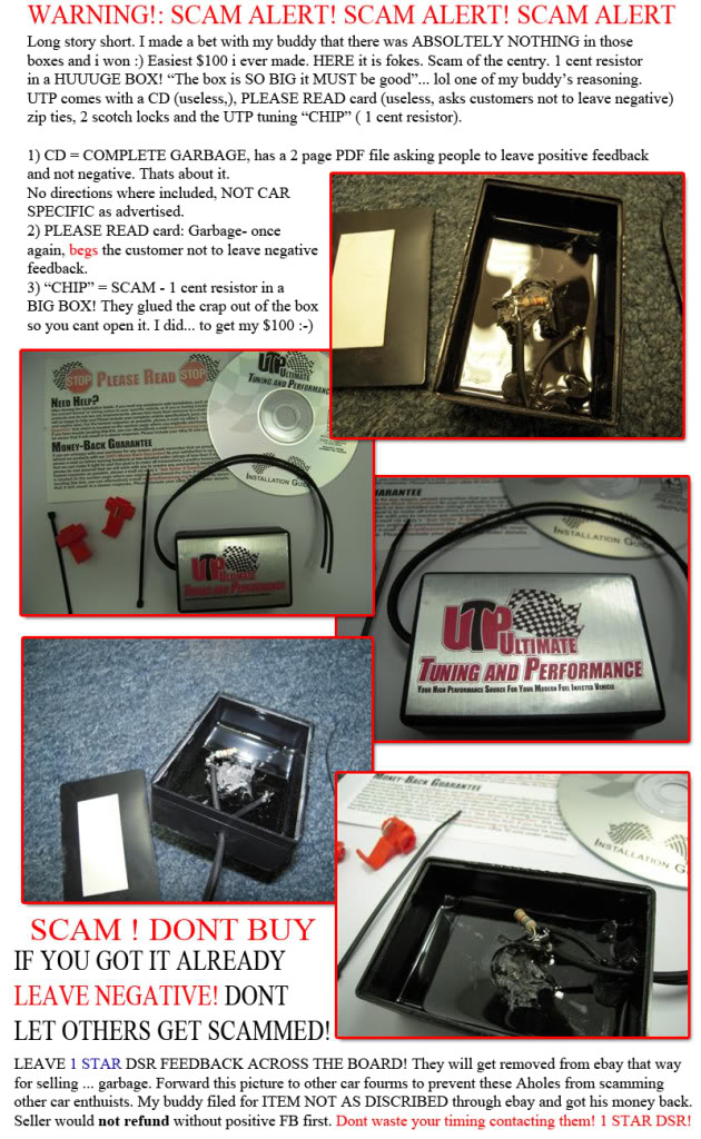

These "performance chips" that typically connect to the MAF/IAT sensors usually all work the same way, they trick the ecu into thicking the air is actually colder than it is which in turn makes the computer enrich the mixture. The theory is that more fuel = more power, which is completely false. Unless you're adding the extra air required to go with that fuel then all you are doing is making your vehicle run excessively rich, burn more fuel and probably make less power.
If the "performance chip" connects to the MAF/VAF/IAT it is a complete load of crap.

Because the EFI is a closed loop system, it will detect the rich condition via the O2 sensor and re-tune itself to adjust for the rich condition. So trying to force a mixture change by tricking the air temp probe isn't going to do much except drain your wallet.

Old Nov 29, 2011 | 11:16 AM
jermbropro's Avatar
Joined: Nov 2011
Posts: 1
its a load of crap. here is the proof
