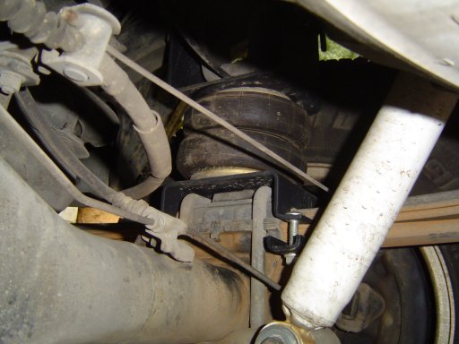

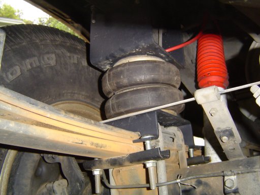

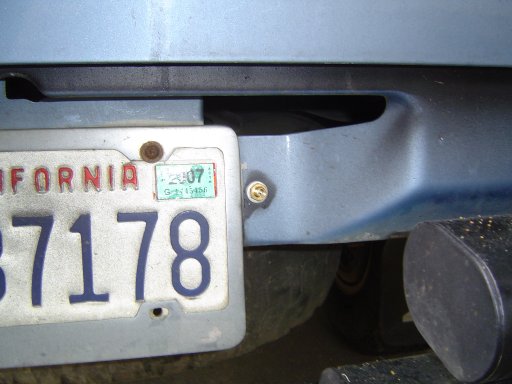

I have had them on about 3 weeks now and they rule! The whole reason I bought this truck is for surfing trips in Baja. The main problem I face when offroading in baja is that I have to take around 500-600lbs of water for my surf trips. So my truck tends to bottom out on large bumps. I put add-a-leafs on my last truck and they worked great when the truck was loaded but when I would drive the truck unloaded I thought I would slip a disk! So I wanted something adjustable. Another cool thing about them is that they support the axle against the frame and not on the leaf spring mounts so the leafs and mounts don't get overloaded. I think the only downside is that they limit suspension travel but since I don't drive very fast that is not my problem, my problem is bottoming out when overloaded. For some reason I can only add the link to the pictures. Oh well. Here are some pics of them mounted on my truck.
Here is the driver side airbag. You can see the fill tube in red coming out of the top of the airbag:
Here is the passenger side airbag:
And here is the passenger side fill valve. There is one on the driver's side of my license plate too. But I can just air them up with my portable air compressor or drive to a gas station and fill them up there.
Let me know if you want any more info on them. I think they are a great upgrade for stock suspension.
